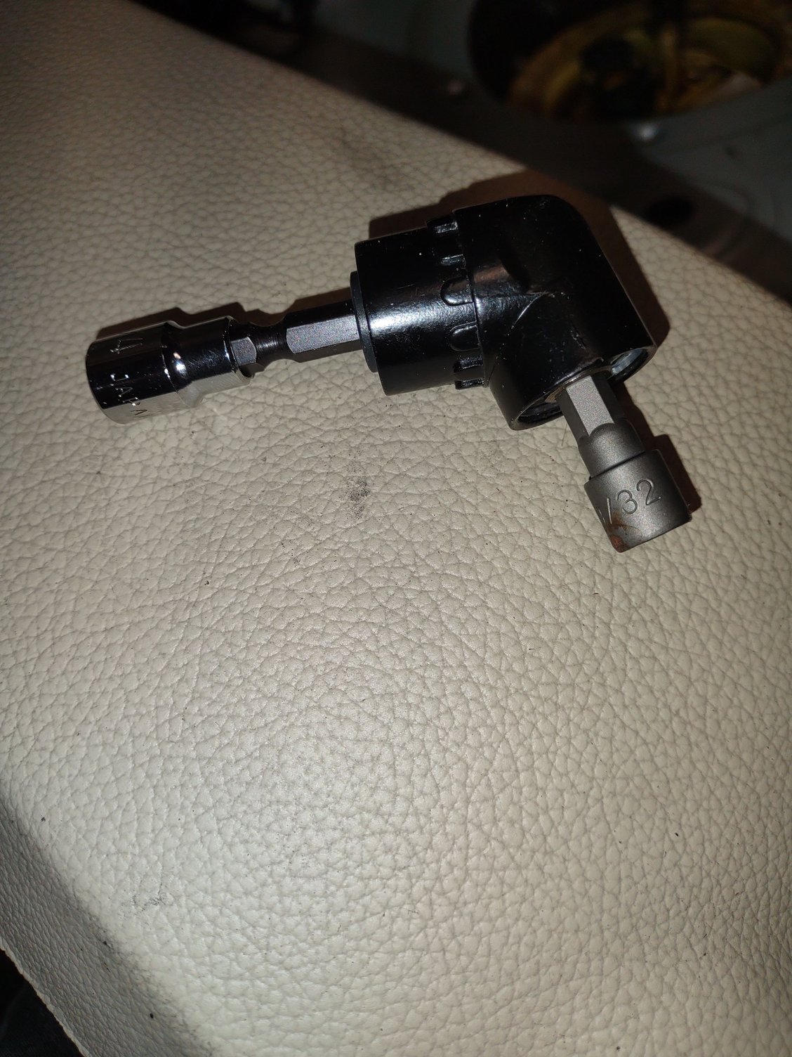

Different type of spreader to remove lockring
Tool for removing band around lock/clamp ring
Tool to spread locking clamp for reinstalling,,usual use to remove piston rings
When I bought the car owner said no leaks,ha , fuel tank has been leaking gass for years through cracks in plastic on the fuel transfer pump behind driver's seat side. . I purchased from TRQ replacement unit $120 works fine everything matches up,bought the 105 degree angle adapter in order to get to the clamp bands no other choice. Clamp rings were still flexible enough to reuse. I cut the press on fuel line on the pump as depressing the clip lock would not release.Mercedes tech in town wanted $225 to do the swap ,figured I'd have a learning experience instead. Questions email me

Tools
The labor only by local Benz doctor was going to be $225 est. The speaker and angle drive tool was about $40 so a good add to my tool box ,I will definitely running the gas as low as possible before doing this job is a really good idea. [QUOTE=BenzBopper;8571251]

$16 - Angle tool for clamp
