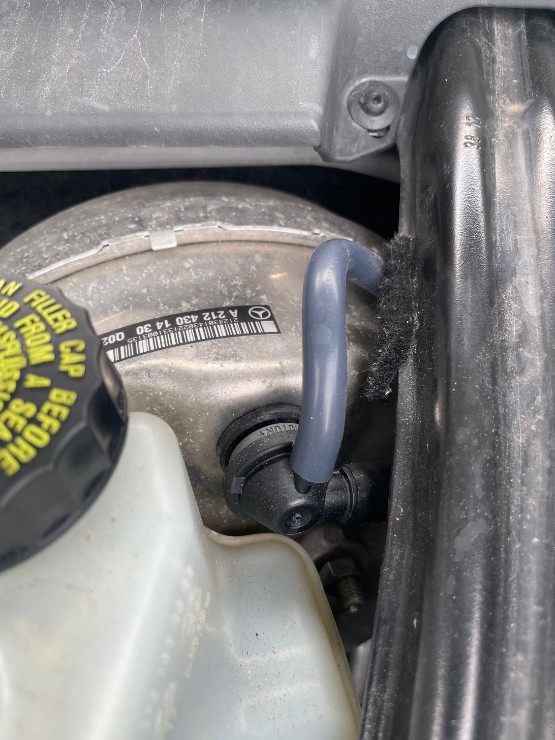

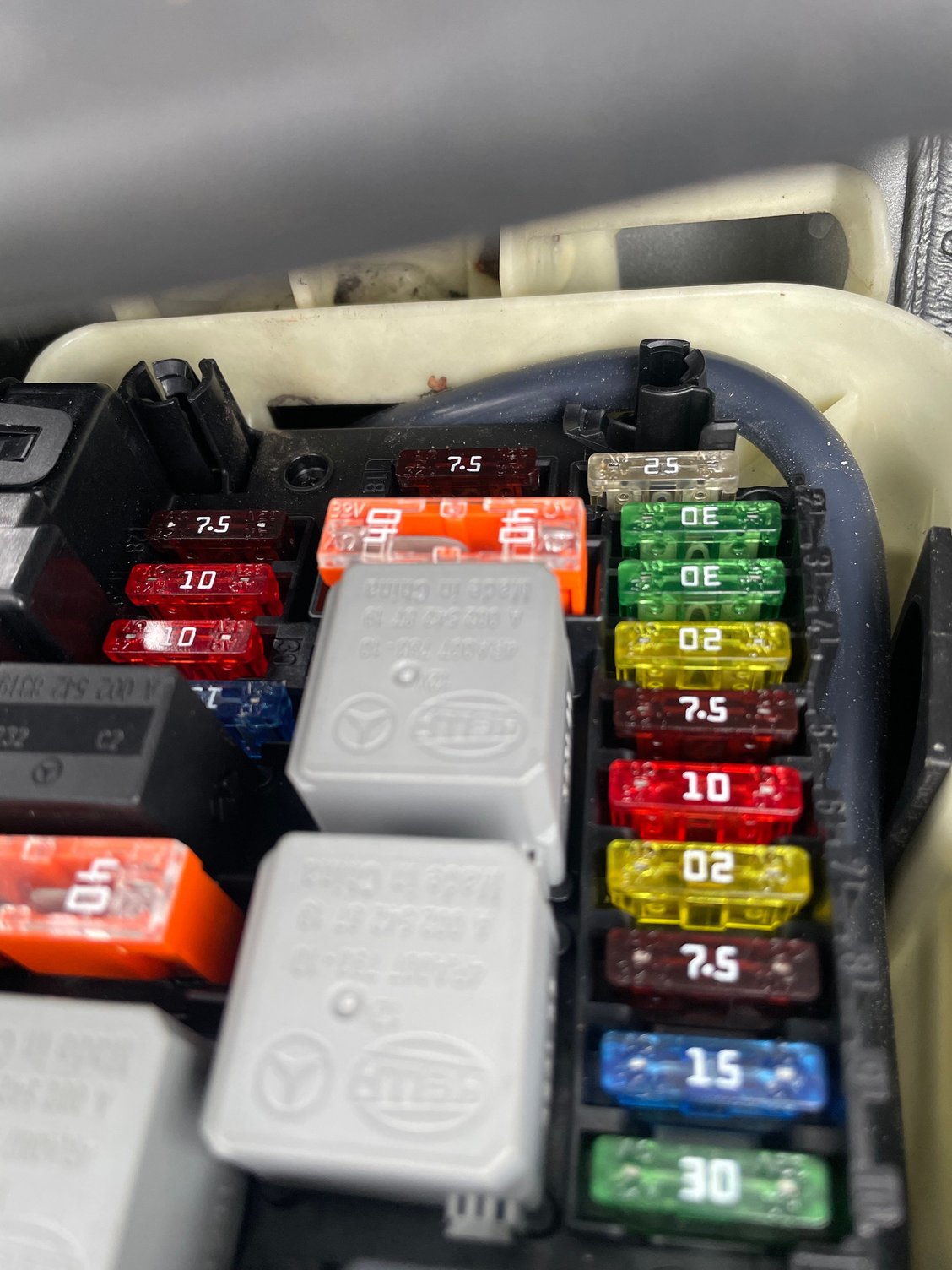

What is the info on the pipe that Jerry has asked about? I have a 14 E63 where this pipe disappears in to the engine bay fuse box. After 3 days of not using the car, I was doing some other maintenance and removed the small pipe from the brake booster. When removed I heard air moving in the pipe. I thought this was a bit strange with the car being turned off for so long.
Any ideas?

I know the black plastic pipe is from the vacuum pump. What’s the grey pipe for that goes in to the fuse box from the servo?

After a bit of investigating under the car, it turns out it's got aftermarket, valved, exhaust back boxes fitted. I wasn't told about these when I bought the car.

ok thats solved it looked suspicius grey was not factory. I wonder if that affect the vacuum pump for brakes

Yeah, mystery solved With the pipe being grey and not like any of the other pipes in the engine bay, I didn’t think it was genuine. I know what it’s for, on mine anyway, now. It might be getting disconnected and blanked, depending how loud the exhaust is.

Yesterday, while away from my PC, I composed a reply to jasegarn Post #5 on my iPhone, was getting ready to send it this AM (USA Central Time) - and I see he has found the answer.
For my Original Post: The small white tubing at the brake booster provides 'power' for the rear-passenger headrest "Fold" action. It is a vacuum actuated latch initiated from a dashboard switch. (The 'hint' for it's purpose was from a suggestion on another forum.)

Ahh, that will be why there is the tapping already in place on the brake servo connection. I have seen it blanked off on other photos instead of having the pipe on like mine.
