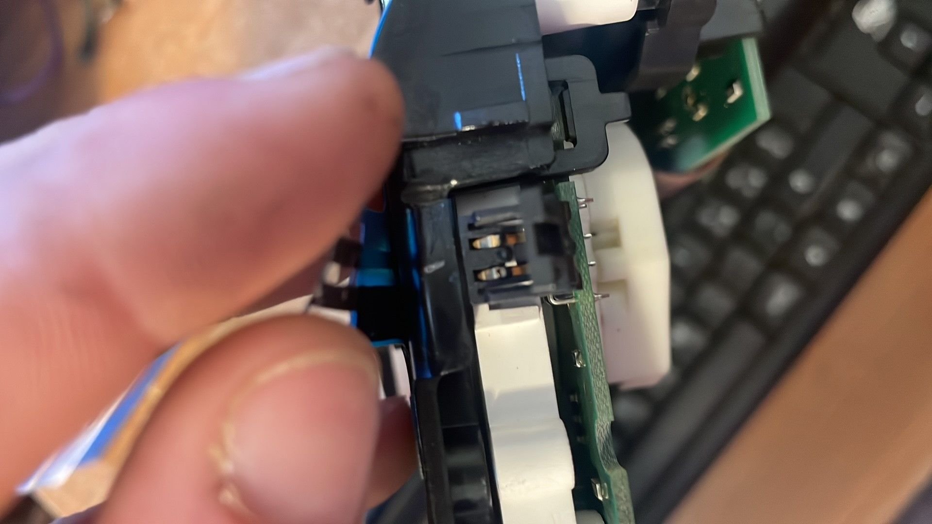

hello guys, i fixed my cluster backlight
i take it apart and found on the socket under the Mylar cable the 2 contacts were dirty. I cleaned them with some contact cleaner and i reassembled the cluster and now it works.
i read 2 post on the forum, i will link them:
Post 1
Post 2
on taht 2 link you can find some help.
Here the photo of my cluster
Mylar Cable
socket where backlight connects
see dirt, black stuff
cluster full working
