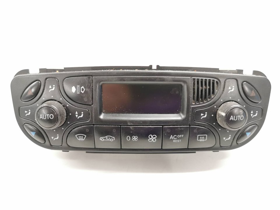

You probably can change radio with Comand 2.0 but the entire mask I think is not possible, climate control is yours is without display you cannot put a different one, you can fit the restayling one but no display, only knob.
by the air vent is a W209? To me looks like a W203.
this in photo is one of the option for climate control but im
not sure if it fits

hello, no problem in my 209, left the factory with the exact same configuration as yours with wood and radio Audio 10. i changed only the radio, AC control rest the same. but if you want you can change the interior insert with avantgrade one like This and put the Comand Radio and for AC control you have to tahe the original but i think you can change with This . But i dont know it will work, probably yes but you will missing some function.

you can upgrade the radio with the Comand 2.0 or a modern android radio. for climate control you can put the "modern " one (see photo in the previous post.

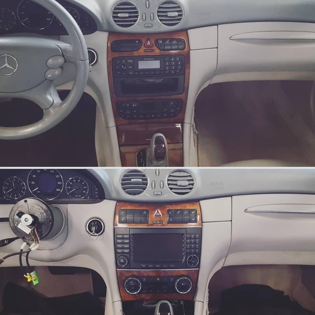

I actually did this. Took a 2004 CLK and gave it a 2005+ dash. You need the wiring harness and the bezel for the navigation unit along with GPS antenna. There are plenty of DIY on how to remove everything and it is very easy. Need to connect correctly and it will be fine. I did it in under 2 hours. Here is a pic of mine below. Hardest part was finding the darn upper dash switches to match the wood.
Really nice!!! Thanks.

thank you, I didn’t know there retrofit w209 restayling parts can mounted on w209 second gen. If you have Audio amplifier,Cd charger or Phone with Comand 2.0 or Audio 10 it will work on NTG 2?
I had HK system in my 04 and everything was plug and play. Just get the dash removal tools and be careful prying the parts out.
