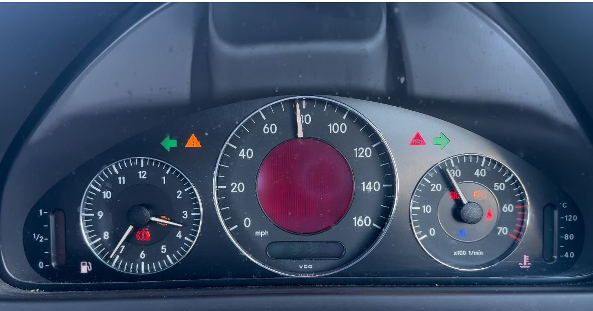

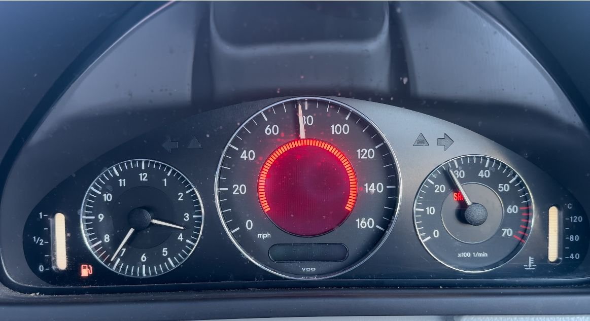

these faults keep repeating on a cycle , I’ve taken a video but can not upload as it’s more than 20mb
car was sitting on the drive for 2 months . Started up with no faults when I returned from my holiday .
following day I noticed the boot liner for spare was discoloured and boot smelt of damp , the liner was wet and mouldy. Removed it to dry and started Car and noticed the cluster had SRS warning light , rest of cluster was dead , just the cruise control indicator was on between 20 and 60 mph. But as the days have gone by the cluster has got progressively worse with faults .
the picture attached is most recent.
should also mention there was some water moisture on the SAM in the boot .
so could be possible SAM faulty ?
Any help would be appreciated thanks

You need to scan your car to understand what active faults are messed up.
Rear-SAM likely needs replacement due to soaking
