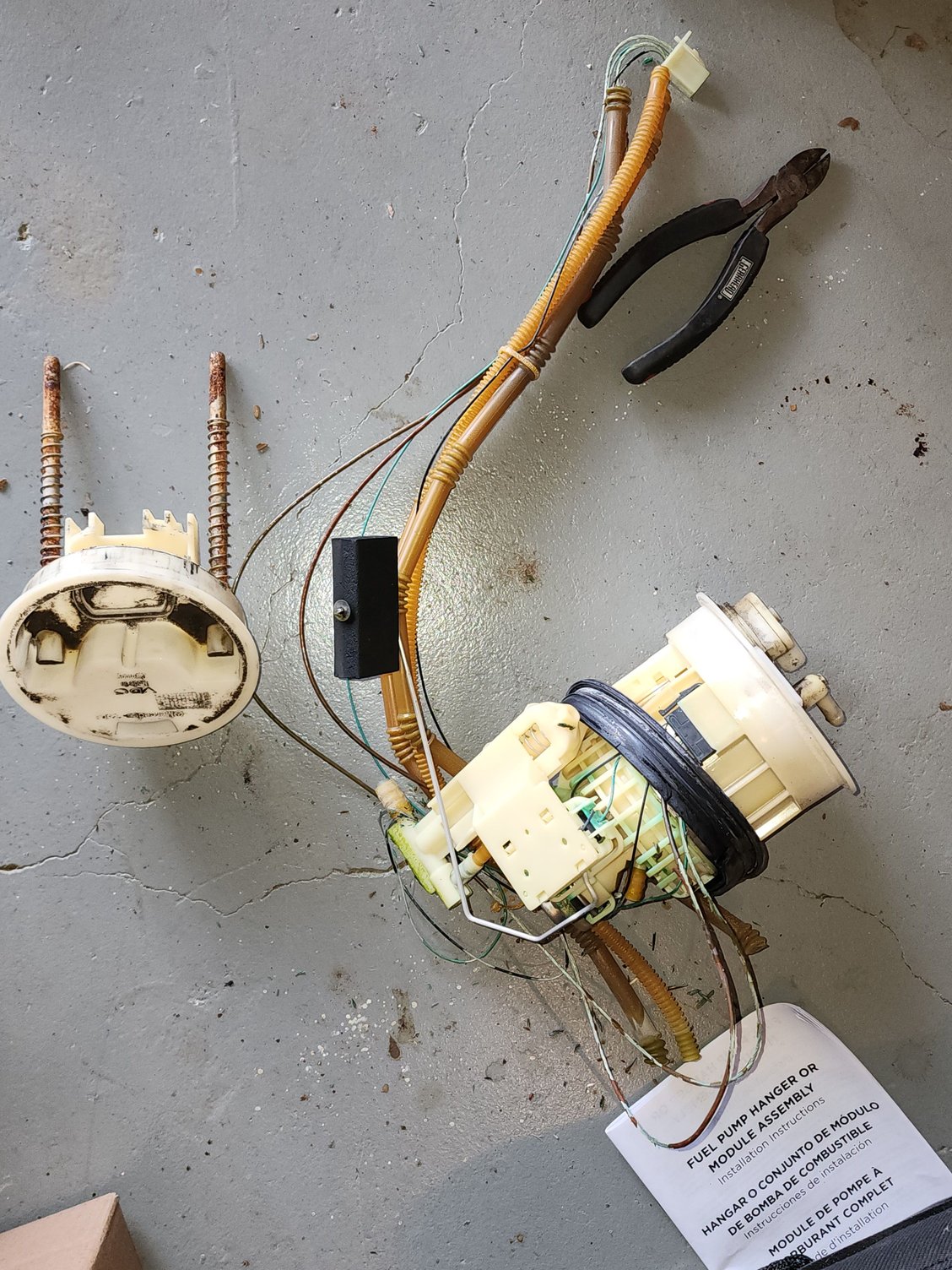

Car was my mom's, she bought it new in '04. Has 77k miles, and ran great until it was parked over a year ago due to tags. I replaced the battery, fuel pump, sender, fuel pump relay, and checked all fuses. I also thoroughly cleaned out the tank and put in 5 gal of fresh 93 octane. Cranks but doesn't get fuel. I'm out of funds to keep throwing parts at it, and out of 7 euro car shops I called here in San Antonio, only 1 would even look at it for a min $300 diag fee. Car also needs 1 tire, plus would need a tow there which is too much for us right now (been out of work sick for a few months, finally about to go back to the office). I remember my mother buying this car at MB of San Antonio new for around $60k, it would kill me to have to sell it for <$1500 not running. So I wanted to see if any experts have any ideas on what I could do next?
Exterior is in pretty good shape, 7/10
Plastic hoses in tank were toast

OK, update: fuel pump is actually priming after all, still not getting a reading on fuel level. Next steps I think are to replace the fuel filter then check fuel pressure at the fuel rail? If it won't run but just cranks, would it still give me a code if the crank / cam sensors are bad? And is it dumb to ask if unplugging the battery for a while could make any difference? (Resetting the computer or something?)
