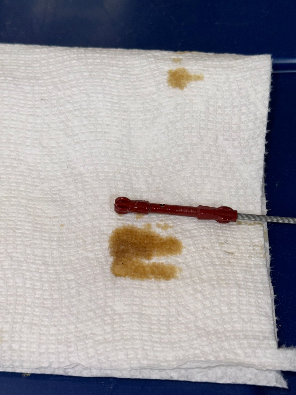

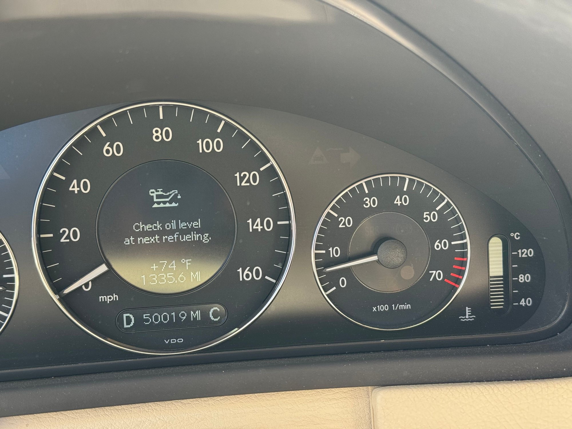

Had this same warning on my cluster and same dipstick reading about a month ago so put half a liter of oil in.
Fast forward to this month and I got the message yet again today. Anyone else have an issue like this? I let the car sit 10-15mins before pulling dipstick reads and it shows up a lil over half which is supposed to be technically good. Should I pour another half liter in? It seemed to fix the warning but I’m wondering if this is even an issue to begin with since its dipstick reading is technically fine?
Also I don’t seem to have any leaks from what I can tell, my garage has not had a spot and purchased the car from my local Mercedes dealership exactly 2 months ago and they gave it the whole maintenance before I purchased it. Since then I’ve put about 2500 miles on it. Seems to be going through half a liter of oil every ~1k miles from what I can tell.
Any advice or experience with the situation would be helpful. Thanks in advance. I’m new to Mercedes ownership and I absolutely love the car to death.

Check if there are any leaks around the engine area like on the exhaust manifolds from maybe the valve cover gaskets or something. I had that once, but was a very small leak. The difference between min and max is about 1 quart so would probably just put the other half in for good measure.
