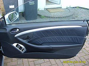

Apr 30, 2007 | 05:29 AM
This is the picture of my door.
Reply 0
Apr 30, 2007 | 11:52 AM
i must be slow or that door is for right side drive....
Reply 0
May 1, 2007 | 07:52 AM
Your not slow, yes its a right hand drive car because i am from England i have asked a couple of mercedes dealers how to take the door panels off but they want to do it and charge me £500.00 so thats why i am asking you guys, as i am changing the crappy old silver interior trim with a new sporty trim so come on someone must be able to help me:
