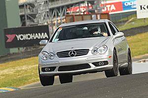

So I took the 03 CLK 55 out to Sears Point (aka Sonoma or Infineon) for a track day last week. The car was awesome, and I had a blast. My only complaint is the traction control was very intrusive on the high speed turns. I was afraid to turn it off because there is a lot of trouble at Sonoma, and a rare 911 GT3 RS hit the wall and had a lot of damage.
Does anyone know of a way to put the car in track mode, or something similar, or is the system either on all the way or off all the way?
-Mark
