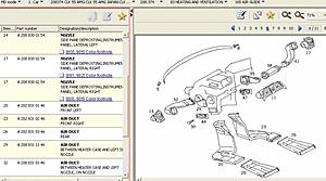

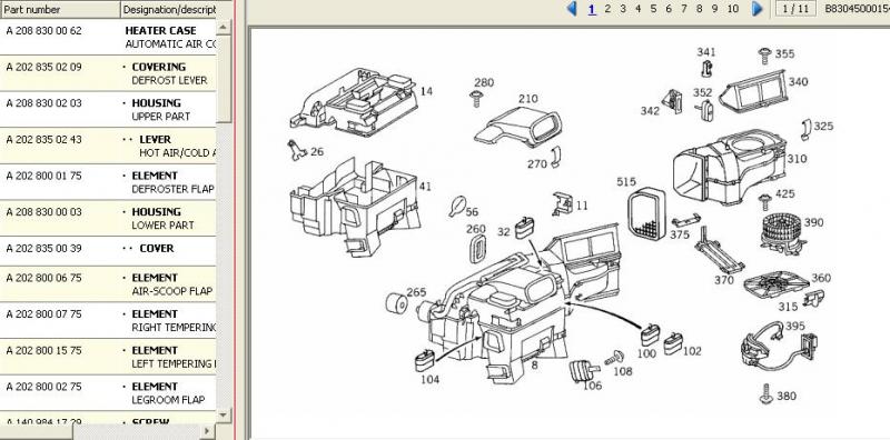

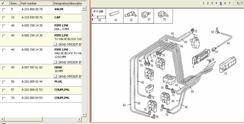

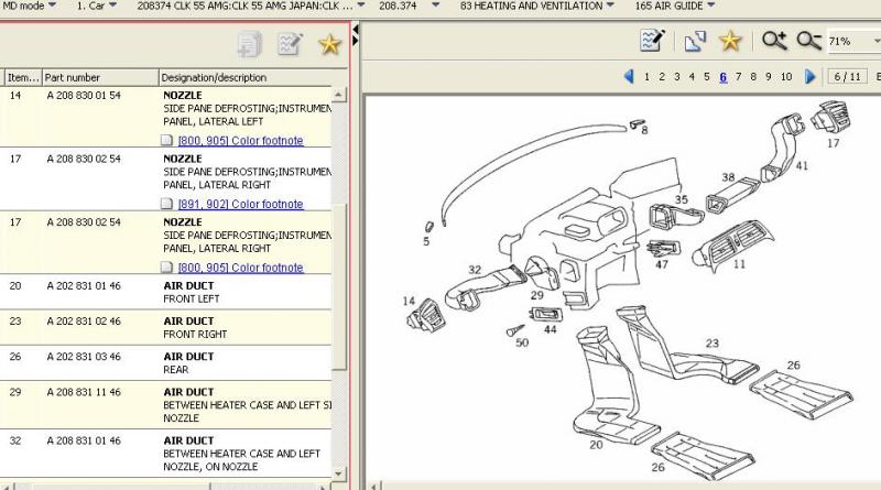

A couple of pics from EPC.
Attached Thumbnails My dashboard is whining....-airguide208.jpg   My dashboard is whining....-heatblower208.jpg   My dashboard is whining....-vacuumac208.jpg
