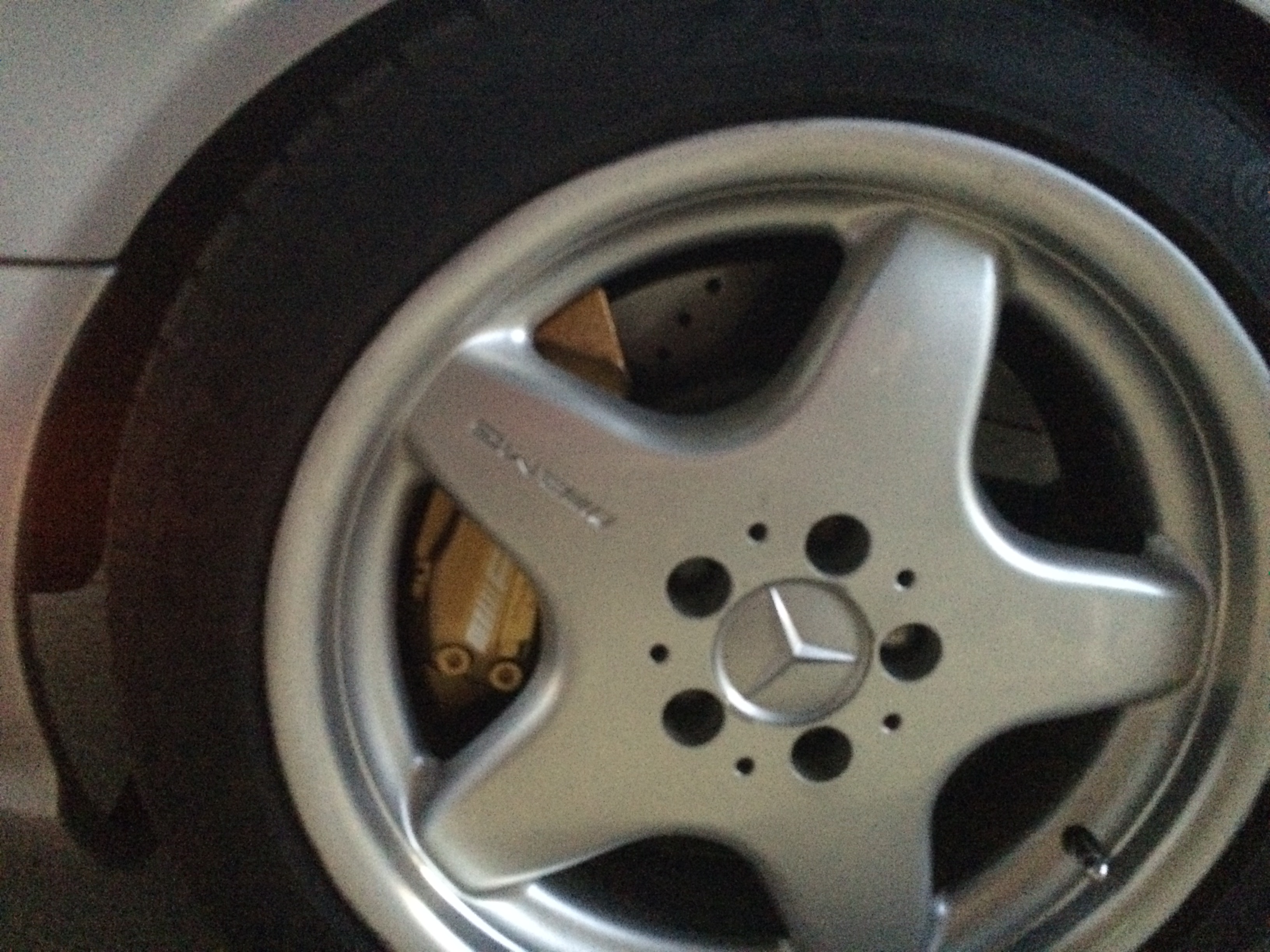

CLK Cabrio
Im running the CLK430 17's (track rims) and have the c32/c55/clk550 (all use the same caliper) calipers and rotors. Mine are specifically from a c55. with that said I only have a few mm of clearance on the spokes. I am running a square setup with 8 1/2 all around.
Attached Thumbnails clk 430 AMG brake upgrade?-img_2114.jpg   clk 430 AMG brake upgrade?-img_8428.jpeg
Old Aug 26, 2015 | 02:37 PM
cm60k's Avatar
Joined: Aug 2006
Posts: 7,053
Likes: 398
From: A.D., U.A.E
Excellent, you make it sooooo easy..
