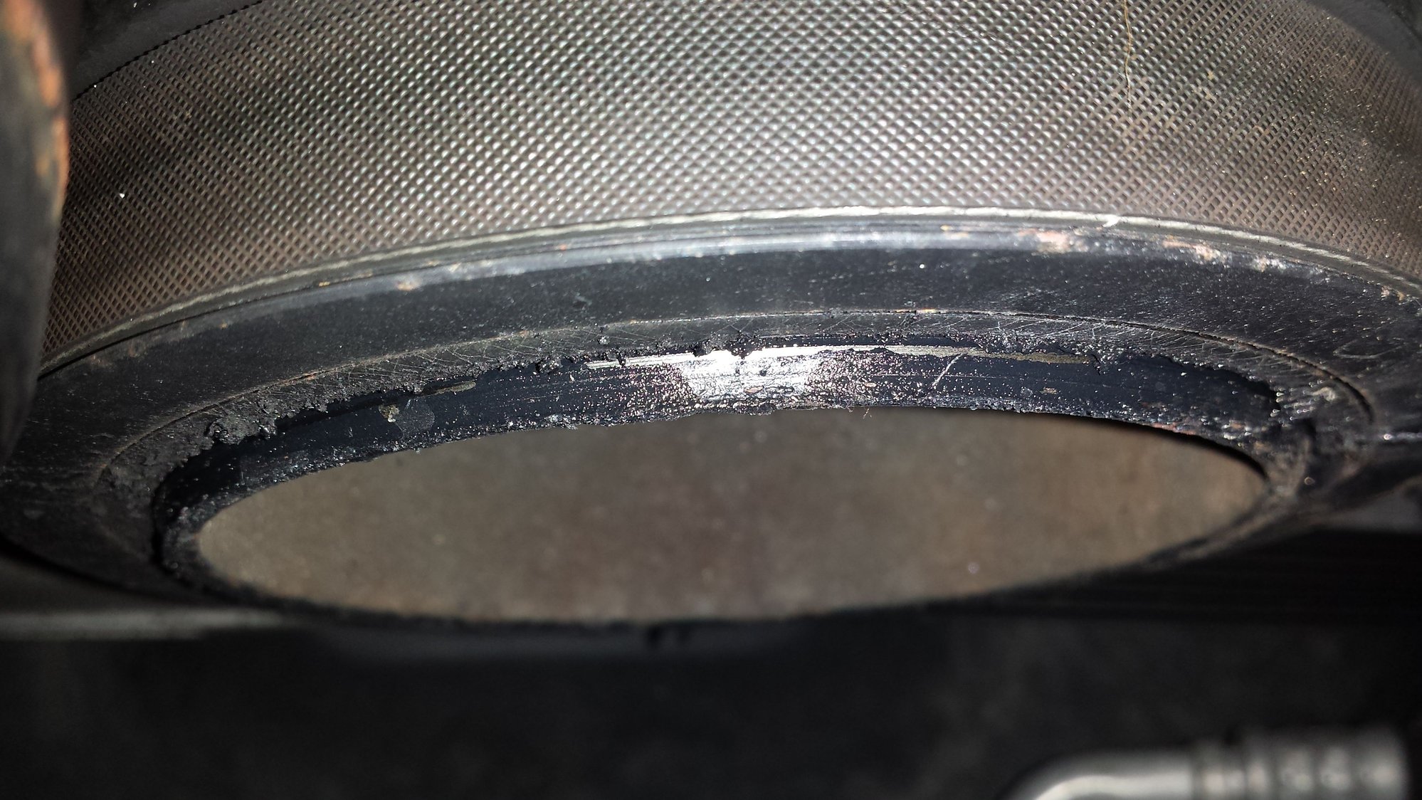

Just looked at my HB looks like the rubber is shot and its starting to move back towards the engine, only 78k on the odometer.

I suppose this can happen to any car, I have seen it on many US engines but not Imports too much.
Oil eats rubber, Petroleum spray lubes eat rubber it is natural.
I do not see oil on that harmonic balancer but something might have wedged into the balancer like a piece of belt or road debris.
If you were roosting your tires in the neighbors front yard and the AC or ALT locked solid this might happen.
Some require a special tool for removal pending the clearance of fitment. Some simply slide off. Might be the case with Benz.
Some Chrysler products even require an installer tool (older V8).
If you have never changed one it is best to be prepared with at least the puller, inspect the timing cover and oil seal for damage once removed.

There was a recall on the HB for prior years up to 2001.
Just ordered new pulley, and bolt from parts.com $370
Mercedes Benz M112 M113 M137 Crankshaft Harmonic Balancer Puller Holder tool ebay $53

Thanks for the utube link, I caught this just in time, the HB started digging into the oil pan.

I should mention that the engine was making a slight knocking sound that would come and go, I suspected the lifters at first but the knock was coming from the lower front part of the engine, thats when I saw the HB pulley sliding back off the rubber. I used the HB holding tool and a 1" breaker bar to get the old one off still waiting to receive the new HB. So far the hardest part of the job is removing the radiator support to get the cooling fan out of the way.

The new HB arrived today, tried to install it but the holding tool does not fit inside the pulley, the new pulley has a smaller inside diameter than the original one. I started grinding the outside edge of the holding tool to see if I can get it to fit inside the pulley, looks like a lot of grinding. This makes an easy job a big pain.

Got the pulley holding tool to fit after taking off about 1/8 inch with the angle grinder, HB is back on but did manage to snap the nipple off of the expansion tank so I replaced that as well.
Car is back on the road so far so good.
