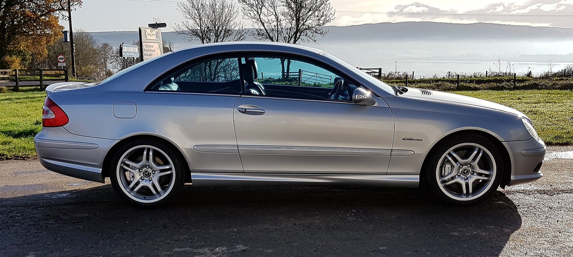

Hi everyone - I've just purchased a 2003 CLK 55 with 80k on the clock. I only paid £4000 for it, which, was cheap, BUT, the car needs some TLC.
In short, the car was in very good condition (bodywork wise) but, there were a few mechanical gremlins which came to haunt me a day after I brought it.
Here is a shot of it >
