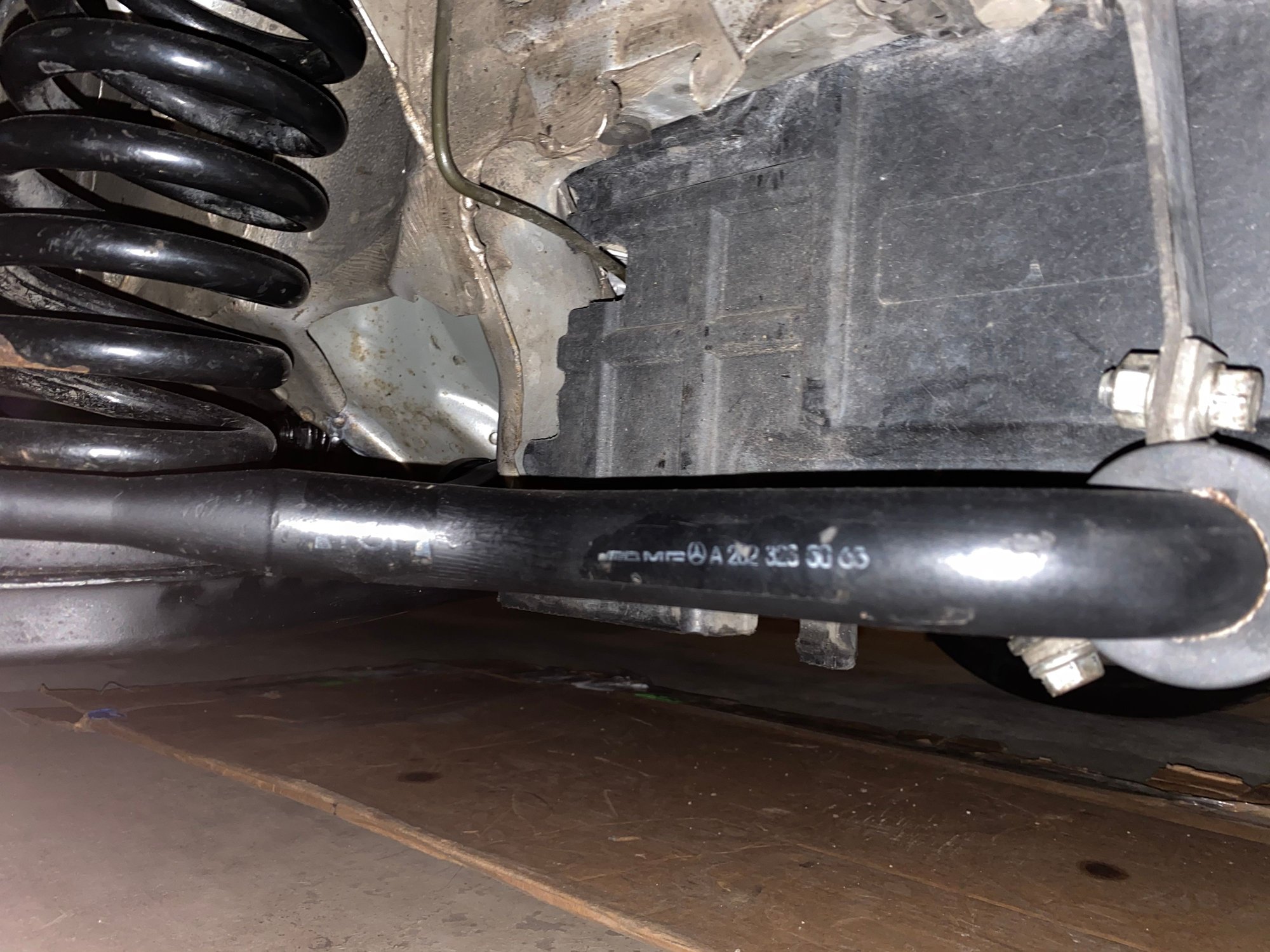

Since we're talking about sway bars... Does anyone know if Eibach provided the factory bars for the AMG 55? My car had an Eibach sway bar but everything else on the car was 100% stock when I bought it. I'm wondering if it was an upgrade or if they all had them.
quik55, can you look to see if your bar has Eibach stamped on it? It would be right in the middle, stamped in white letters.

Joe, I gotchu. When I originally did my front end I was working at a foreign auto shop. New Canaan foreign car in CT, would recommend for any repair or track prep need. One of the techs remarked eibach sway bar. I said damn that's sick my clk has aftermarket **** on it. In a way yes but absolutely no. Thru research which homos will tell you to do on here... I found AMG actually used eibachs sway bars on the car stock from factory, I've seen the stamp on the bar myself but have since obviously sanded it off before rust reforming the bar, but I saved the part #. Eibach or Benz supposedly no longer make the bar but it was original eibach. I believe I went with Canadian springs over theirs on my cobalt and a guy who"drove and raced" with Senna tried to sell me his bars off his cobalt but it fizzled, and so I've only ever run H&R springs and spacers even bought my buddy a pair of springs for his wedding so while I can't say Eibach is good, it is on our car and the bar has held up better than 06 e46 M3 stock and "zcp" or whatever is better than the M ever did years ago.
***referbed wheels, and redid all suspension work due to a FEBI drag link that went bad before 5k miles. From FCPEuro. Also had a genuine Benz water pump go bad after 5k miles and the "lifetime warranty replacement" go bad after 100 miles. So be safe guys.
stamped AMG but definitely Eibach original
only way I believe to get them now a days is thru H&R 28MM front
good luck Joe!

That image is correct, I just did lower control arms and drag link on 02 coupe.
