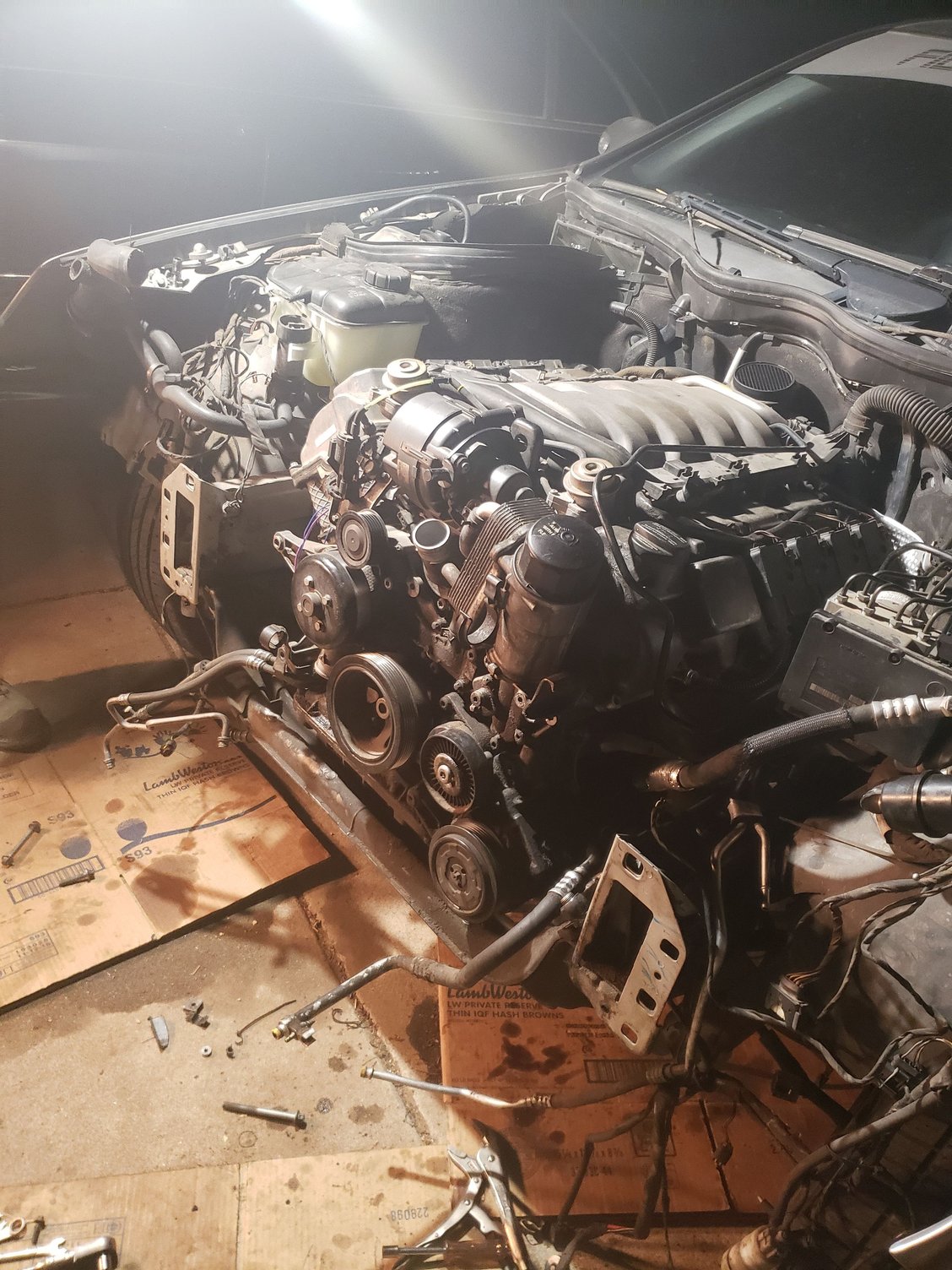

Here the CLK just before we pull the motor. Its an '05. We thought it would be easier to pull of the whole front end to work with and it really was
Just another angle
The engine is pulled, my dad did this while i was at work. You can see where the oil pan is split in to sections, a little bit sits up front just in front of the purple sway bar while the rest sits behind the front axle in front of the tranny. Which is why the oil pan and pump needs to be switched
The M113
My goal has always been to throw a M113K into my CLK and honestly i wouldnt have embarked on this project so soon if it was for the fact i found this donor '03 S55 for a steal!!! So if anyone needs any W220 parts i got them on the cheap
And the engine is out! It was such a B**** trying to find the thread for the front of the S/C in order to lift it. Thanks to the W211 forums they said it was a wheel bolt but wasnt sure from what car, Ironically its from the CLK lol im just glad i kept my bolts after converting to lug nuts

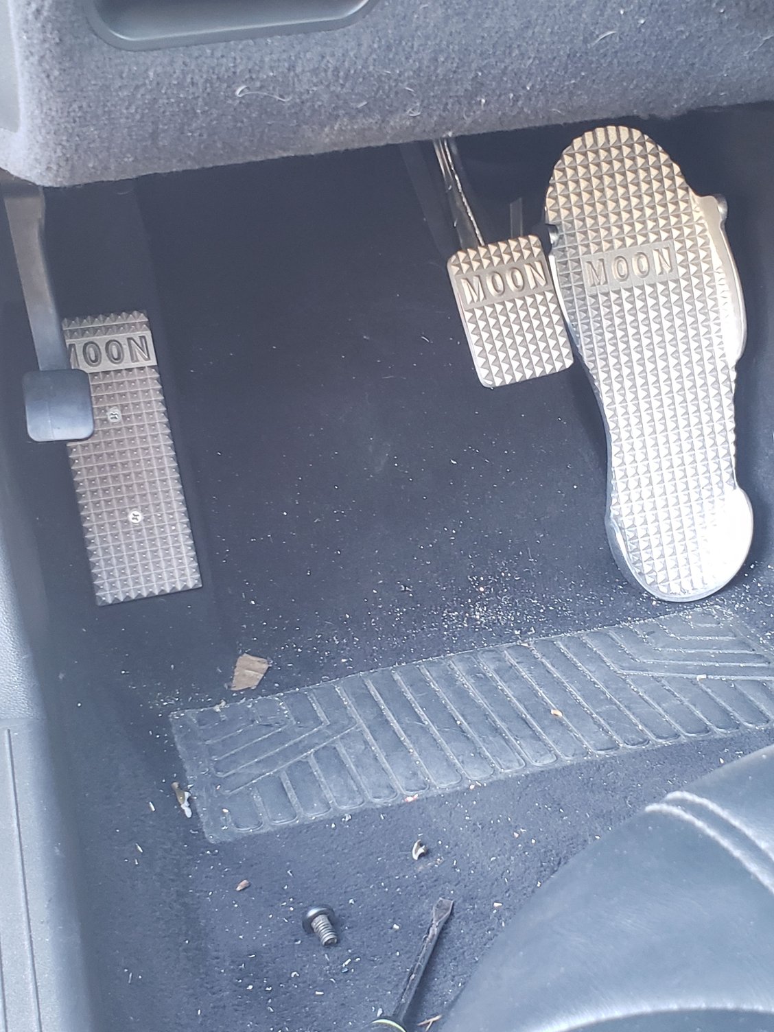

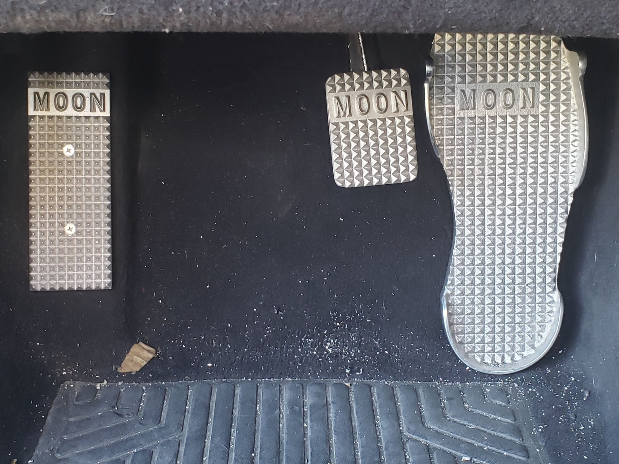

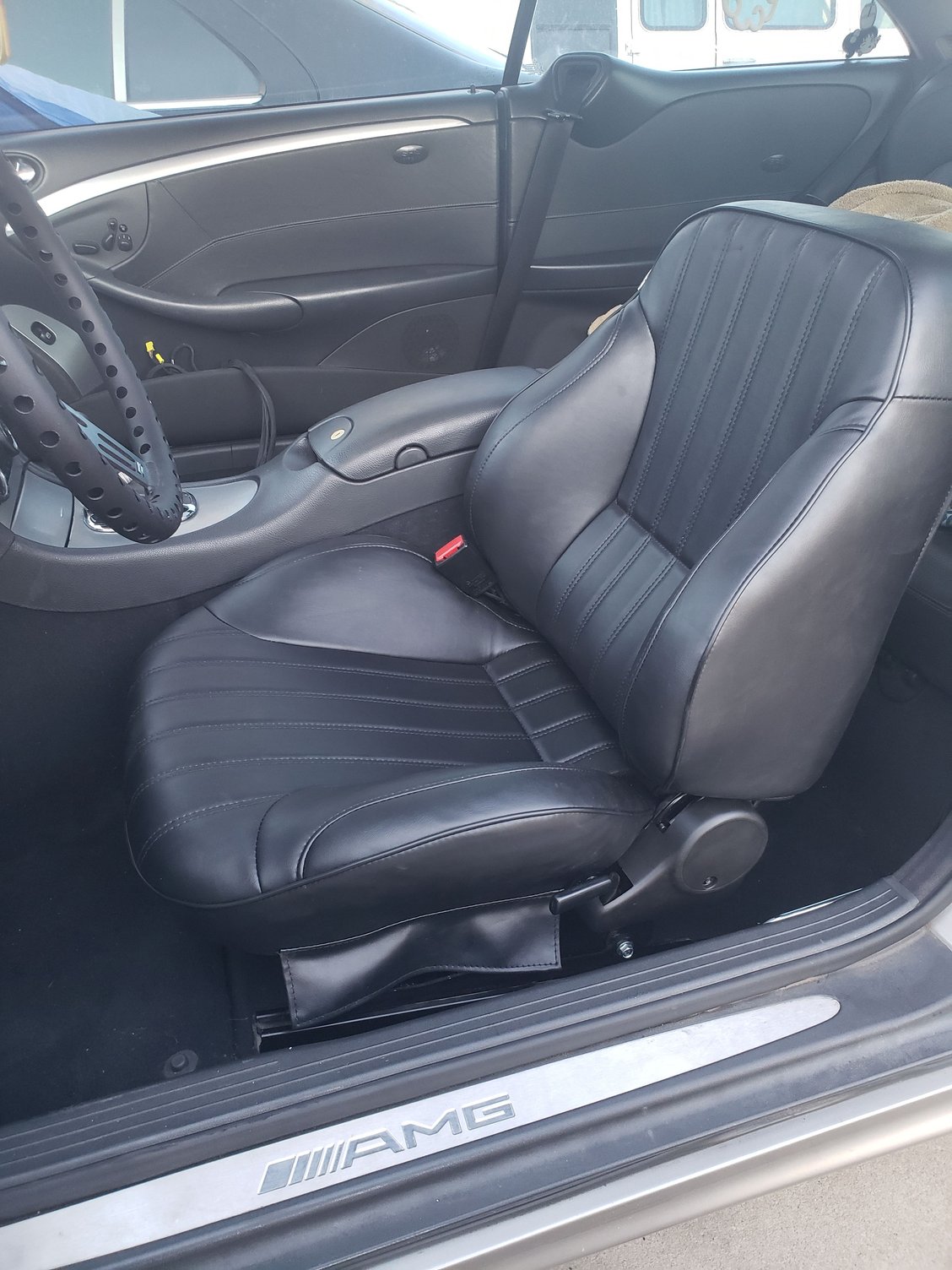

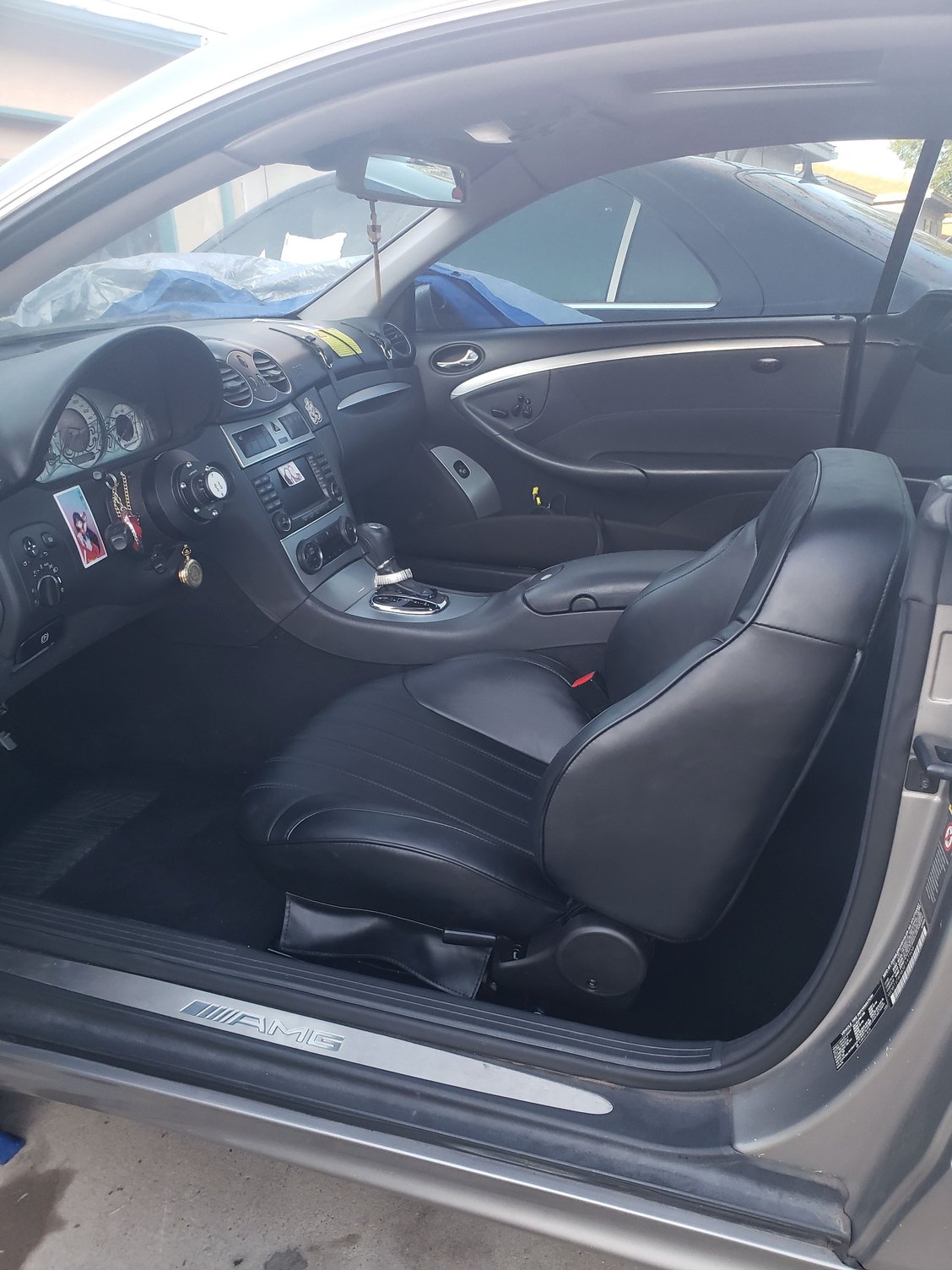

like anything specific? We plan on swapping the oil pans probably this Friday. We took a break to do the interior. I wanted it to look like some old school muscle
These are mooneye pedals i got since they have a huge heritage when it comes to drag racing. Me and my dad trimmed the brake pedal to get that just right
The gas still uses the same plastic pedal, we just drilled, and tapped the metal and screwed it on top. I just had to angle it a bit so it can go WOT with out any interferences. The hardest part is my tap and die set is in metric and NOBODY carries metric drill bits! So i just got as close as i could with standard and it worked

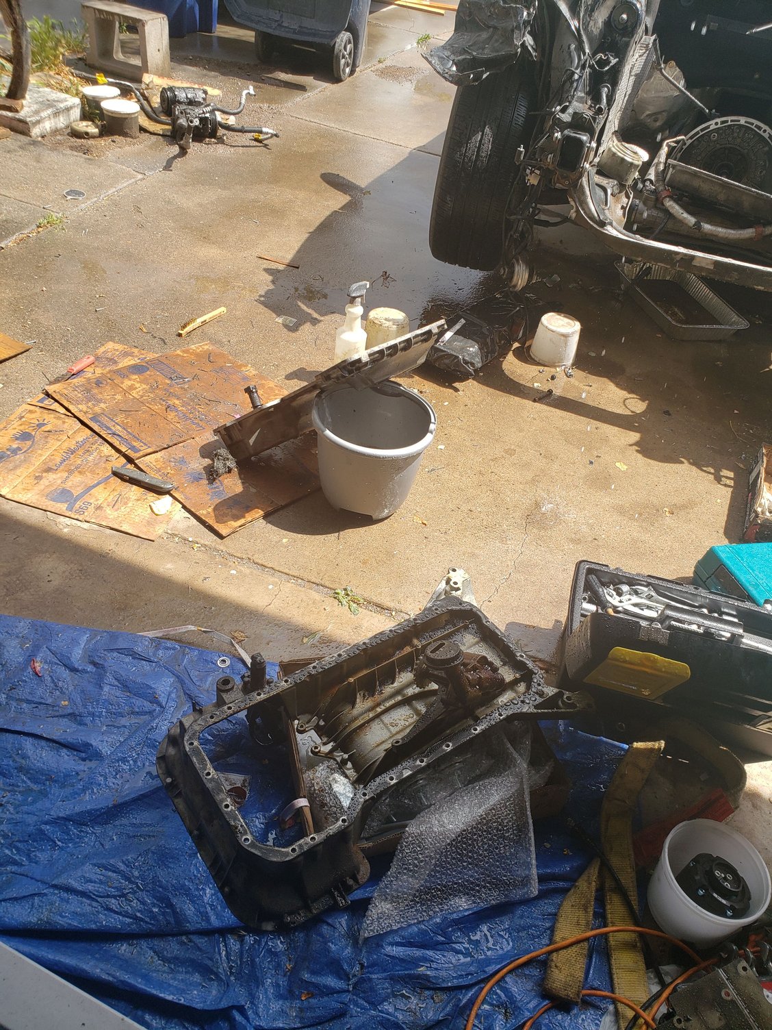

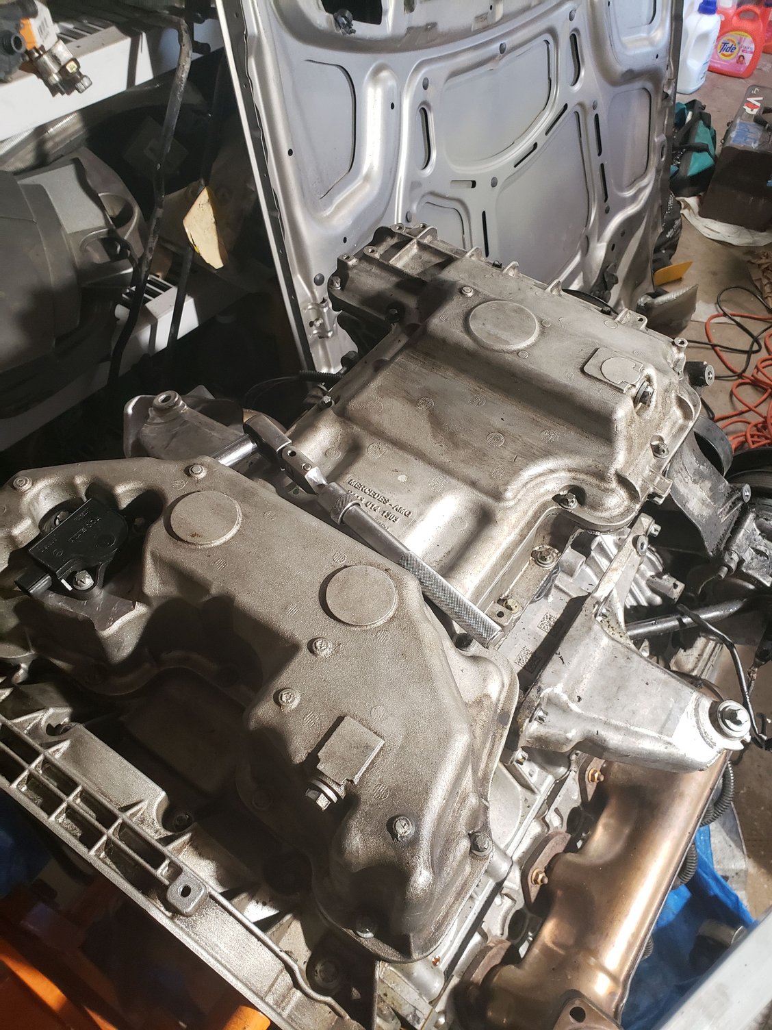

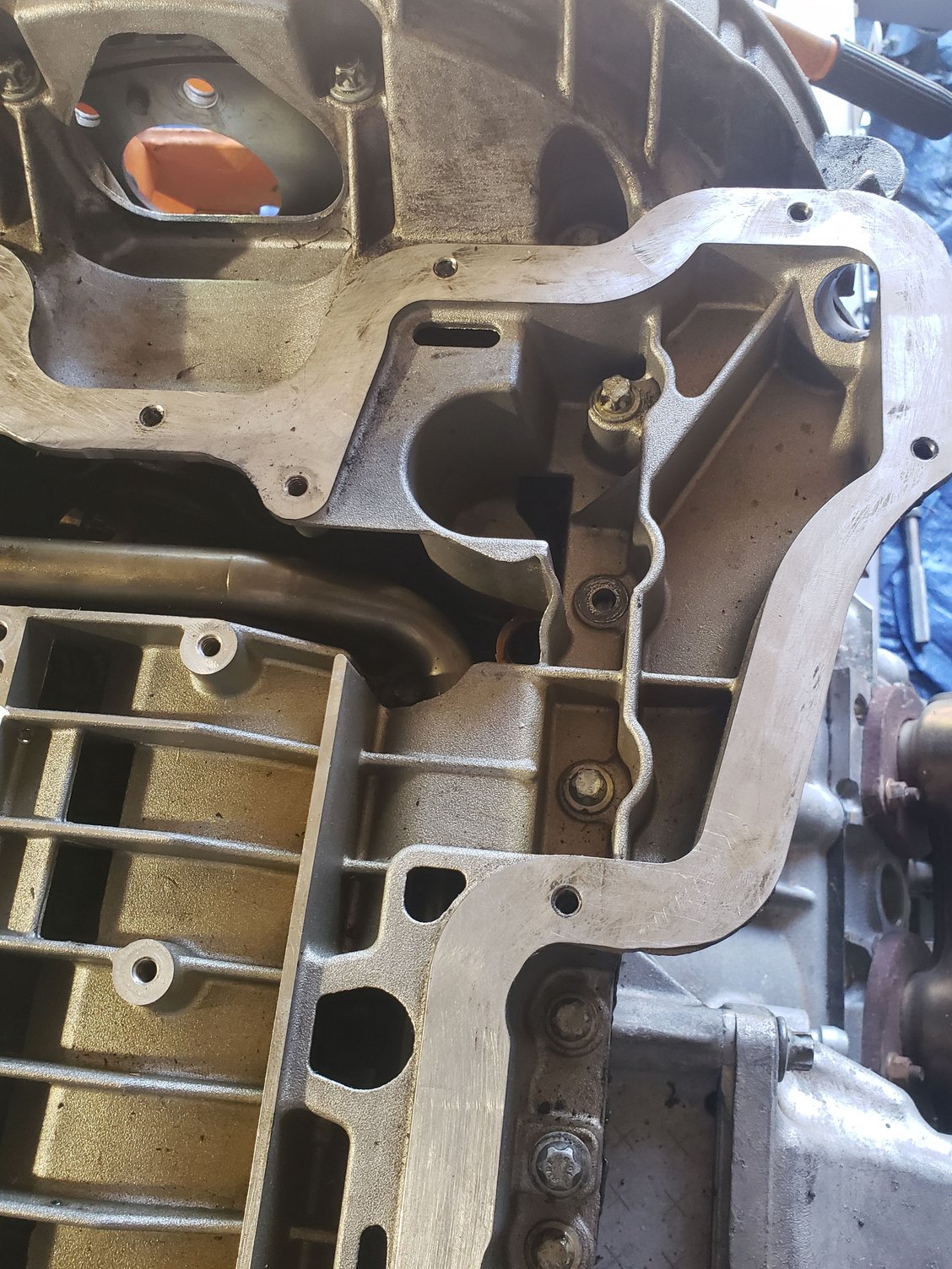

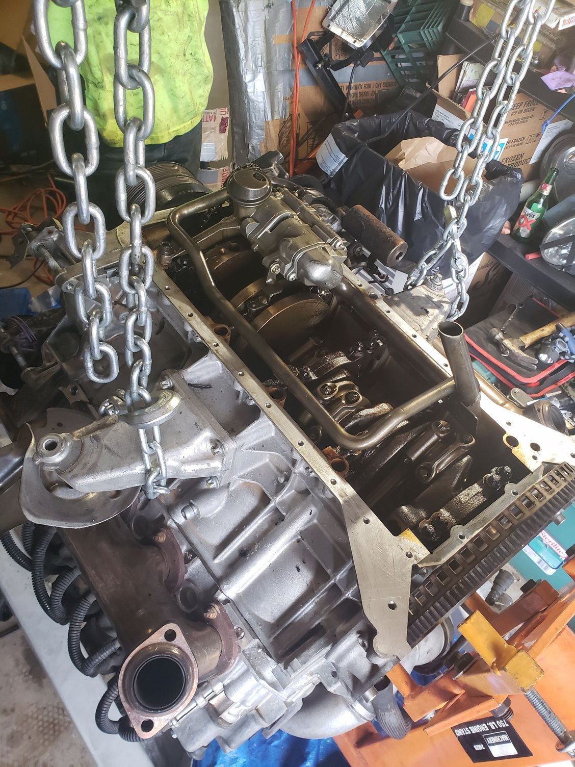

Heres the oil pan from the M113K. Me and my dad kind of went in blind since were both more a do it type. We were worried since the the S has one oil pan and we werent sure about how it would bolt in. Where it bolts in to hold the pump has the same same bolts but hollow and it stays with a screw on top of it so we just switched the bolts. Its really cool actually i havent seen that before.
The M113K pump and pan
Fits right in!
One of bolts snapped but thats a problem for future me
The things we switched were: The pump The base (im not sure what its called, its the part between the block and the pan) The little plate (you can see here) The pan
Everything sealed up and new pan and pump in place. Fits like a glove

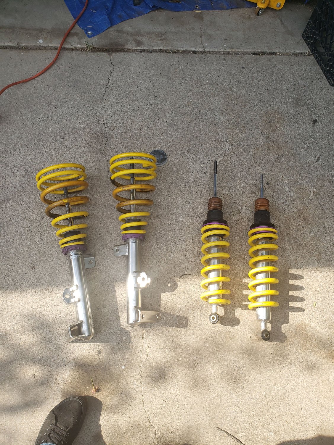

Still waiting on the headers and having to figure out how to upgrade the fuel pump for the swap! So while I wait I splurge and got new (to me) wheels, KW V2 coilovers and to tie both of those together some spacers/ bolt pattern adapters.
I gor these from another member on here
These are siick cobra reps i got for a steal. Needs a little TLC so theyre getting resurfaces, and the face is going to be powdered coated matte black to match the flames i have on my sides of my car. Nothing screams muscle car then bullit wheels!!!
Since the wheels are from a mustang i needed an adapter kit and since KWs need a spacer, these work two fold. And funny enought i was just talking to some customer at work and got on mercedes and he told me he had the adapters i need, unused, for a project he never finished and sold them to me!

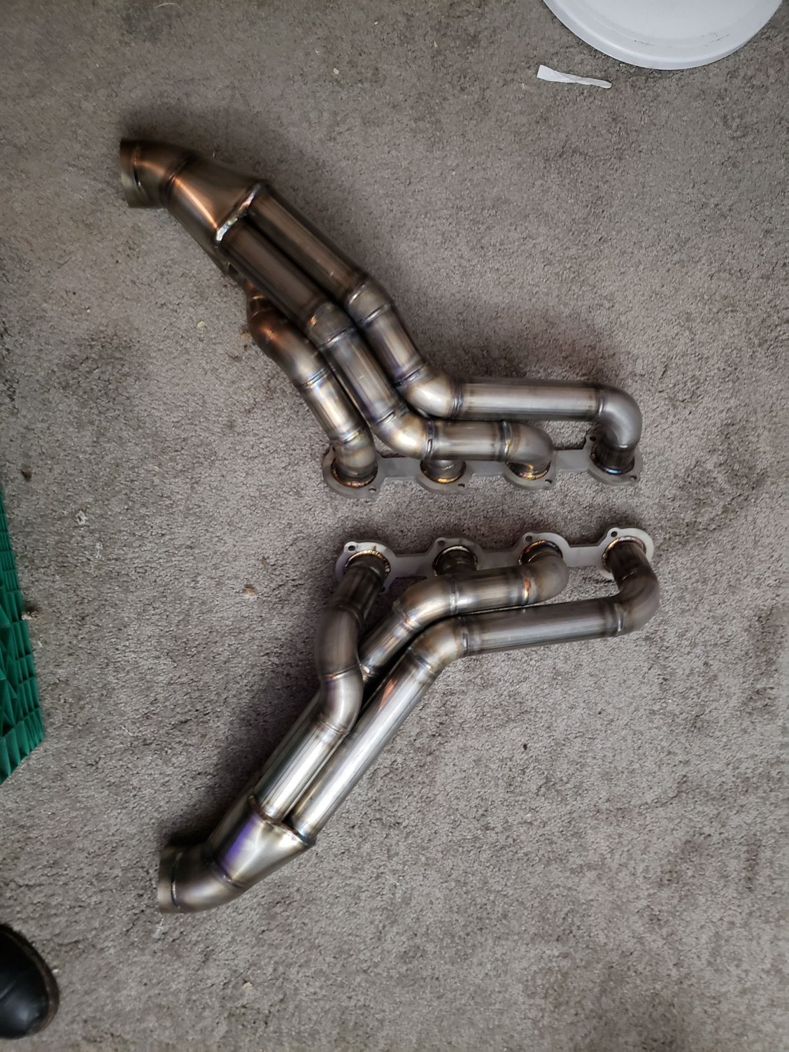

Here are the headers ive been waiting on! It took 7 months but tbh im not too annoyed because i get it, with covid and all
Not too bad for a first time wrapping headers. I cant wait to find time to install them!

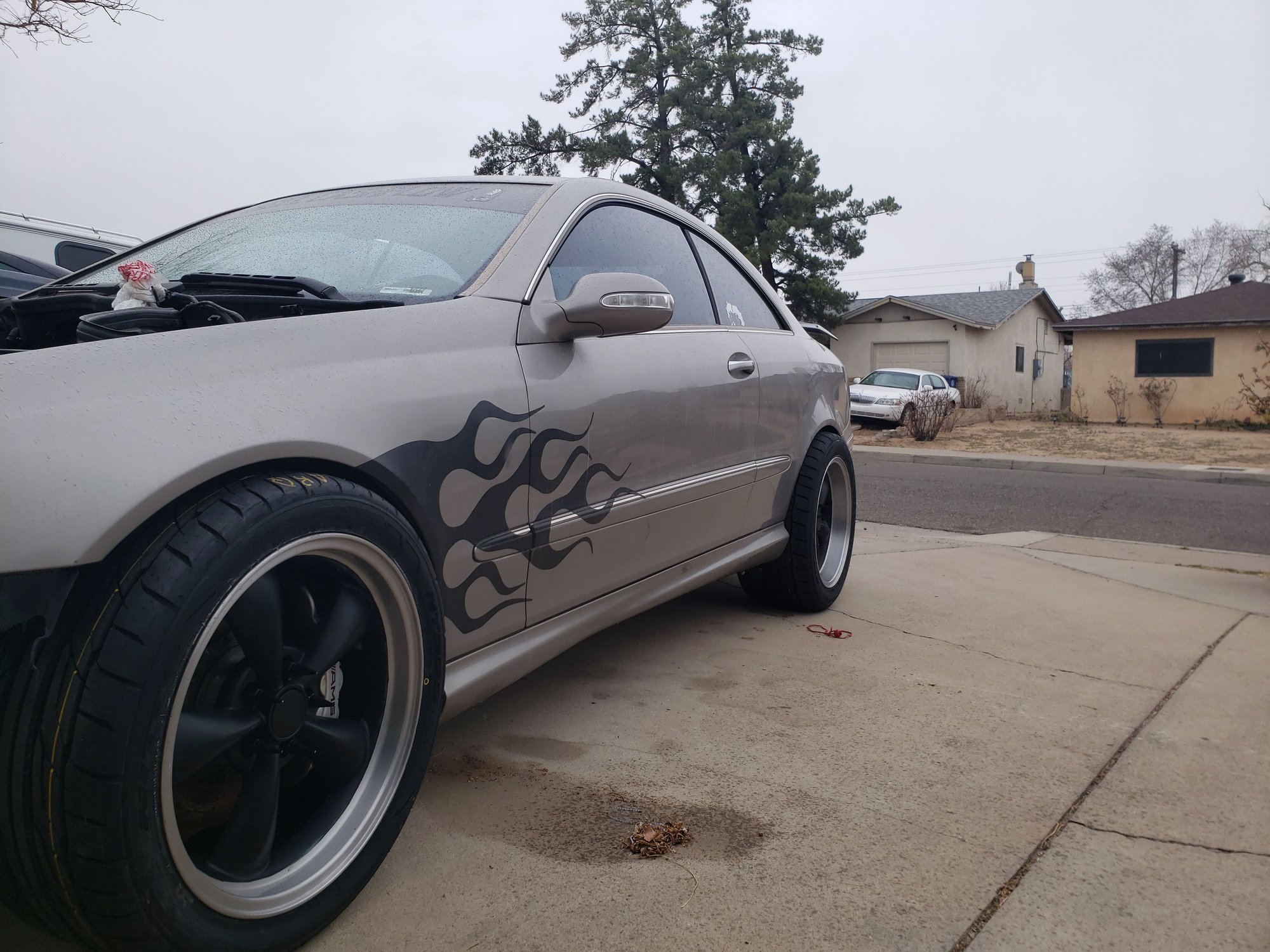

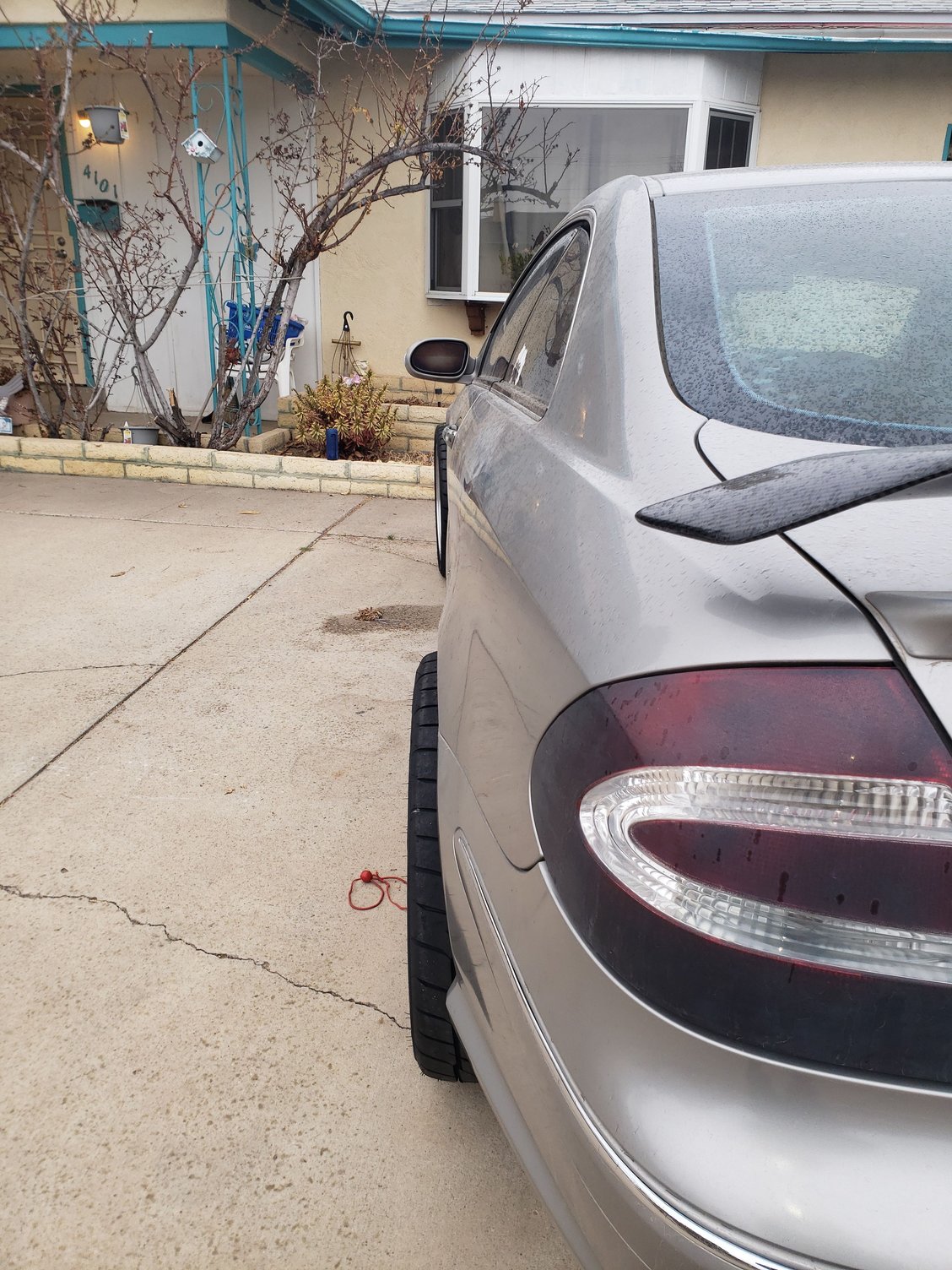

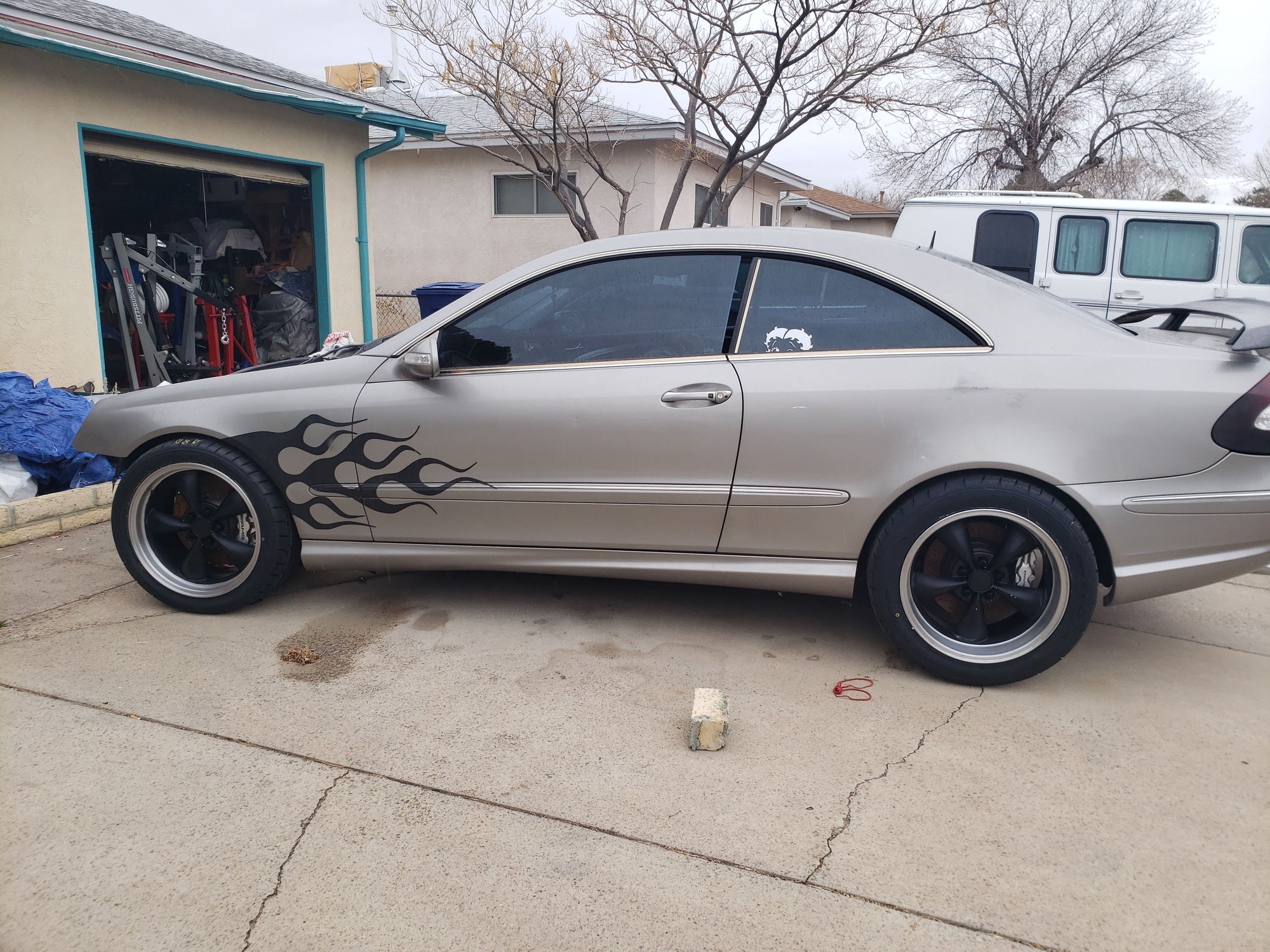

I have the car on the ground! With some unfortunate family emergency and other stuff popping up im making progress slowly. I got tires now, Nitto G2s. I'm running 285 upfront and 295 in the rear. I'm surprised on how much they poke out. I wanted poke fitment but not this much. If I do move to 305 I will need to add fender flares, which I was hoping to avoid but it looks good. Its revitalized me working on my car since all this outside stuff kind had me burnt out. I'm still waiting on FTP aluminum pulley to come in, its almost been a year and they still weren't able to get me the idler pulley I ordered in black so they're sending one in sliver. The next thing I plan on doing is the fuel pump which im nervous on doing and mounting my A/F and my oil pressure Guage on my dash.
You can really see how much they poke in this pic.
You can see the spike lug nuts. Its the little things that pull it together lol
