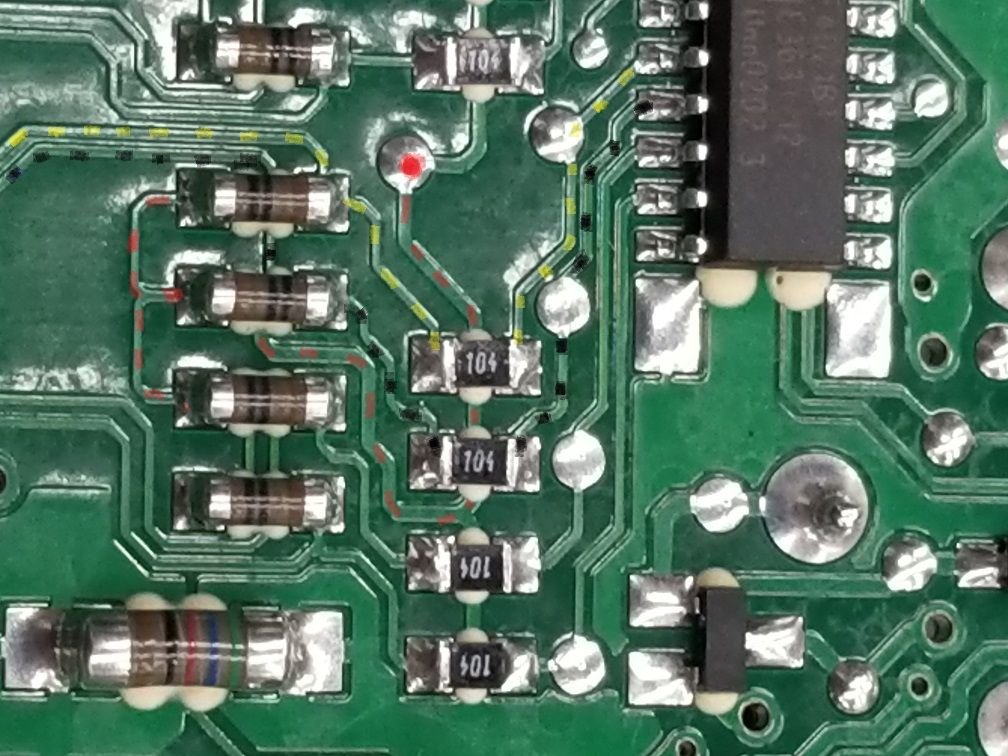

back probing pin 33 12V output to the switch, s84/13a soft top open, showed continuity to ground with switch closed, no change in live data.
as i was absolutely sure none of the other switches were faulty, i pulled the PC board from the car to trace circuits.
pin 33 in yellow goes to the top of a dropping resistor that supplies the 12v (in red) to the micro switch.
it then goes through resistor 104 (100k ohm spec) to the processor chip.
the 104 ohmed out to 5.72m, essentially open circuit, with the ones parallel reading 99.5k
so open circuit between the sense wire to the chip and the switch.
N52 ordered to confirm, no signs of root cause besides single component failure
