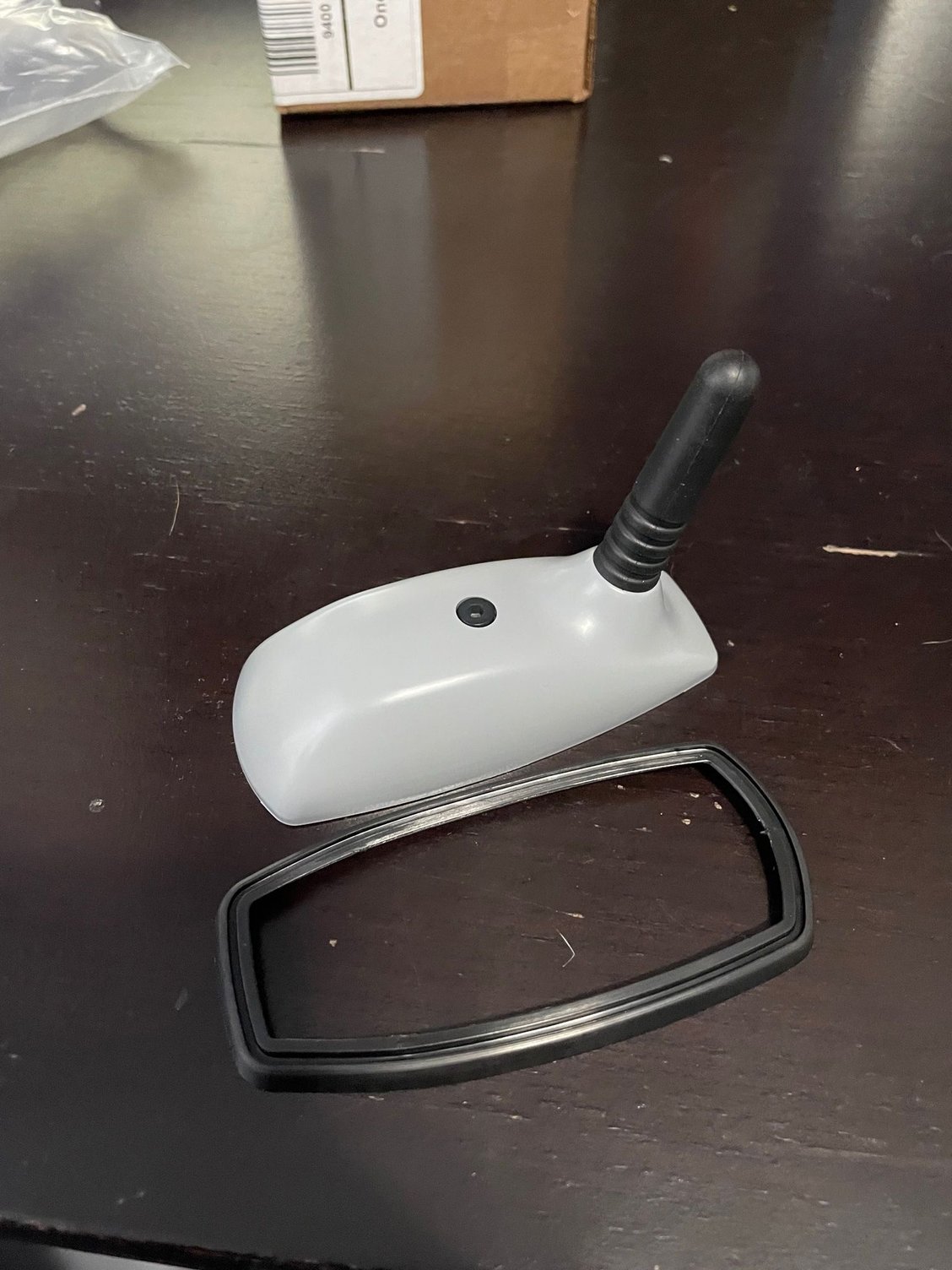

Hello,
My antenna cover has been trashed for a while so I finally bought a new one as I have repaired the rust on my CLK. Apparently it comes unfinished even though this ebay add showed it painted black. This is any OEM part.
Anyway, I can bring it to my body man but was also thinking this would be simple to paint. I wanted to ask since it is going onto my freshly painted car. Should it be primed? Should I just get some gloss black spray paint for cars? Any recommendations?
thank you!

You need to prep cover with primer for paint to stick otherwise next time you wash your car with a water jet pressure you will blast the paint off and you need to paint it again.
Therefore, first spray plastic-rubber primer and let it dry for 24hrs before you apply paint the next day.
Finally when it's done you apply clear coat

I have no doubt you can do it yourself, but I would highly recommend you have a professional paint shop do it to avoid any mis-haps. It's a small piece and it won't cost a lot to paint.
