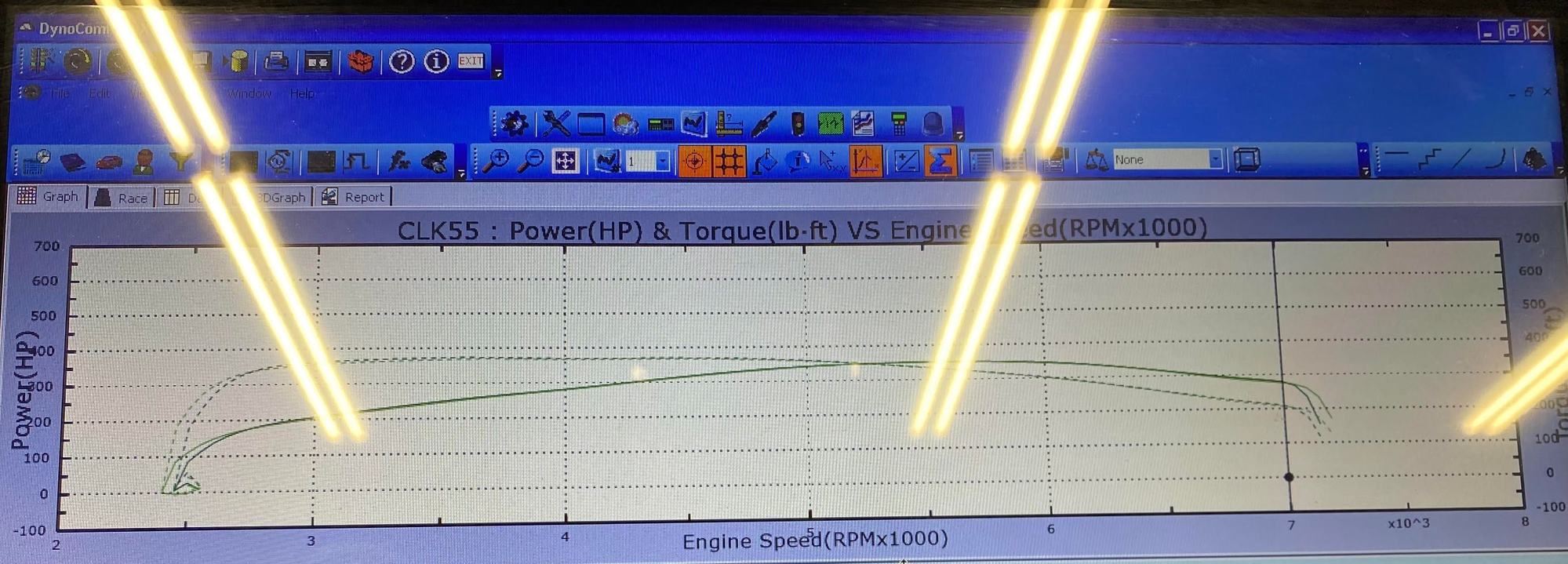

unfort best NA mods will net you is max 360-370whp. dyno below is before i removed my kleemann cams (suited for supercharged and not NA engines) and replaced them with w209 amg ones, expects to get another 10whp back (butt dyno confirmed lol).
