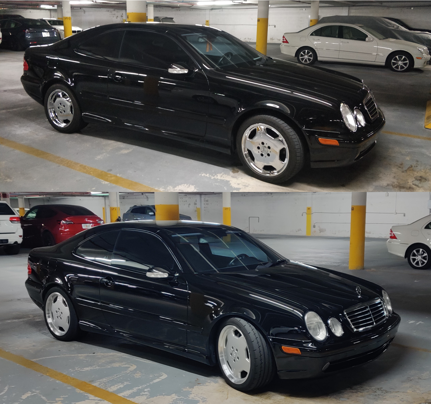

If the wheels are rubbing on stock suspension something went wrong. I had the same wheels on stock suspension with 245 fronts and 275 rears and I dont remember any issues... lowered I would also say no rubbing (but there might be a little rubbing).
Lowered on H&R Sport, Yokoyama tires:
- 235/40 front, #2 pad - rarely I hear something, specially when the wheel is turned all the way left, but its minor and infrequent
- 265/35 rear, #1 pad, plus 12mm spacer - no rubbing, I think i could have gone to 15mm with no issues.
I couldn’t find a photo with Mono II's and not lowered, but here is stock suspension on stock 17"s vs. lowered on 18"s. You are absolutely correct, the front is way to high.
