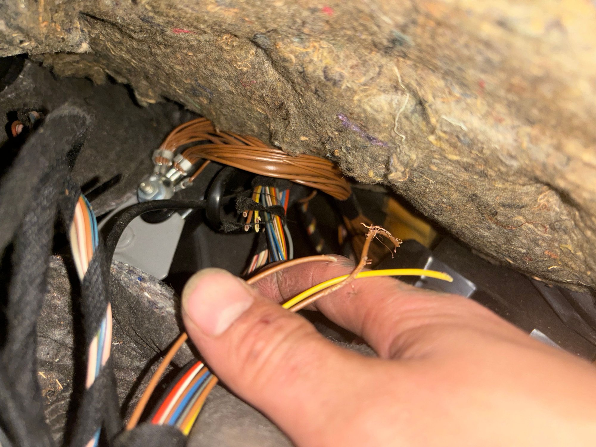

Think I may have found the problem with instrument cluster stuck on , found 3 wires behind it all chewed up smh looks like a damn rat got inside or something. Not sure exactly what they control or where they go but they clearly need to be fixed . Anybody know what the yellow wire is ? I’m assuming the brown is ground

you need some one who knows more about these cars to help you in person. sorry i cannot be of more help, i hope you get this figured out.
