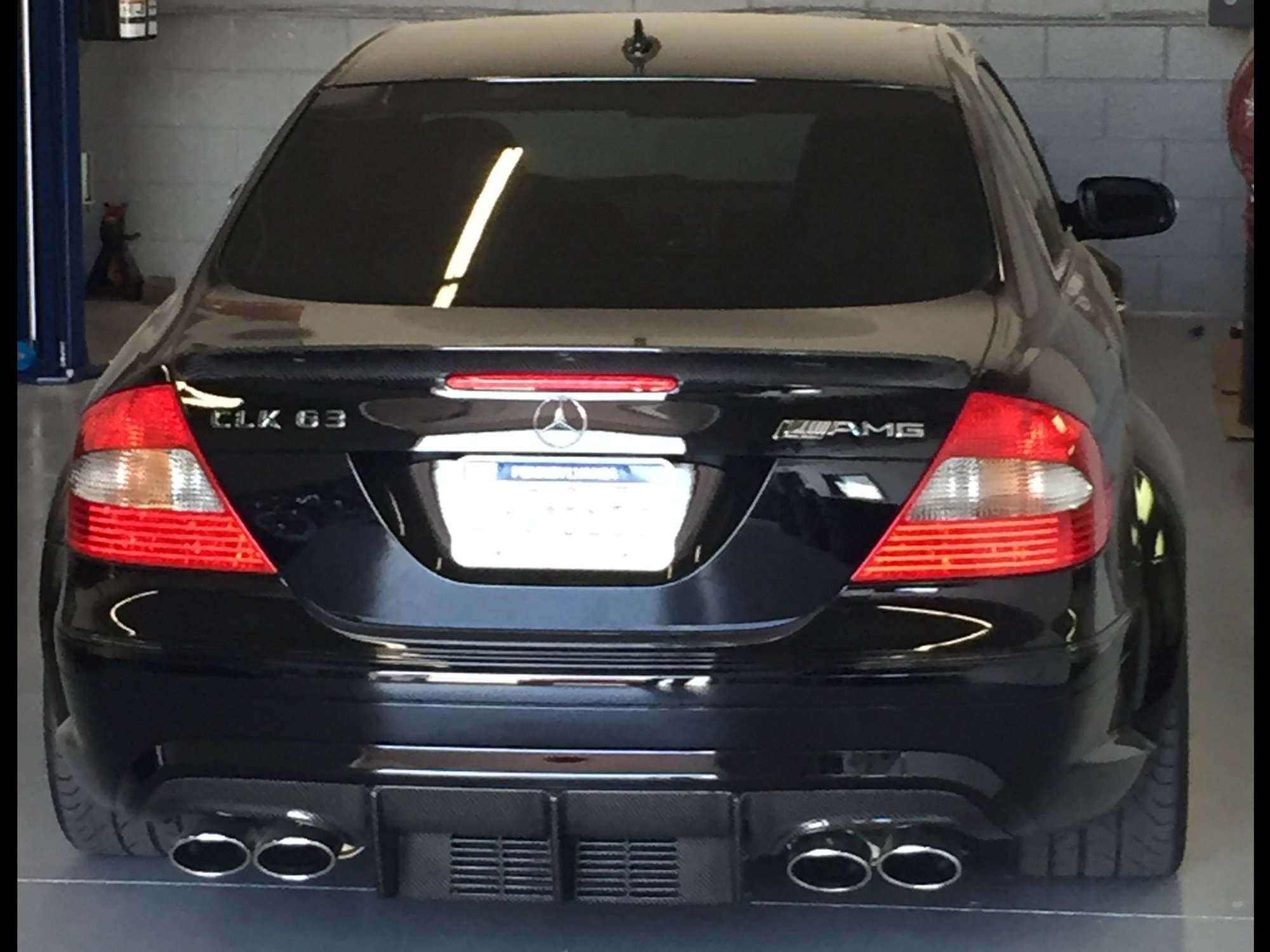

I just saw my car with spacers installed today.......wow do they look amazing!!
I went 10mm front and 12mm rear with extended bolts (H&R part #'s below). As always with this car,, pics don't do it justice.
IMO, tire gap looks perfect in rear and near perfect in front. You may be able to run 12s all around, but no complaints with current set-up.

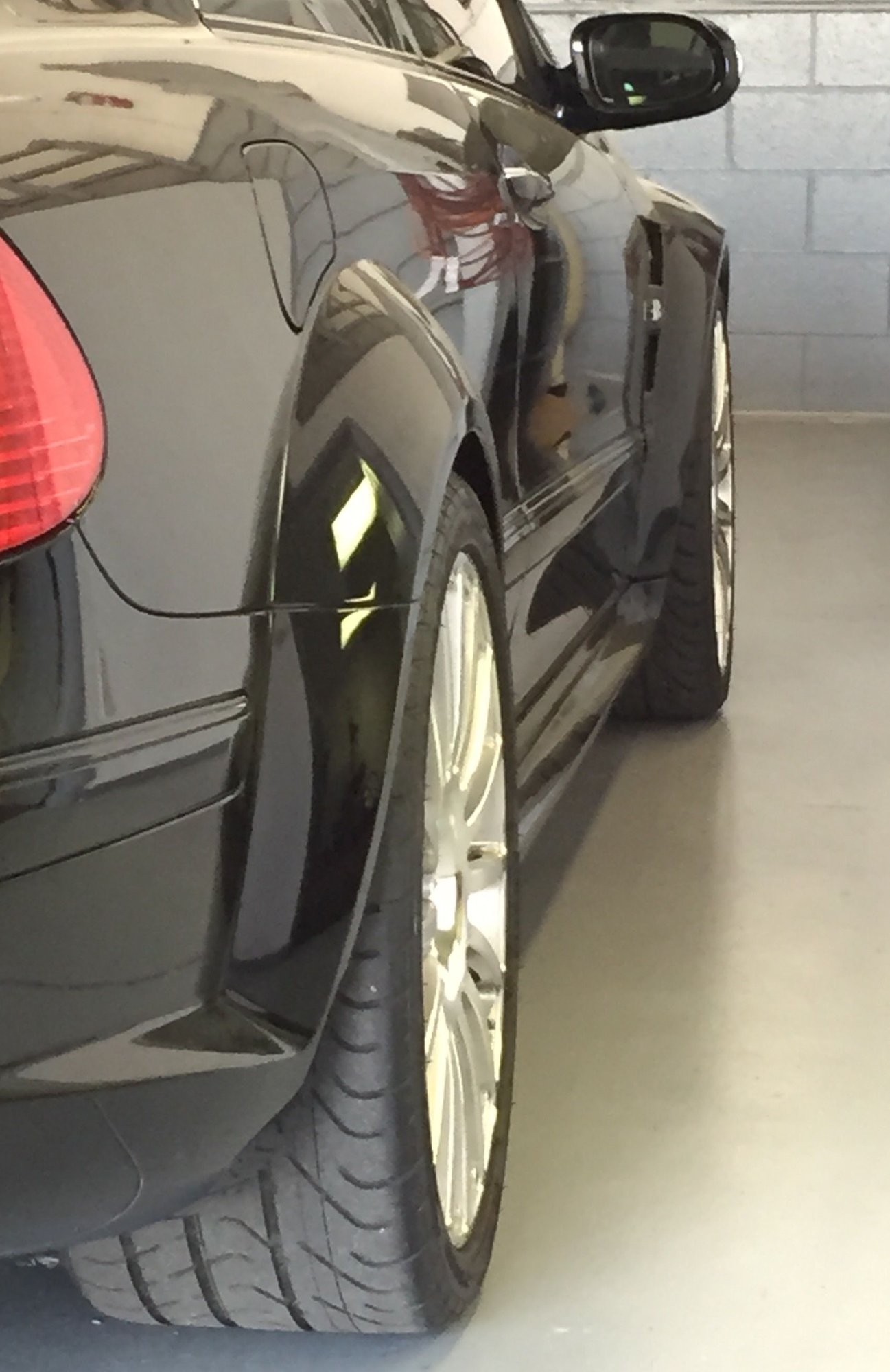

Jcrame00,
Please post a picture from a side angle so we can see how the front and rear tires line up to the fenders.
Thanks!

This is my only side view photo. I'll post better photos when I get back next week. I apologize if photos seem overly large, I need a 101 on photo uploads.

Looks good! Thanks for the side shot.
Seems like you can go a bit wider. 20mm/rear and 15mm/front maybe?
