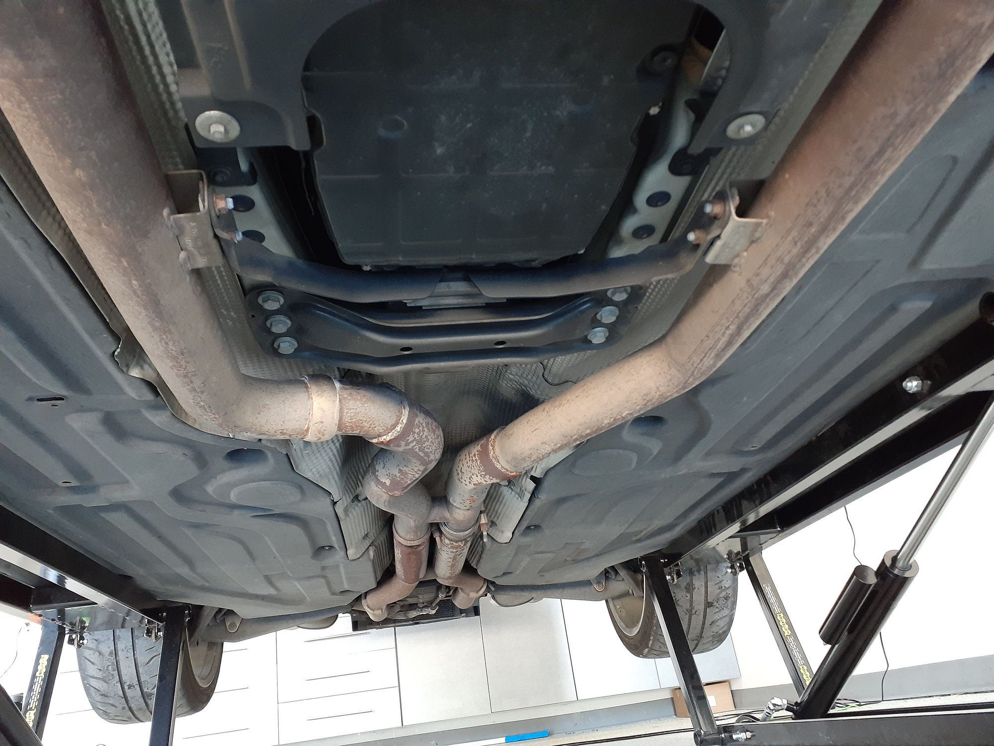

Old Aug 11, 2020 | 07:06 PM
Doctodd33's Avatar
Joined: Mar 2003
Posts: 2,018
Likes: 148
From: South Florida
ML350
Big grin with new x-pipe. From down pipes to mufflers.....really loud when you step
on it. Almost stock sound at low rpm’s.
Old Aug 11, 2020 | 07:22 PM
Doctodd33's Avatar
Joined: Mar 2003
Posts: 2,018
Likes: 148
From: South Florida
ML350

Old Aug 12, 2020 | 08:50 AM
Doctodd33's Avatar
Joined: Mar 2003
Posts: 2,018
Likes: 148
From: South Florida
ML350
Pics....
