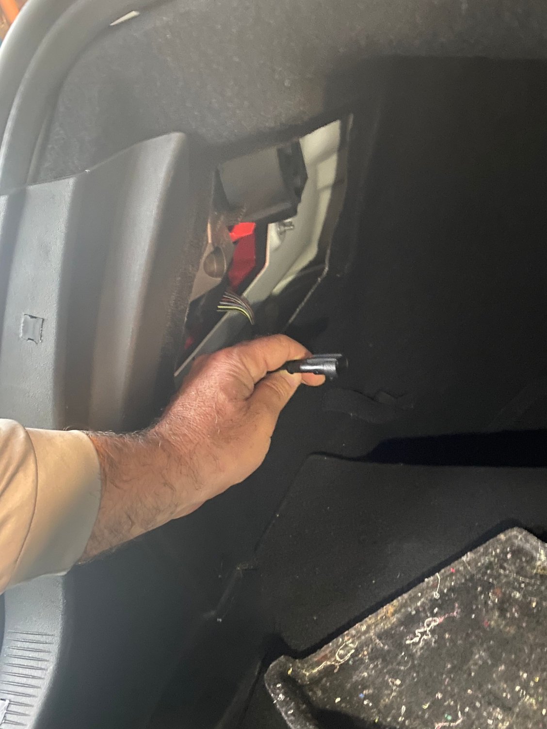

Regarding the trickle charger. There is a connection behind the LEFT tail light trim in the trunk for a trickle charger. Its a slightly different plug to a CTEK charger. So what i did is, i just cut that one off, and soldered a CTEK plug to it. That way i can use a CTEK charger. Its the best solution IMO

Trickle charger? Supposedly this replaces the older number.

After reading all the notes above orders A0009822921 from what and exactly as described, just had to unclip “the cover”. Thanks guys.

not sure I understand. Are you saying you were able to get that A0009822921 trickle charger working?
yes! The factory wire from the car has a clip on it that needs to be removed like the pictures above and this part number clips right in.

Turns out my battery was dead cuz it’s been sitting for about 3 months. So I jumped it with a portable jumper by removing everything in the rear and directly jumping the battery. The positive battery connection in the engine bay didn’t work with the little jumper. I was looking for the rear trunk connector and this is all I found. My shop said they can connect a battery tender wire connector straight to the battery and use a C-tek. I’d rather use a Mercedes tender for collectibility purposes.
looks like the same one but pictures a little blurry. The cap is already removed but take a look at the pictures above. If it’s the same I got my Mercedes online and it’ll plug right in. Agreed why go ctek when you can go oem
