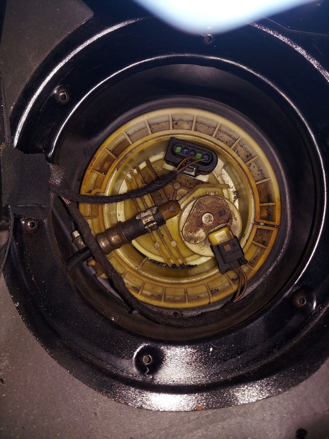

Interesting look at my fuel cover. Won't be able to fuel to the top to take a look where it's leaking till it's warmer for me here but it looks like (bottom of pic) is where the fuel is sloshing back as i drive and filling around there

I had to replace my fuel pump last year after the seal failed (fuel was visibly pooling on top of the pump). The car and my garage smelled very heavily of gas odors when it did. The local Mercedes shop here is also an AMG dealership and replaced it and the fuel sender for $ 1164.00. Both entry points/sides (behind the driver side and passenger sides) needed to be opened up for the repair and then also have both seals to the metal access caps replaced (they are intended for one time use only). No more fuel odors after the repair. Apparently, the fuel pump seals fail in time, thus the 15-year recommended replacement.

i replaced the fuel pump sender friday, its DIY if you have a few hours to spare. in many cases, its not the seal but the plastic housing that gets crack due to age/overfilling/over-pressurized.
updated part # for sender and adapter:
sender - 209-470-22-94
updated adapter harness - 211-440-05-07
pump seal - 019-997-23-45-64
sender seal -
211-471-05-79-64
will require new seals for both sender location and pump, i used this video from FCP as reference:
