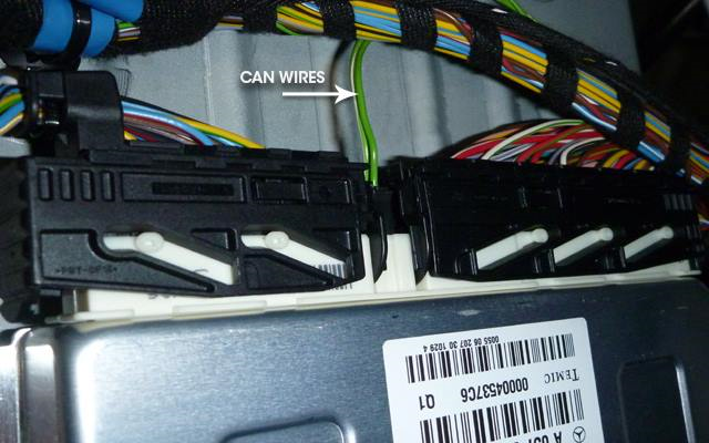

Hopefully I successfully attached picture showing CAN wires coming off lowering unit (in passenger footwell) between the two big connectors. I tried to upload as a picture but couldn't from my iPad. Also when I installed mine I used 14-18 gauge T connectors and it wouldn't work so I went out and bought 18-22 gauge and then it worked perfectly.

Thank you for your response. That helped a lot. I still can't get to unit to work. I'm pretty sure that I have all the right connections, but I may not be receiving any power to the unit. I've read that the power wire coming from the Lomo M1 harness, may not be pierced at times, so that I may have to wrap it around the OEM power wire. Have you heard of anything similar happening to anyone else.
