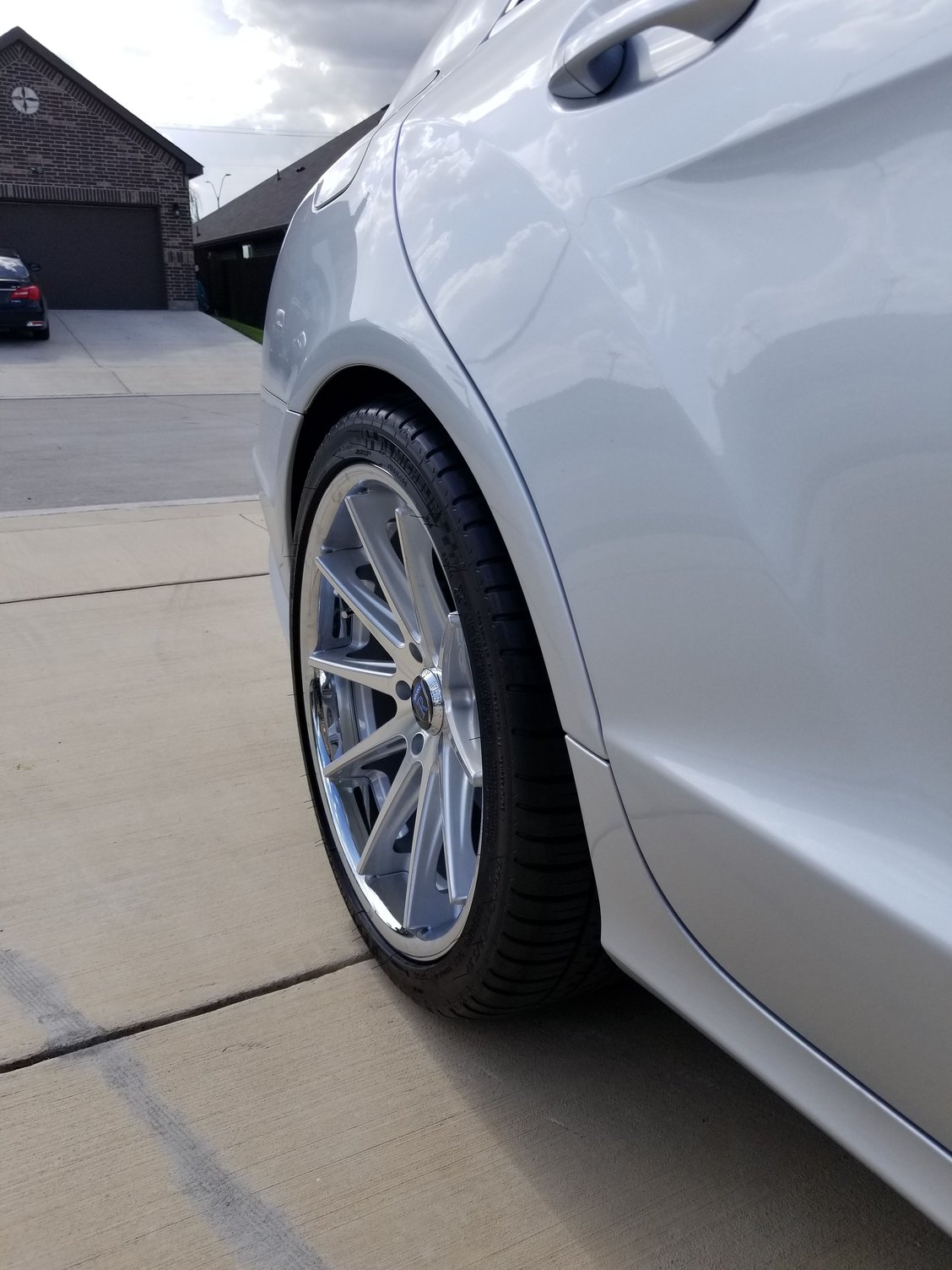

Old Jul 13, 2018 | 09:43 PM
unlukky's Avatar
Joined: Apr 2007
Posts: 737
Likes: 38
From: Fort Worth, TX
2019 CLS450/ 2002 CLK55
Old Jul 13, 2018 | 11:10 PM

Used a 5 mm
spacer. NO mechanical reason they didnt fit per EVERYONE.

Extended bolts but I ended up at 3mm. Really no need until you start going over 5mm.
John
Old Jul 25, 2018 | 04:21 PM
unlukky's Avatar
Joined: Apr 2007
Posts: 737
Likes: 38
So I ended up with a 3mm spacer in front for an end result of 22mm positive and no spacer in rear with a 33mm positive. I still dont know (nor does anyone else) why the 25mm did not work, but here it is.
