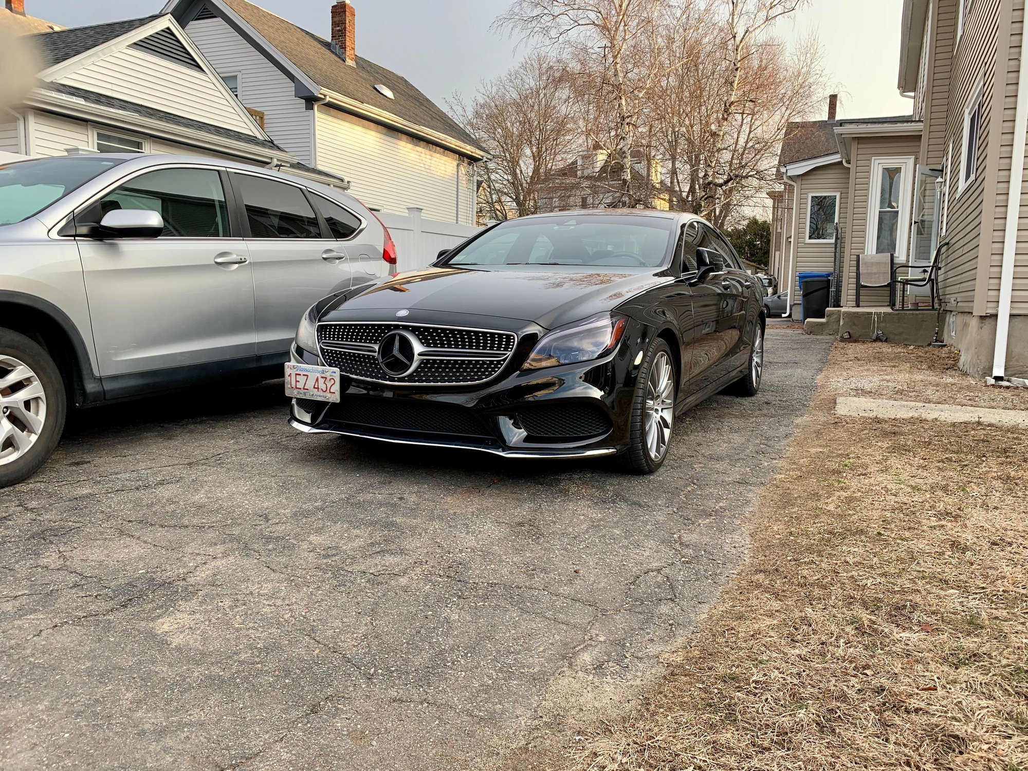

Originally Posted by Snarson
Do you have any pictures with the spacers installed?
// Mattias
These are 15mm front (results in et19.5) and 25mm(results in et23 - a bit too aggressive) rear. I then switched to 20mm (for offset et28) rear.
Used H&R spacers: front 15mm DR 30556659 (front only), must use 15mm longer bolts (MB ball seat 43mm shank), rear 20mm DRA 40556654 with stock bolts (or DR 4055665 spacers with 20mm longer bolts, 48-50mm, can also be used).

2013 CLS550
I just installed the 19" AMG wheels on my 2013 CLS550. Front ones were touching the brake calipers. 10mm H&R in the front and longer bolts did the trick. Nothing needed for the rears. Got them from https://www.ecstuning.com/
Installed
10 mm H&R
