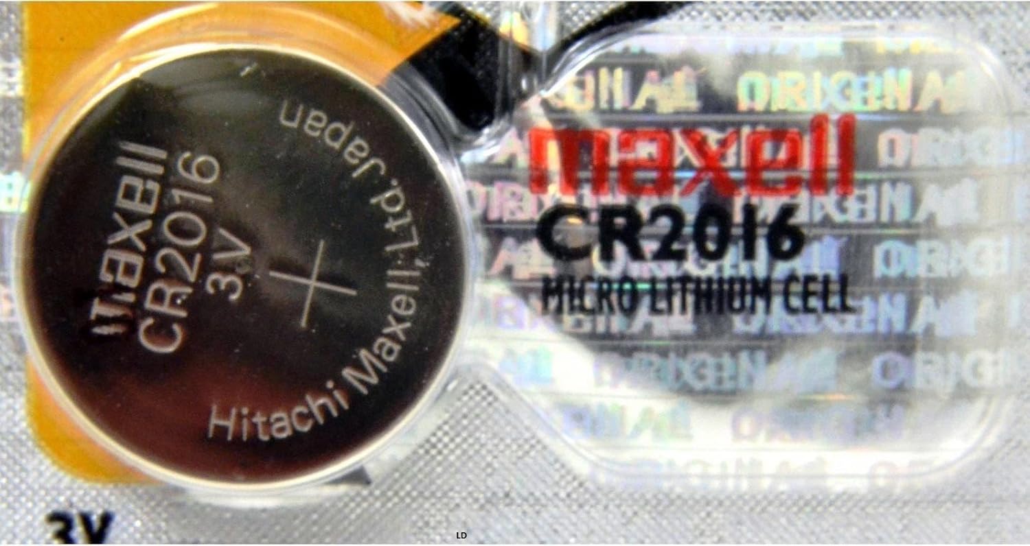

Old Apr 30, 2019 | 03:48 PM
cwelk87gn's Avatar
Joined: Aug 2017
Posts: 4
2014 CLS550, 2005 Honda VTX 1300, 2015 Toyota Landcruiser
Two quick things I have figured out with these keys. First, I had wired in a dashcam and for whatever reason, it caused the car to randomly display "Key not found" message. When I unhooked it, it immediately went back to normal. In the meantime, I ran across a post about using genuine "Japanese" Maxell batteries in the holographic package. Apparently, the Duracell and Energizer batteries from the drug stores aren't up to par with the Maxell. Just a quick FYI
