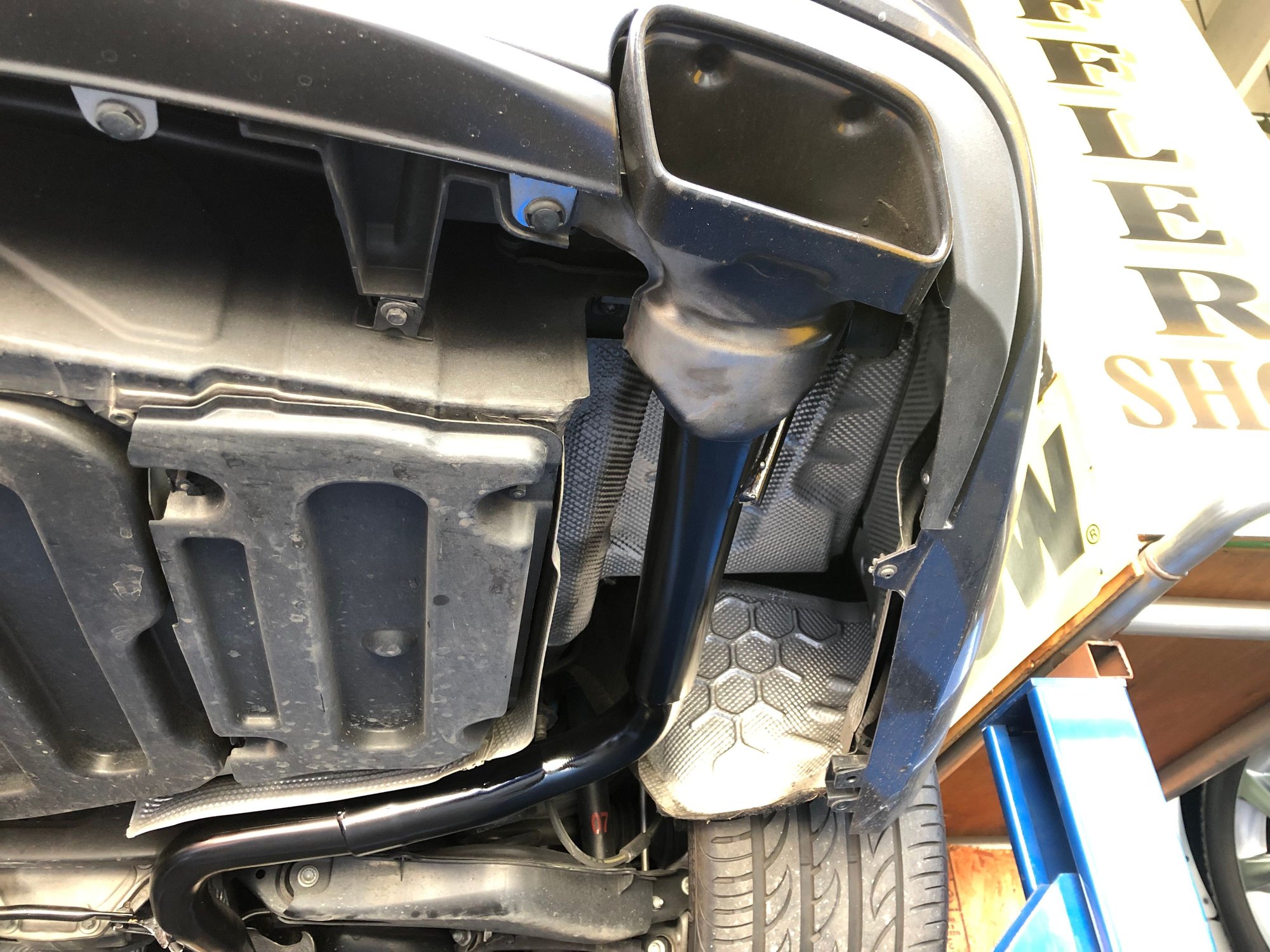

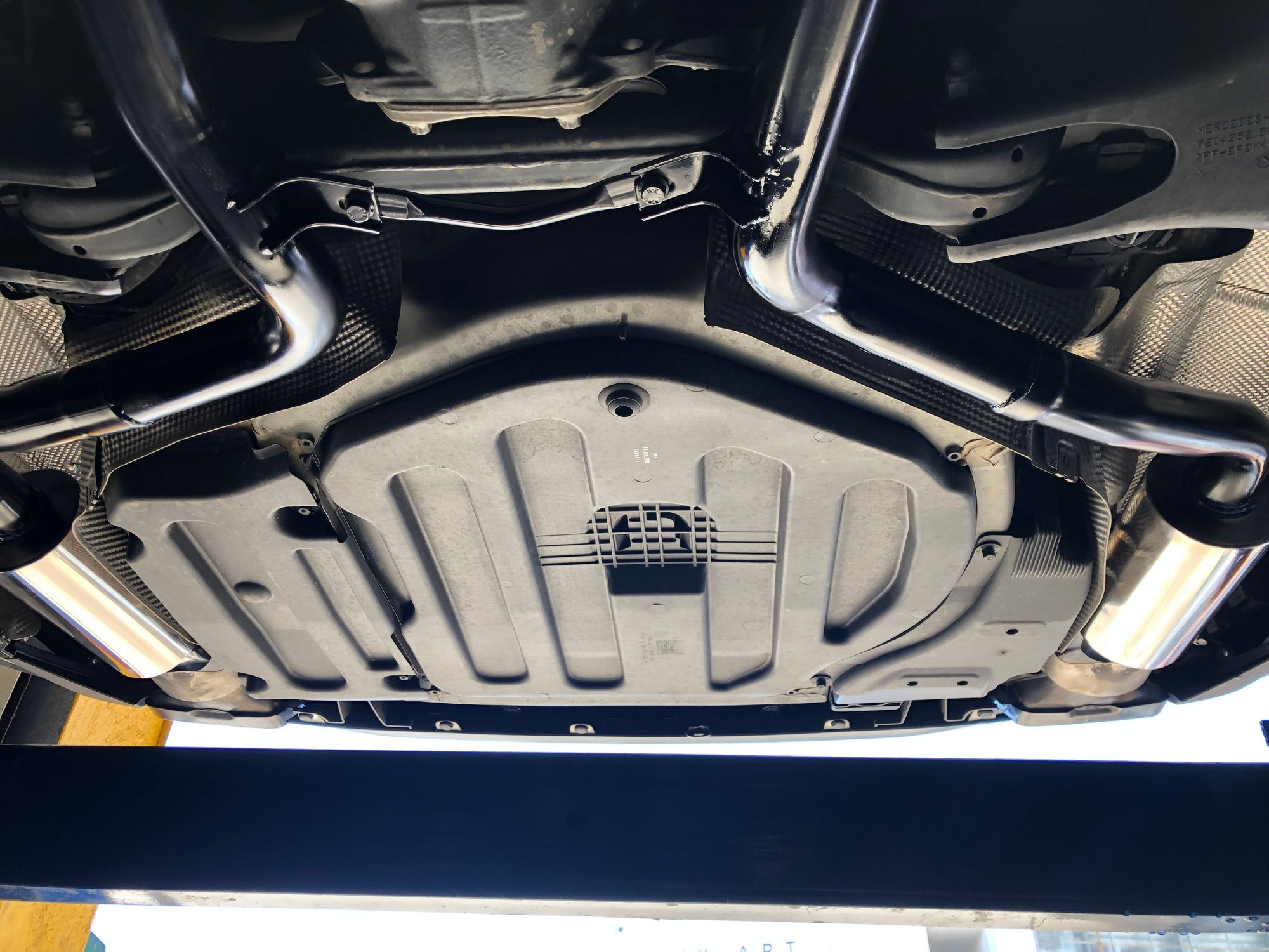

I just did a resonator and muffler delete to my 2016 CLS400. It sounds amazing; but after driving it for a weekend, I felt like it's too loud sometimes.
I am thinking of getting performance mufflers to make the sound less annoying and better, anybody have recommendations on good mufflers for a CLS400?
Pictures:
Trial 1: Straight pipe -- muffler delete, resonator delete, and secondary cat delete
Spoiler
Trial 2: Straight pipe -- muffler delete, resonator delete, and secondary cat delete w/ new mufflers installed and new x-pipe

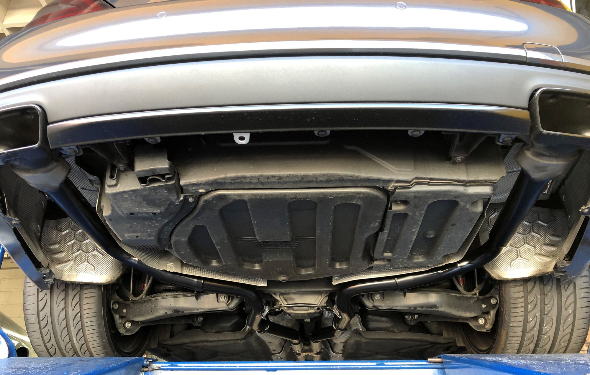

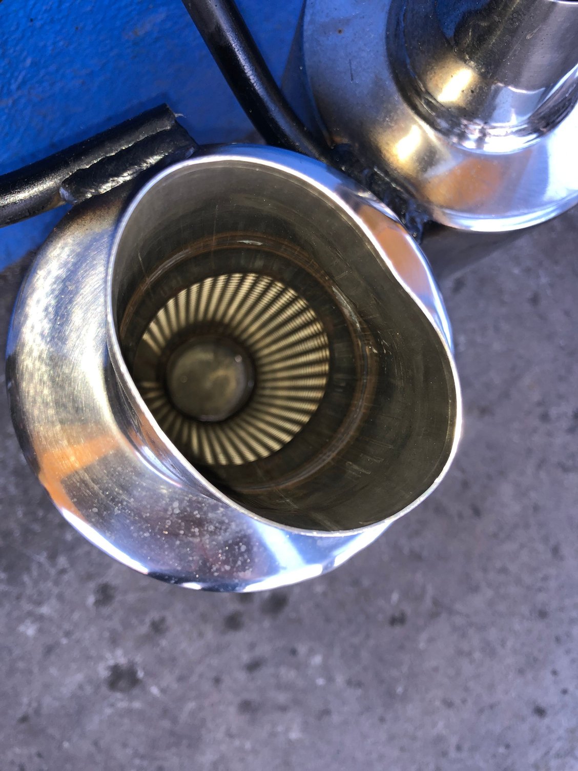

Double resonator delete process
Double muffler delete, straight pipe put in
the resonators
the mufflers

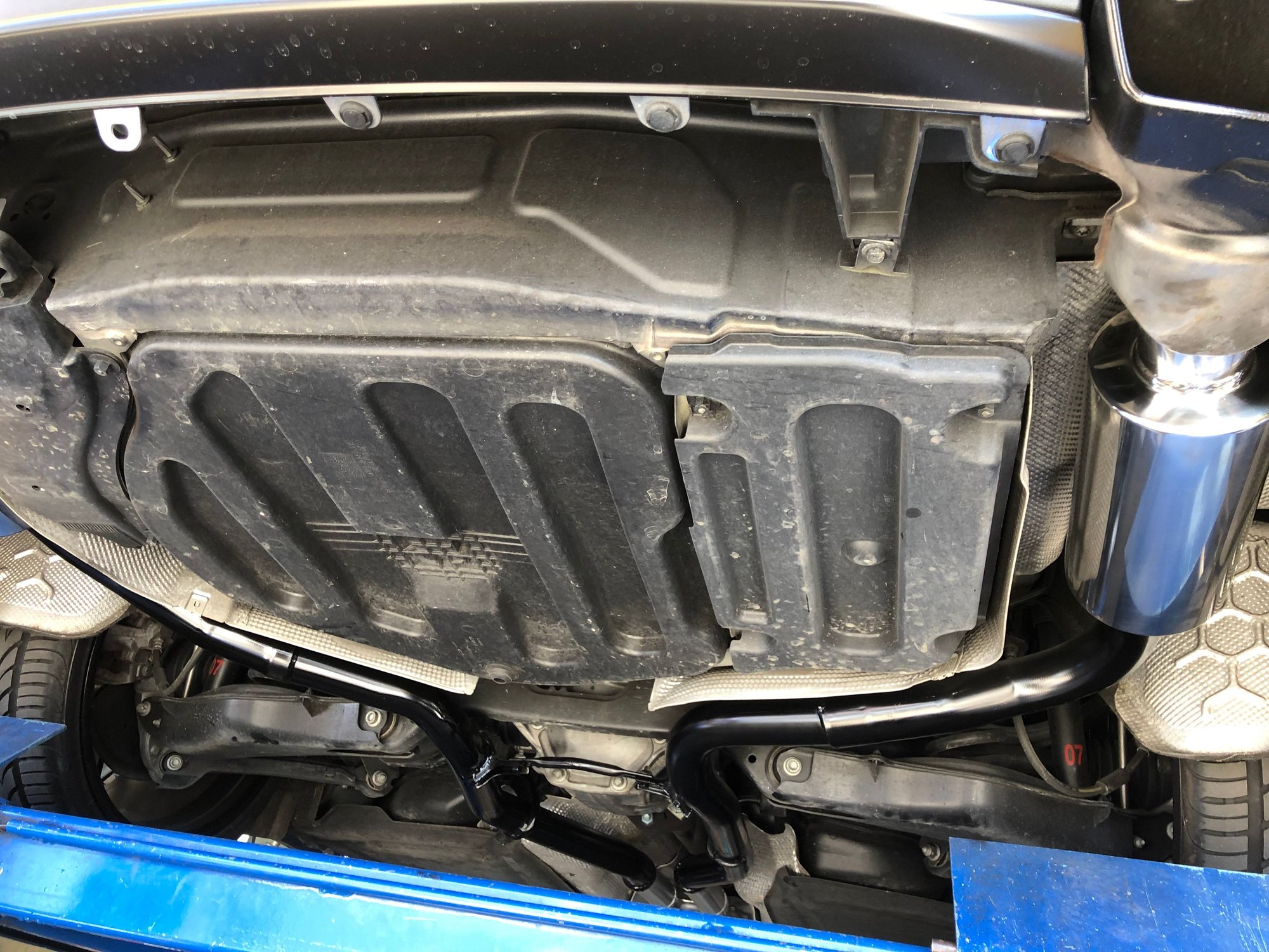

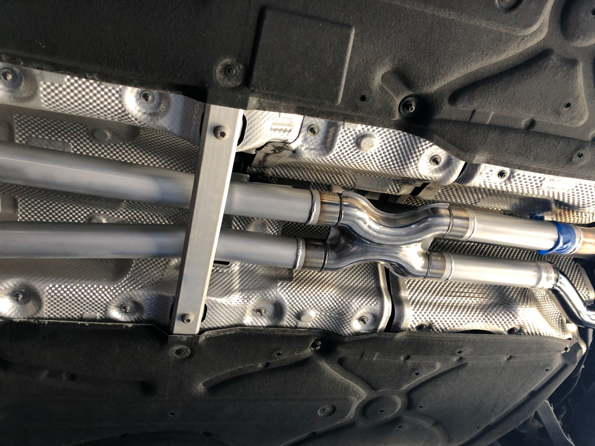

Just added an x-pipe and new mufflers; the sound is a lot less loud and deeper now. But I feel like now I can actually feel the droning. So I might need to change the mufflers or completely remove them. See:

Per their name, resonator(s) are designed to reduce/eliminate the resonance. "resonance is the tendency of a system to vibrate with increasing amplitudes at some frequencies of excitation. These are known as the system's resonant frequencies (or resonance frequencies). The resonator may have a fundamental frequency and any number of harmonics."
If you want to reduce the drone (resonance) then reinstall either the stock resonator or after market units. A good resonator will introduce very little back pressure.
