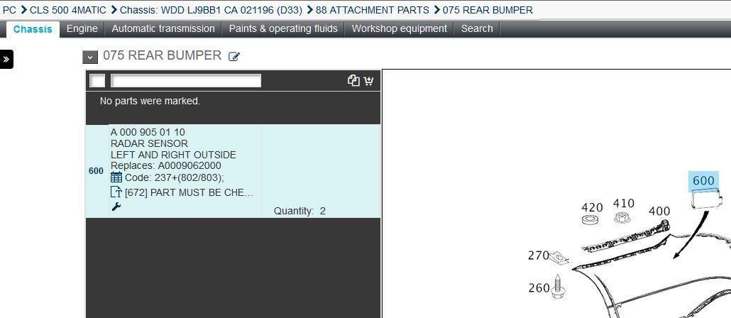

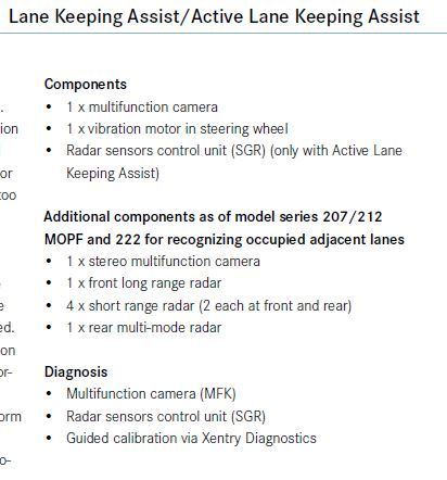

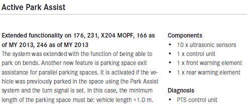

Nothing in outside mirrors. Here are all sensors. Find an independent to pull codes using MB diagnostics, reluctant to do so most common malfunction, rear bumper sensors.

My 2013 CLS550 is equipped with 997 Driver assistance package which includes 233, 237 & 238. It does NOT have parking
sensors, however, I'm wondering how it works if it doesn't have the parking sensors (front or rear).
Thanks, Marv

Basics:
233 front bumper radar sensors as shown above
237 rear bumper radar sensors
238 multifunction camera
