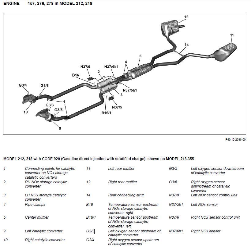

Hello,
Anyone replaced their bank 1, upstream o2 sensor? Any insight as to accessing it? Is it accessible from underneath the hood or under body?
Or does anyone have a schematic or link to such info?
Thank you!

Thank you. Looks as if I'll be accessing from underneath.

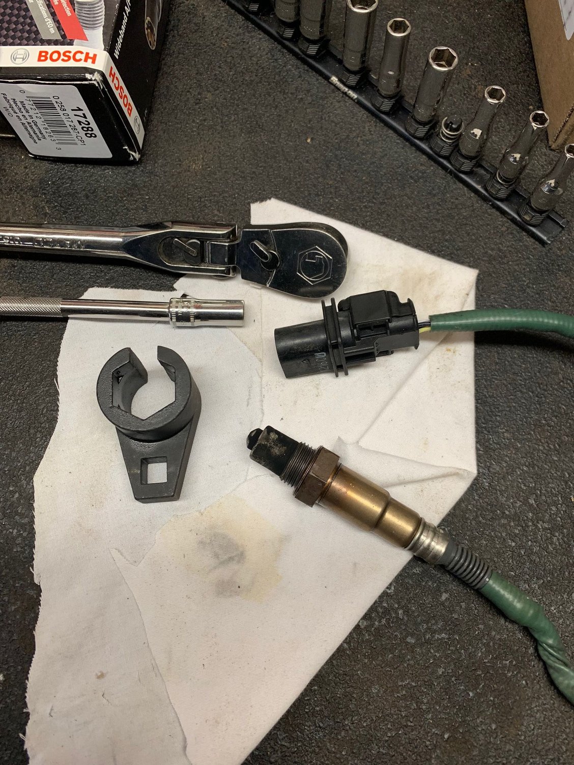

Just completed the install. You will need to jack the car up pretty high. Remove the middle under body plastic shroud, I think there are eight 8mm screws holding it in. I sprayed some liquid wrench on the sensor then removed the shroud to let it penetrate. I had to go under the front of the car, going from the side doesn't work
Aligning the socket wrench to the o2 socket was a little tricky but it broke loose pretty easily once I got it on. It was a $6 socket head from Rock Auto that was one of many suggested for this. It's pretty flush which I believe makes the job easier. The plug was about $50, which was the cheapest I could find even amongst mbpartsdirect etc.
The plug is affixed to the housing of the transmission. Remove the coupled plug out of the metal clips. Once out I had to lay flat on my back and reach up with both hands to release the plastic clip, there's very little slack. After that it was pretty straight forward for reinstall. Make sure to clean threads on exhaust, then finger tighten the sensor (do not plug in until it is completely tightened). Per Bosch do not over tighten as the heat will expand the metal/threads. No additional anti seize is required. Plug in new sensor. There are little grooves that the coupled connection slips onto on the metal bracket. Reinstall shroud.

Ahhh, so you used the flex head with that one. Ok. I was using the flex head wrench.
Did you have any clearance/space issue with the flex head? My O2 sensor was heavily tightened, so it took a lot more force to remove it. The lift was necessary in my case even after spraying WD40.
Removing the clips off the sensor deep in there was very uncomfortable for me as well haha. It started to frustrate me.
I'm glad you got it done quickly. I struggled for 2 days before I took it to my friend's shop haha. Thanks for the info tho!

There was certainly limited clearance with the wrench and I could see it being a challenge if the sensor was really tight. I spent the most time trying to deal with the clips as well. I had to stop and take a break but once I got both hands up there it was manageable, just the learning curve of it I guess. In the future if I had to do it again I think it would be an hour job or so, so long as the sensor is not welded to the pipe like in your instance! Bummer it took so long. I have had that happen on other projects, like my wife's audi allroad brakes....
