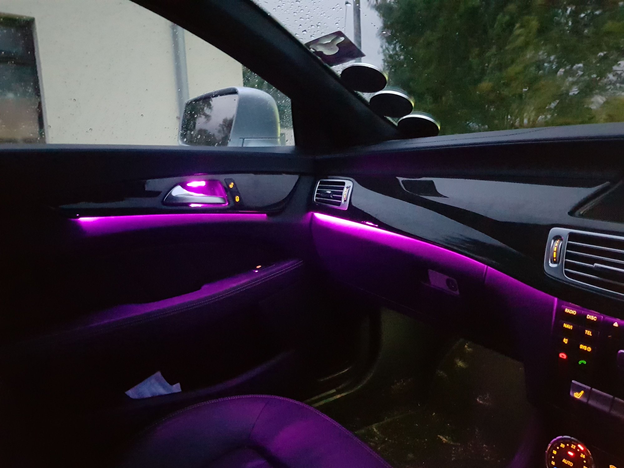

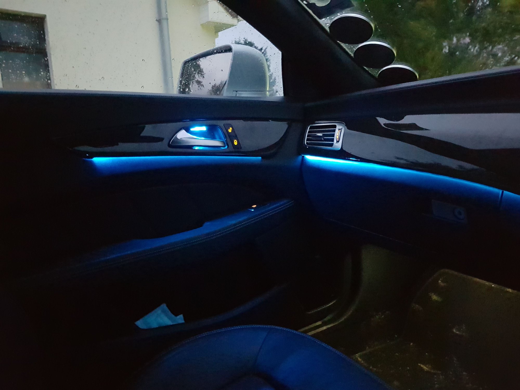

I didn't have ambient lighting so decided to upgrade to 12 colour led ambient light

Old Aug 24, 2020 | 02:13 PM
hyperion667's Avatar
Posts: 31,273
Likes: 3,916
From: on my way
2012 CLS63
Oh man that green!

Old Aug 24, 2020 | 03:00 PM
Tony MYMB's Avatar
Joined: Sep 2019
Posts: 38
Likes: 14
From: UK
A207
Nice Green is very cool
Old Aug 24, 2020 | 03:53 PM
Suppaa Mario's Avatar
Joined: Feb 2018
Posts: 311
Likes: 37
CLS 550
Love it, how difficult was it?

I bought it through Facebook messenger, guy called kerdi liang (search his Facebook page). I know DMP car design do a 32 colour version as well.
Difficulty is not massive but very time consuming. I sound dampened all the doors as well which slowed me down. Let me know of your doing it and I can send you the PDF instructions

Is it just me or does this lighting is brighter than stock lighting?
This looks so cool. I might be interested in it if the price is right.

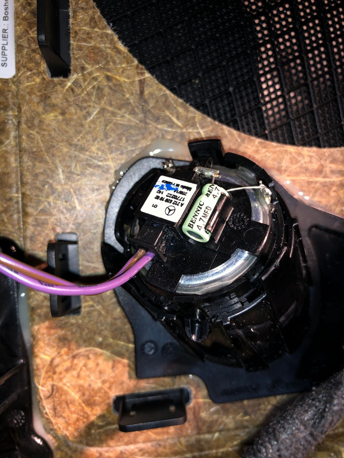

Question, this purple/orange wire plug isn’t comimg out and there isn’t any type of push clip to un-secure it. I pulled pretty hard but I also didn’t wanna break it because idk of pulling it off is the right way to do it. It’s the last thing I need to do to separate the door panel from the door.

Removal shown on 211, same connector (@ 1:05).

From: Framingham, MA
2016 CLS 400 4Matic
Definitely much brighter than stock. I find stock to be very subtle—nowhere near this intensity.
