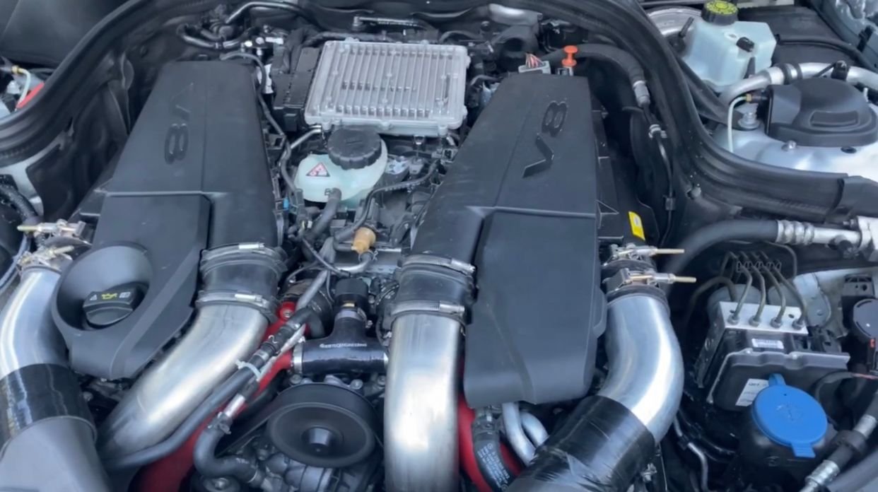

Weistec Asv and charge pipes
Weistec Filters
VRP cold air intake

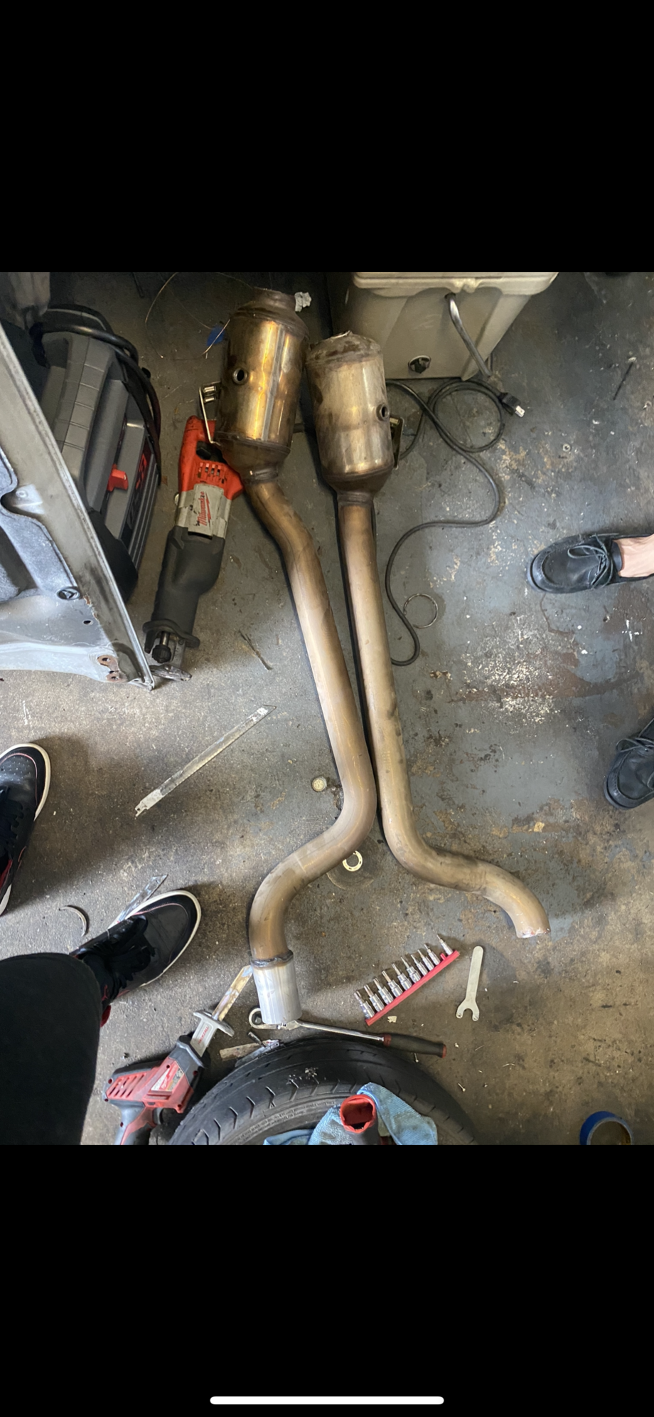

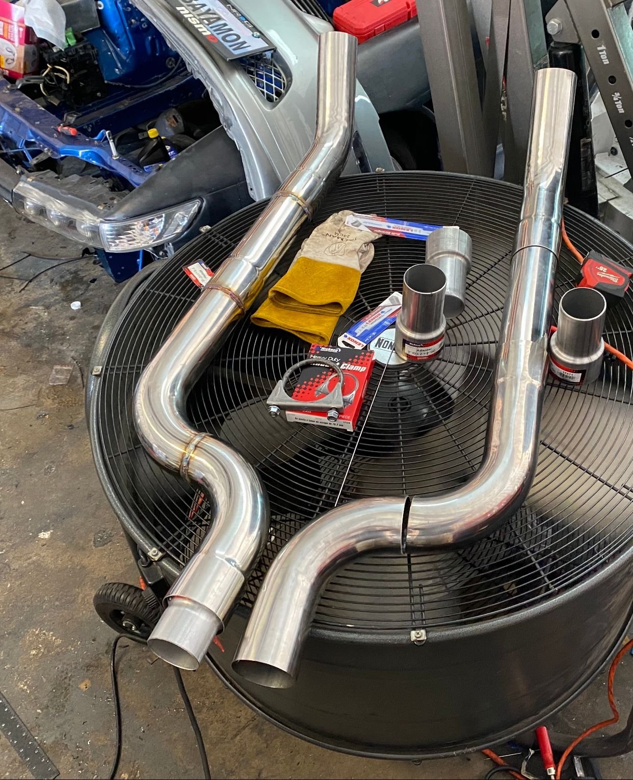

Custom 3 inch downpipes straight until stock mufflers
Had asv and charge pipes , Filters, and intake installed first and no issues with that. The charge pipes were tough to get in because it’s so tight up there in the front, either way all that was pretty smooth and then I wanted to do downpipes before I tuned.
The downpipes were installed but there was a leak in the exhaust where the fabricator had to add rest of pipe and was causing a ton of drivability issues Multiple CEL for faulty o2 and lean CEL and eventually random misfire. I was trying to figure out what the issue was and didn’t think a leak in exhaust was causing it but sure enough I took the car to Jerrysmb in Oviedo, Fl to have new spark plugs Installed and what I think is really cool is I asked them if they could replace all o2 sensors and coil packs and they said no no no, just seal up the exhaust first. They could of got me for an easy 1000 or so and didn’t so I really respect that, and they have a lifetime customer. Anyway fixed exhaust and all CELs gone after about 20 miles after exhaust was sealed. Now it was time to install the tune.

Btw. Is your IC coolant reservoir low, or just looks like it? Maybe the liquid there is just that colour that can't be seen good on that picture.

I had my buddies from the fabricator shop do the downpipes and asv and charge pipes. They have a little shop in winter park/Orlando area and got the connect for the dyno at titan motorsports.

yes it was low, you gotta good eye, lol. I had a leak out of the reserve tank which was replaced pretty much same time as the photo was taken.

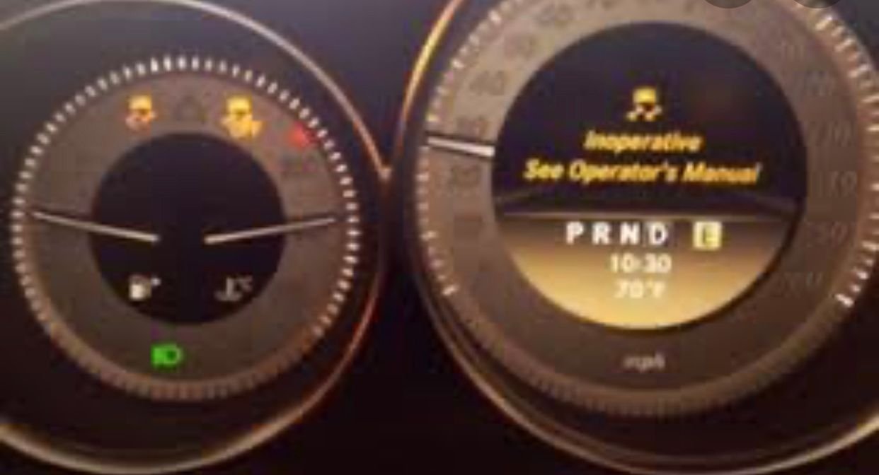

Do you run with ESP off to break wheels? My traction control will literally cut power if it thinks I'm about to spin. I have to launch and use power slowly.

I had an issue everytime I went to do a launch, I’d get this Message on my dash, actually got this Same message when shifting aggressively like 2 other times in traffic and car goes into limp mode even threw a CEL for turbo under boost on the third failed launch attempt? Weird I’ve never had that CEL before but also never attempted to launch with esp off 3 consecutive times, failing at each attempt either.
I sent Weistec an email that night with a description of what happened that evening and they sent me a new file In the morning and I’ve tried to launch a few times and so far so good. Ive got a video but I’m still learning how to launch but so far have not had that come on at all while driving or trying to launch. Here’s one pull but I’m definitely still trying to learn how to launch effectively.

There is really not so much to do on launch, because TCU is limiting power in 1-2 gears, maybe some on 3 gear also.( Closing throttle blade, limiting boost etc.) Maybe like 0,2-0,3s off 1/4 mile time and 0-60mph time. Buy a TCU tune and let us know how good it will work on our M278 platform.
