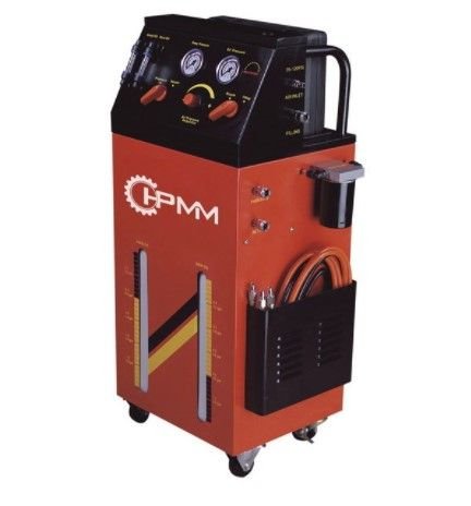

This is what we use here i europe to change oil in automatic transmisions...you need to flush your tranny first an then fill it with clean oil. you need twice
much oil then...I paid for my cls 330 dollars
