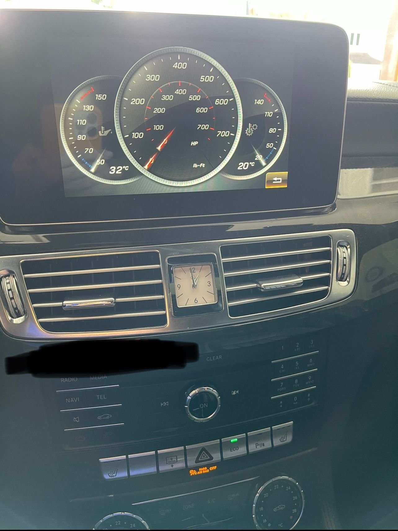

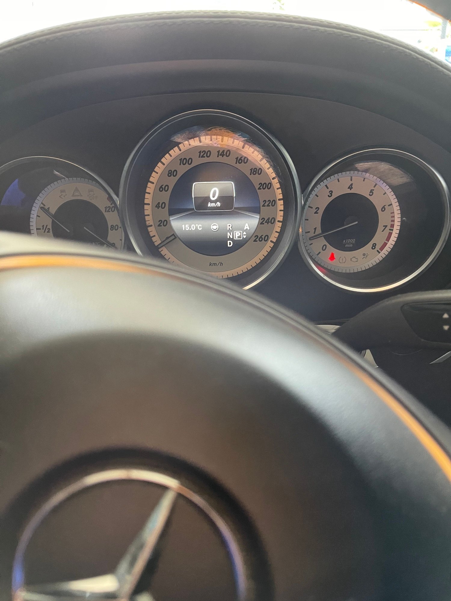

I decided to get remote services done by Mbhouse, and 2/3 were partially completed today. I ordered A mode, which is exactly the same as sport+ in the coding itself, but it just shows as A due to the instrument cluster. The second thing I ordered was digital gauges, to display the horsepower/torque numbers, oil temperature, and coolant temperature.
We spent about an hour today, and it was partially completed, the A mode just needs to be coded to start in gear 1 instead of gear 2 which will be done tomorrow, and the gauges currently do not move because the COMAND's software is older, which will be updated tomorrow to make it work. The way this is done remotely is they ship a device called OpenPort 2.0, you connect it to your OBD port, and via USB to your laptop. It is Mac friendly, and they use a program called FlexiHub, which allows them to access OpenPort remotely, which is connected to your laptop. You leave your ignition in position 2, which shows all the lights. They'll text you when to start the engine, put it into drive, etc. All you have to do is just wait for the texts, and they do all of the work. You do have to book an appointment, and I got mine the following day after receiving the device in the mail. It's a super easy process, you don't even need to be good with computers or anything.

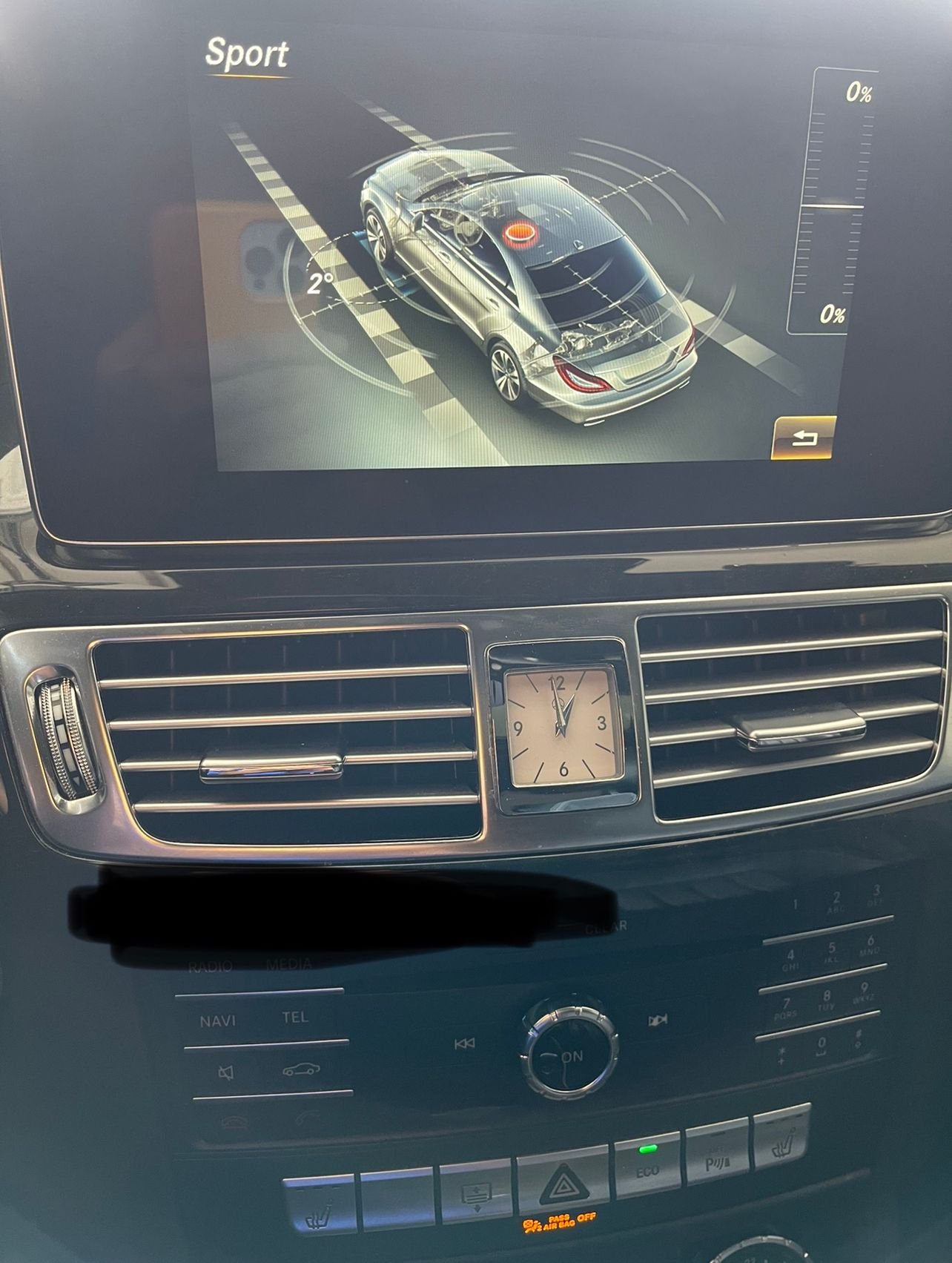

They coded in A mode? If your vehicle is a 2016, it's highly likely that you have the driving dynamics->Engine Data/Vehicle Data screens. Where are you located? I don't think any dealer is willing to code in the multi beams. I'm in Canada and I'm not sure if the regulations allow it yet. Somebody made a video on how to enable the multi-beams in North America using the program Vediamo.
Also an update here for my situation: A mode is not perfected yet, and the gauges do not work. This is due to my vehicle needing an ECU update, so that the numbers can be sent to the screen when I press on the throttle. I've been refunded as it's been over a month and still have both A mode (which I don't use as it's not sport+ yet), and the gauges. They said they would contact me once they have the ECU update file ready for my vehicle. I am hoping that they can code in custom numbers for the HP/TQ that reflect my tune, as even with my tune, the screen would only show stock numbers (someone made a YouTube video on this). At least I can see the oil temperature and transmission oil temperature which work.

They added carplay (without changing the faceplate in the armrest) and after that, I had all of those screens that you posted and all of the gauges work. No charge...but I am pretty close with all the guys in the service department. I am in BC. I'm trying to give them all the info for the multibeam activation so they can try it out. I just told them that the sales rep told me they would activate when legal in Canada...which he did.

Are you in the Lower Mainland? The gauges screen is cool as it displays oil temperature and transmission oil temperature. When I went for my CarPlay update (4 months after my factory warranty expired), they only updated the COMAND unit to have this working. I did not get the Driving Dynamics menu that shows engine and vehicle data.
