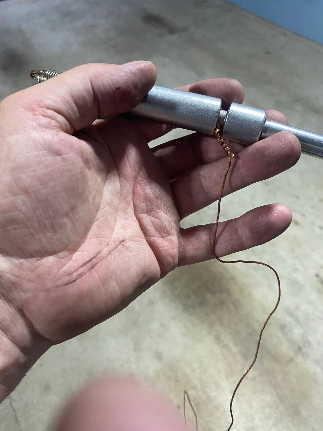

For those contemplating, call your mechanic! If you do undertake this task, use the swivel socket and make sure to wrap a wire around it so you can retrieve it after torquing the plug
