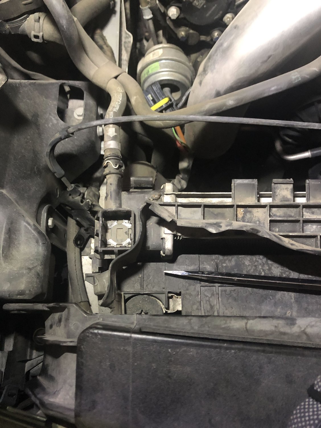

Remove the bumper?!
Hello everyone, I have the new AC compressor in and the high and low pressure lines reconnected. Before I replace the serpentine belt, I thought I'd remove and replace the desicant cartridge, but it appears I have to remove the front bumper to change it? I must be wrong about this...here's a pic:
Desicant Cartridge for AC
The cartridge is (I believe) the large circular star torx blocked by the front bumper near the screwdriver -- is there a way to NOT remove the entire front bumper?

Access?
I actually now have access by loosening the top of the bumper and carefully prying the radiator inward. However, it appears I now need a proprietary Mercedes desiccant cartridge removal tool? Seriously?
