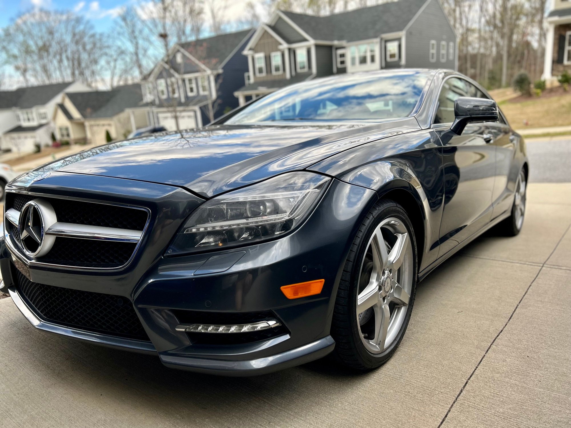

Hello everyone, figured I’d put together a short build thread just to keep track of what I’ve done.
starting off I have a 2014 CLS550 finished in steel grey metallic with around 75k miles.
pics right after I brought it home.

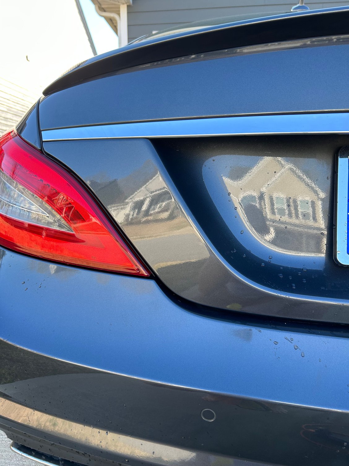

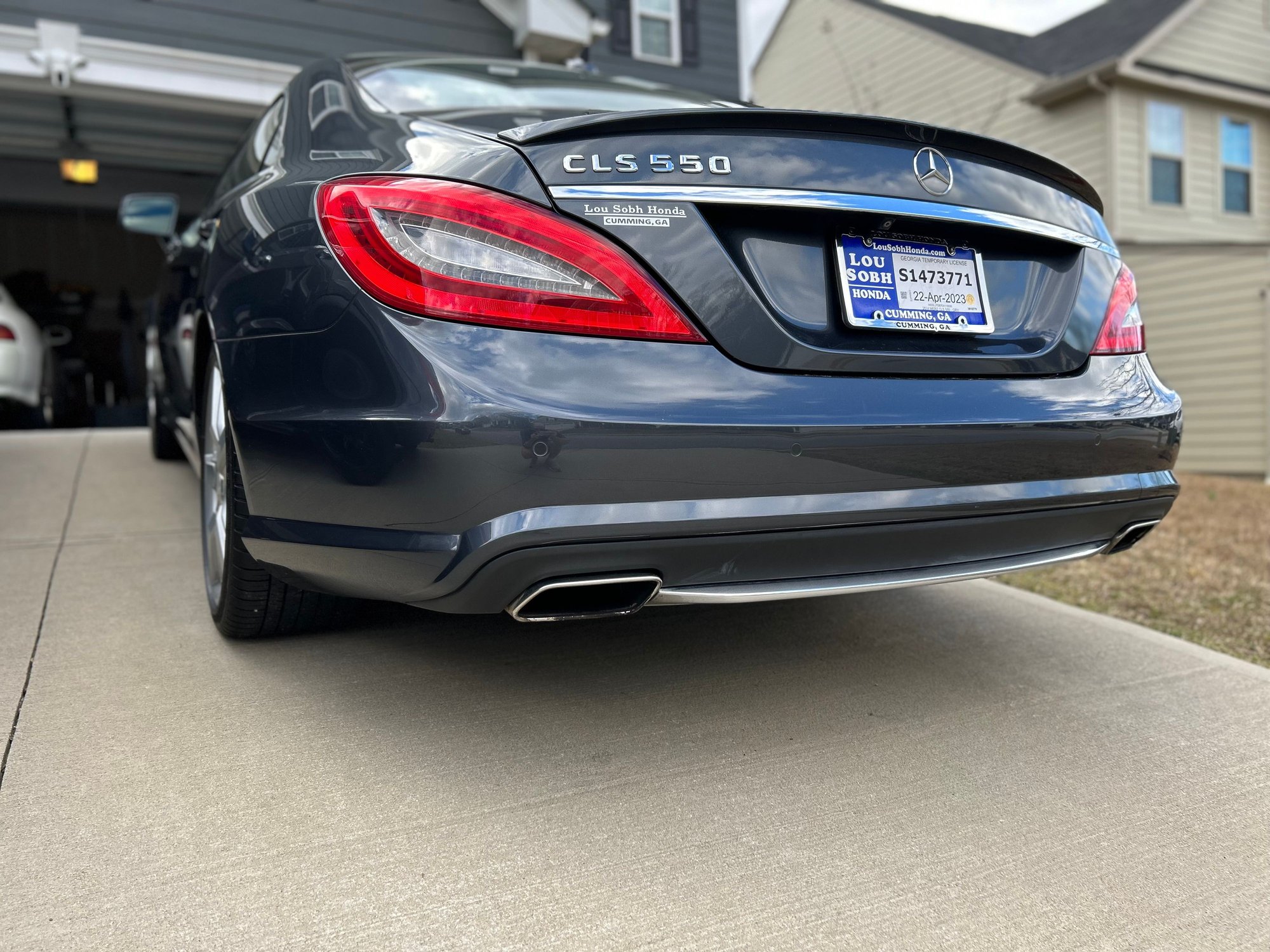

So the first two mods I did were a rear debadge and adding the ECS air intake filters.
i have a thread started from that, found here:
https://mbworld.org/forums/cls-coupe...r-filters.html

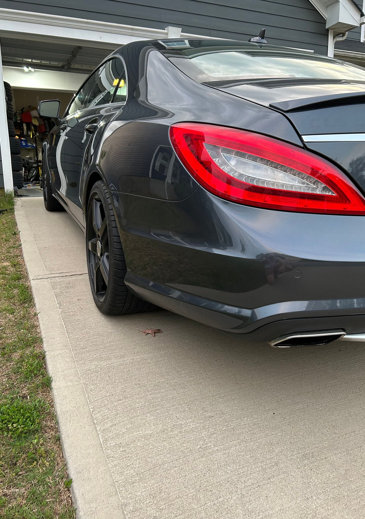

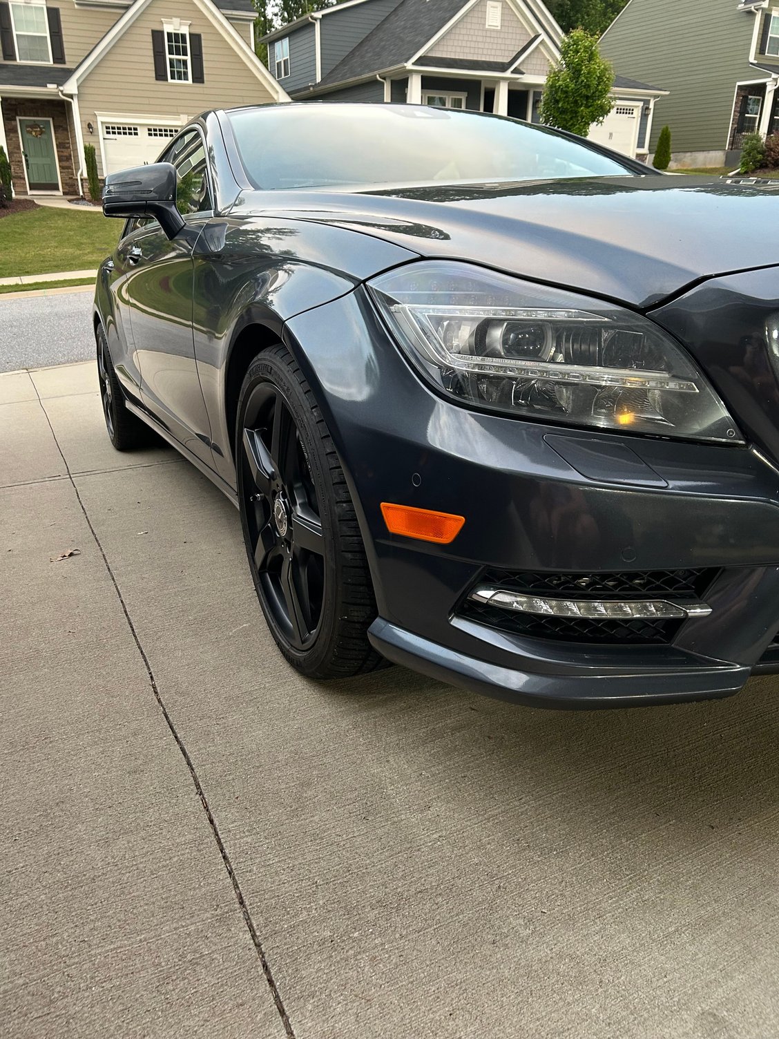

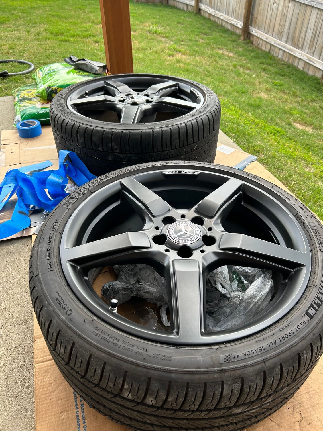

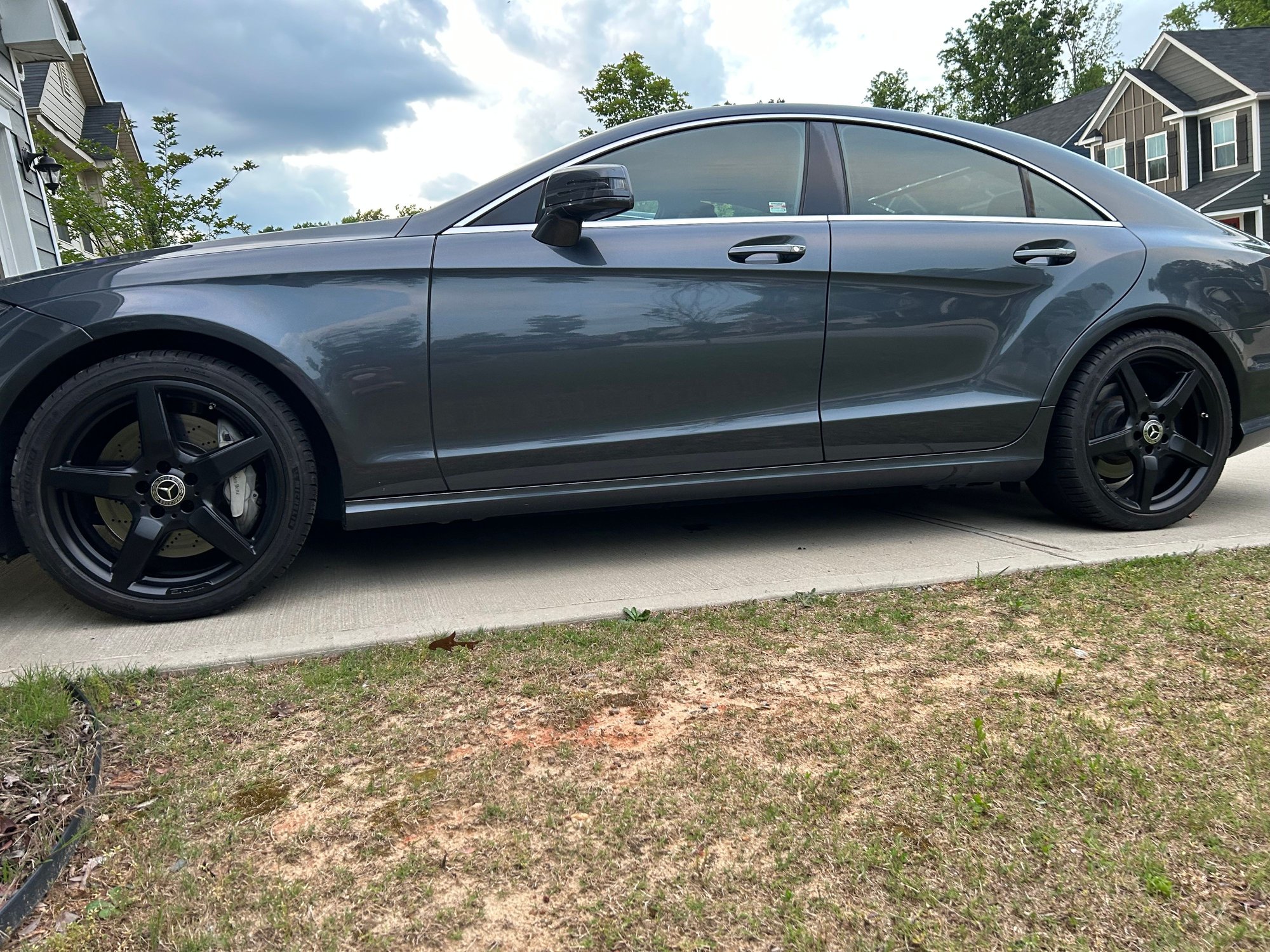

This past weekend I decided to paint my wheels and out my wheel spacers on.
For the spacers I used:
Front: H&R (20556659) 10mm spacers with 40mm bolts (1454002SW)
Rear: StanceMagic 20mm spacers with OEM style GLK bolts (47mm length), (SKP SK9907607) from RockAuto
i painted the wheels Satin Black with a Matte Clear coat, turned out very well and the overall stance looks much better.
I put some black and silver wheel caps on to finish it off.
Overall I’m very happy with the results.
New wheel caps

for the debadging, the goal is to heat up the emblems enough that the adhesive holding them on becomes loose. I have a heat gun or during some hot summer temps when the emblems have some flex works. Use dental floss to cut the adhesive holding it on. There will still probably be some residual adhesive on the car. then carefully use your finger or a razor blade and some goo gone (Necessary) to get the remaining adhesive off. Then wash that area and polish and wax it. Pretty straightforward.

Where did you get the wheel paint?
Old May 18, 2023 | 03:45 PM
AceVL's Avatar
Joined: Jul 2021
Posts: 35
Likes: 14
CLS550
its Duplicolor wheel paint. Satin black. You can get it at any auto parts store. Did 3-4 coats of that than 2 coats of the Duplicolor matte clear coat.
