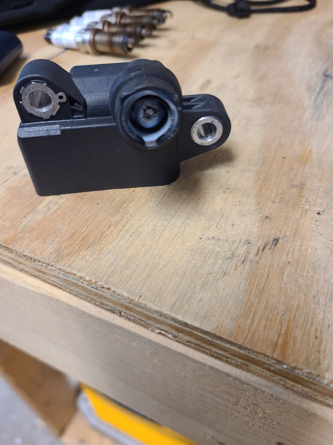

Started out replacing the plugs with new OE Bosch. Started with #1 (front, passenger side). The spark plug wires/boots are part of the coil assembly, they cannot be separated/removed from the coil. The coils/boots are tough to get out without just yanking on the coil - which may cause stress/separation of the boot/wire from the coil. The boots have a hard plastic sheath. I used long needle nose pliers to reach down and grab ahold of the lip of the sheath and pull, which worked well. Toughest one on the passenger side is #4, the rear most. Also challenging is you cannot see or touch a single bit of the spark plug. Was concerned about cross-threading the new plugs so I used a short piece, maybe 12", of 3/8" rubber fuel line. The fuel line slips tightly over the spark plug ceramic insulator and allows you to change the angle a bit while turning it your hand until it threads in, then just pull the hose off and finish tightening with whatever assortment of rachet/extensions/flex joints/spark plug socket you need. The hose worked well.
On to the drivers side. Could see the drivers side rear (#8) was going to be a PITA, worse than #4, and it was. Removed the 2 bolts holding the coil body and, surprise, the coil body lifted right off but left the boot on the plug (clearly this was the reason for the engine miss) Some combination of heat and corrosion caused the spark plug wire connection at the coil to fail. The photos show he corrosion in the coil where the plug wire attaches, and the top of the wire/boot (still attached to the plug. The hard plastic sheath was brittle and basically just broke apart when grabbing the lip, I had to grab what was left of the body with the long needle nose plies which, thankfully, worked. Then used compressed air to blow out any bits before removing the old plug. Back to the parts store for a new coil. Rest of the drivers side went fine. I lined up all plugs, keeping track of where they came from, to compare color at the tips. #8 was slightly different from the others, further confirming #8 was mis-firing. Off to the parts store for a new coil, and the rest of the drivers side went fine, though still difficult due to lack of space.
