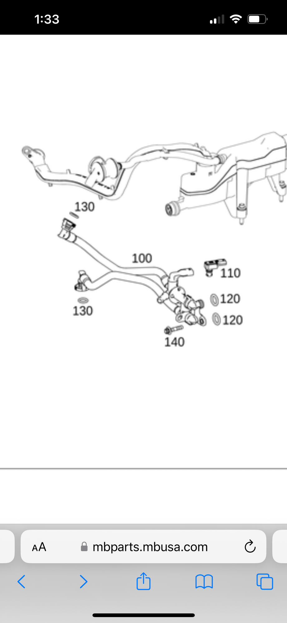

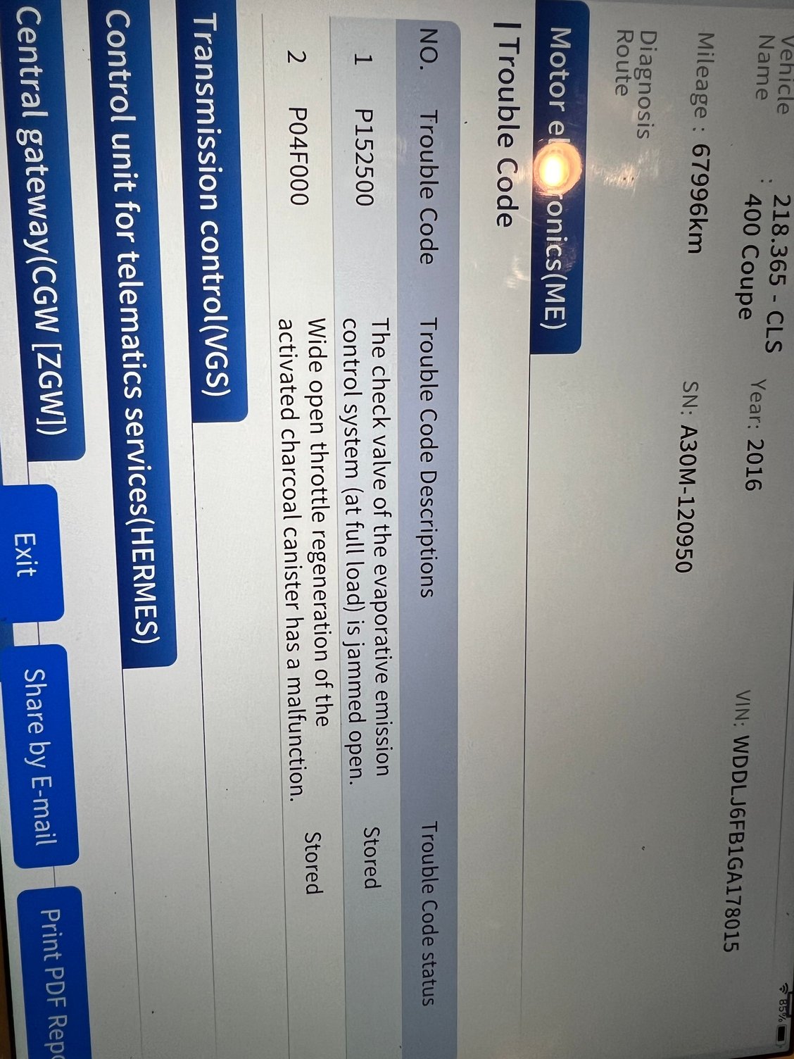

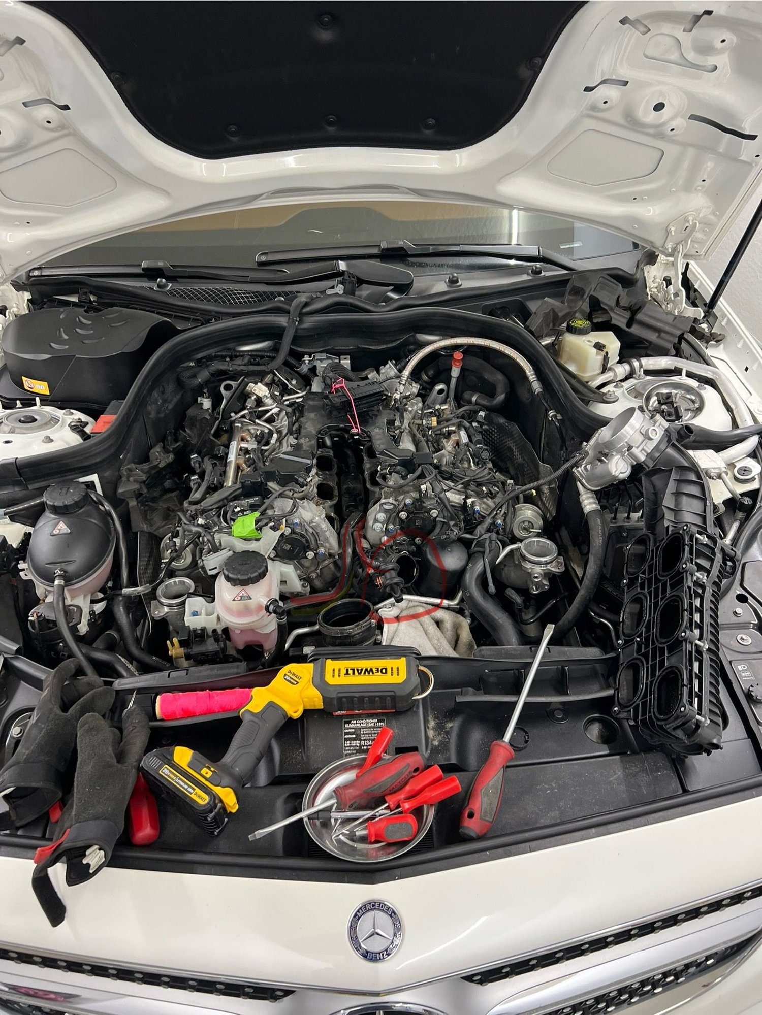

I am fixing a similar problem now although on an oem intake on a cls400. I replaced the high flow check valve assembly and now am doing the assembly to the air/oil separator under the intake as this routes to the check valve next to intake.
