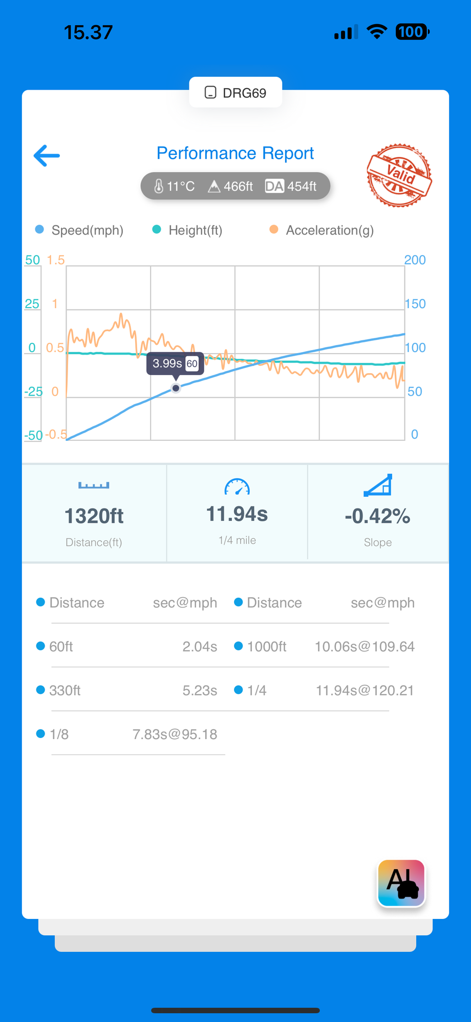

Hi. I might said this before but if that "track time" 13.1 and 108 trap is 1/4 mile time and trap, it's way slower it should be. Back in the day with stock turbos and pump gasoline my shooting brake did go 11.94s and 120 mph trap according to Dragy. Or was your car stock then? Still might be slow.
Also if your max boost with tune is 12.5 psi =0,862 baaria its low.
There is something wrong and holding your car to get the wanted power out.

Okey, I did get confused what time and boost is with tune and what is not. If you are happy with those times and boost everything is good.
I will post later that Dragy shot 11,94s and 120mph what I did get with stock turbos (shooting brake about 0,1s slower than coupe)

PekkaH's Avatar
Joined: Jun 2020
Posts: 417
Likes: 182
From: Finland
2015 CLS550 Shooting brake 4-matic

Originally Posted by JQmile
Yeah that sucker is rolling.....what type of fuel were you on? The most boost I've heard of on stock turbos is around 20psi on E50. Pretty sure 91 octane is my limiting factor right now. Car has been 12.50 at 112.5 tuned but I think it could go 20s or 30s.
Just straight pump gasoline, no meth, full weight. My tuner have done great job.
