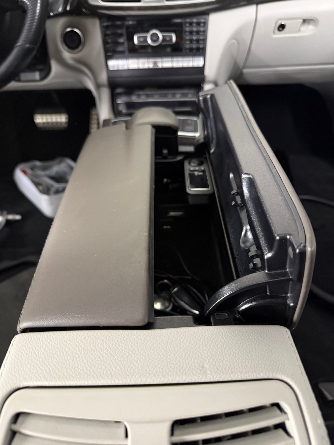

I see you have the ESM button like the amgs do, did you get it to program to stay in whichever mode after shut off like they do too? Also the exhaust valve button looks dope but if you have any charger/radar detector wires coming through from the 12v port opening that every time might be a pain

Yes, I coded the ESM to remember the last position before ignition off — fairly straightforward to do.
Good point about the 12V port — I didn’t have an actual glove box available at the moment to check that. I’ll need to look into it and possibly relocate it to a better position. Thanks for pointing it out 👍

Just checked it — the button won’t interfere with the 12V port after all. It will sit closer to the media interface port, but that’s not an issue for me since I’ve disabled it to use AUX for my aftermarket wireless CarPlay module. Thanks again for pointing it out.

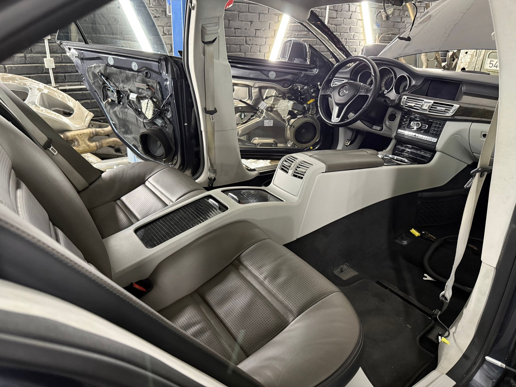

Interior is slowly coming back together — everything that could be reinstalled at this stage is now back in. Still waiting on the upholstery shop to finish the seats, pillars, headliner and the remaining pieces. The black carpet paired with the Alpaca gray interior turned out really well in my opinion. The contrast sure makes the whole cabin a lot nicer.
Also worked on a revised mockup of the center console section. The new design integrates both the exhaust flap control and the Snow Performance meth controller into one unit. Still in the prototype stage, but the layout and positioning are now where I want them.

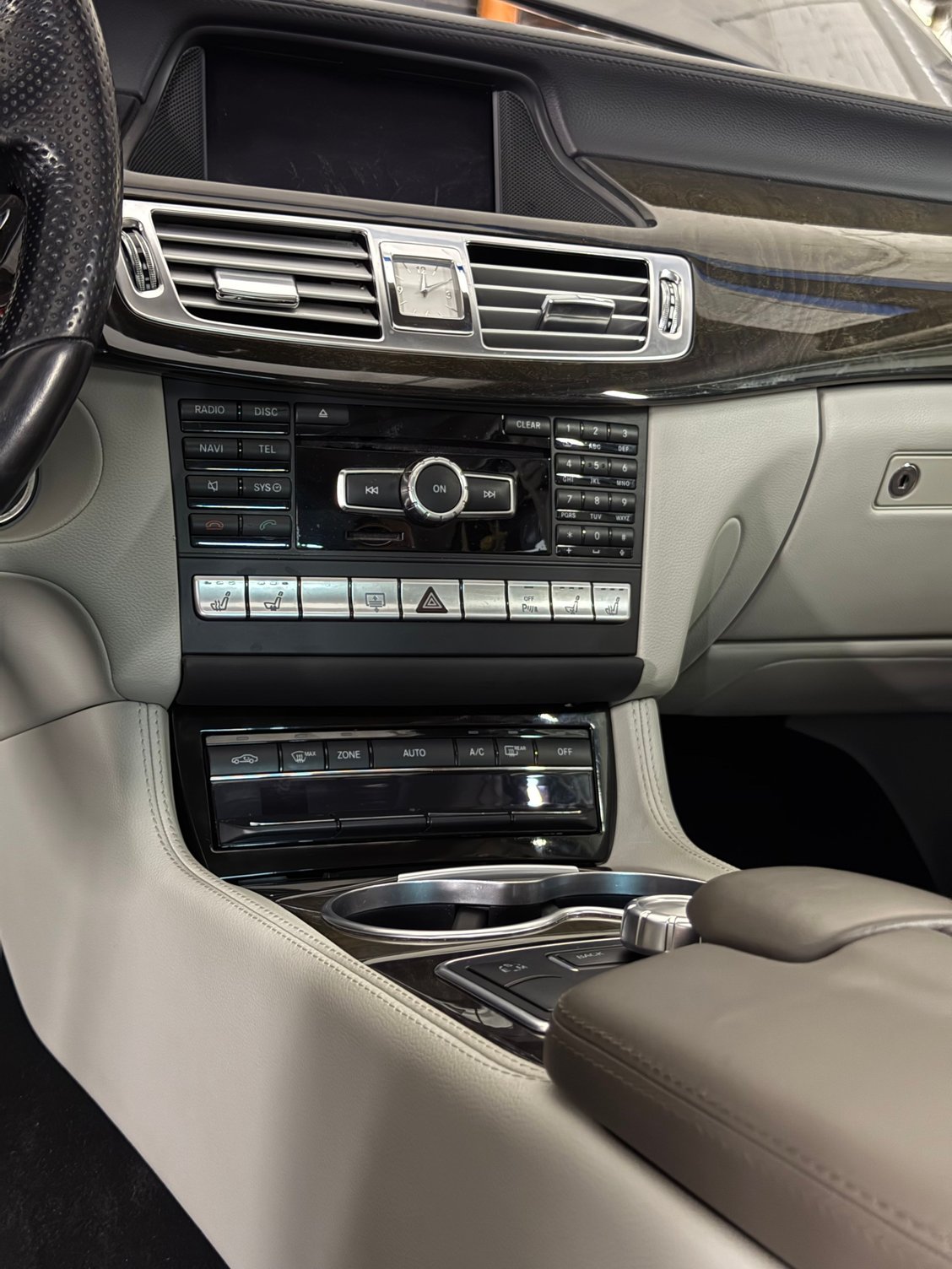

M278 CLS550 performance build – OEM+ console integration
Managed to finish the exhaust flap control / Snow Performance methanol controller pod this weekend. The design integrates both into a single unit mounted to the center console, keeping everything contained and OEM+ in appearance. Fitment turned out exactly how I wanted — it clears all USB and multimedia ports inside the armrest without any interference. This was iterated a few times to get the positioning, mounting and overall proportions right, but the final result sits naturally within the console lines and doesn’t feel like an add-on. Wiring will be fully enclosed within the structure, so everything stays protected and hidden once installed.
I guess I can finally call this part done and be happy with how it turned out 🙂

I was more so referring to the opening/closing the hatch every time you wanna toggle it. I have my radar detector and phone cables coming out throught the dedicated cable channels at the front of the box by the lever and without fail they get in the way of it shutting properly every single time. Might be inconvenient for frequent on/off presses, but assuming you're probably gonna keep it on or off depending on the drive it might not be that big of a deal. Your solution looks elegant and that interior is HOT!
also I haven't figured out what that media interface port is for or anything compatable I have (iirc the sd card reader is on the dash, so not that?) but now I want to try again.

Oh I see now. Opening the hatch isn't going to be an issue -- I'll mostly drive the car semi-silently anyway. Thanks for the compliments!
Regarding the media interface and sd card reader -- I would recommend getting a CarPlay box from someone like https://www.mr12volt.com/collections...em-mic-support instead. I have a Chinese one that doesn't support MOST bus. I wish I wish I would've known about the other one when I made my order

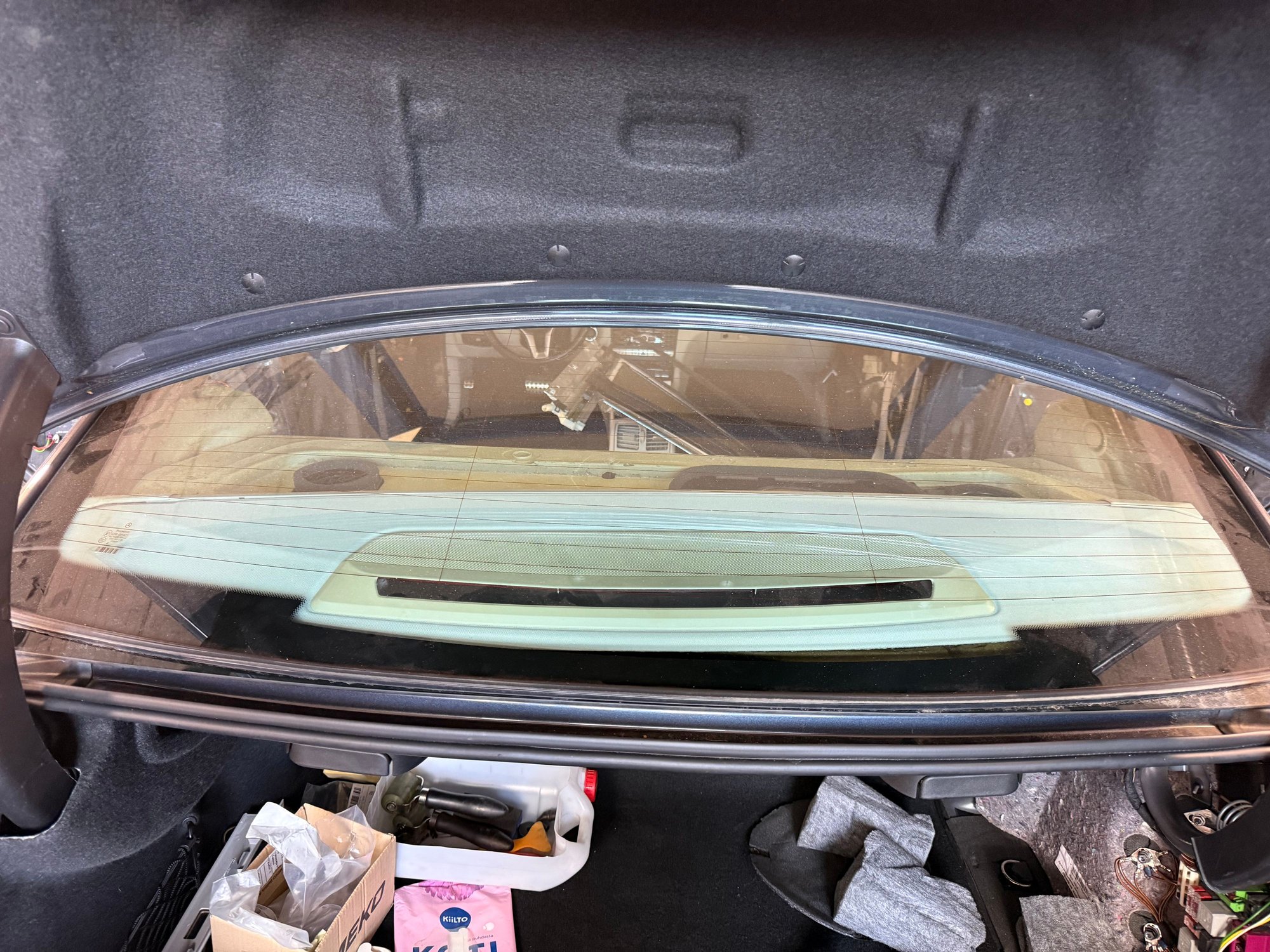

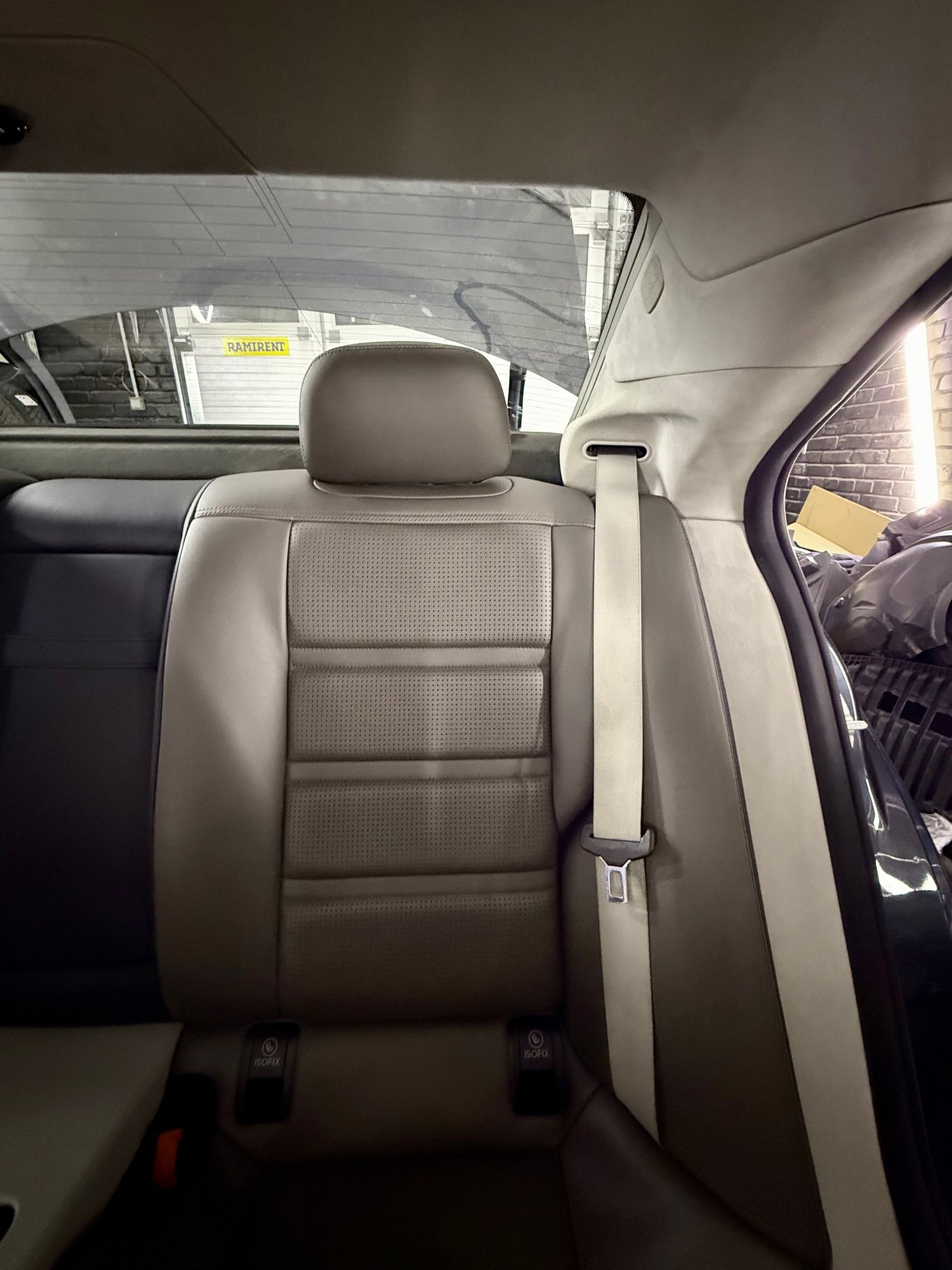

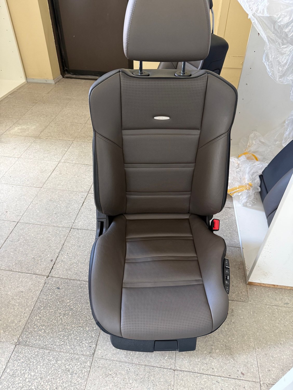

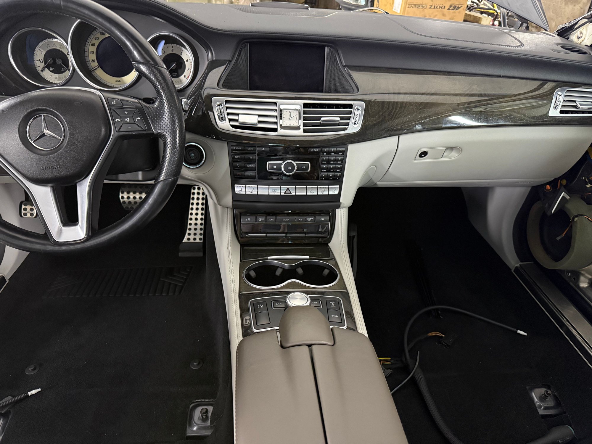

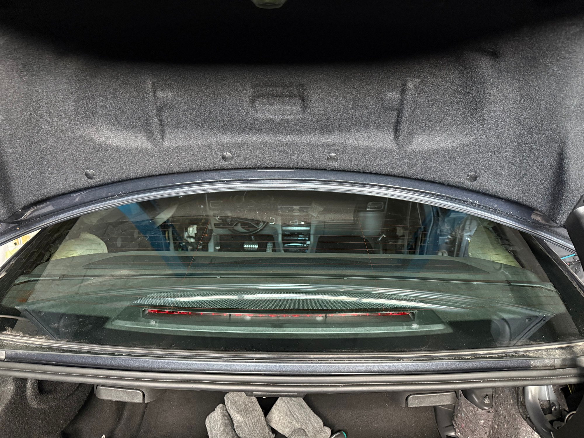

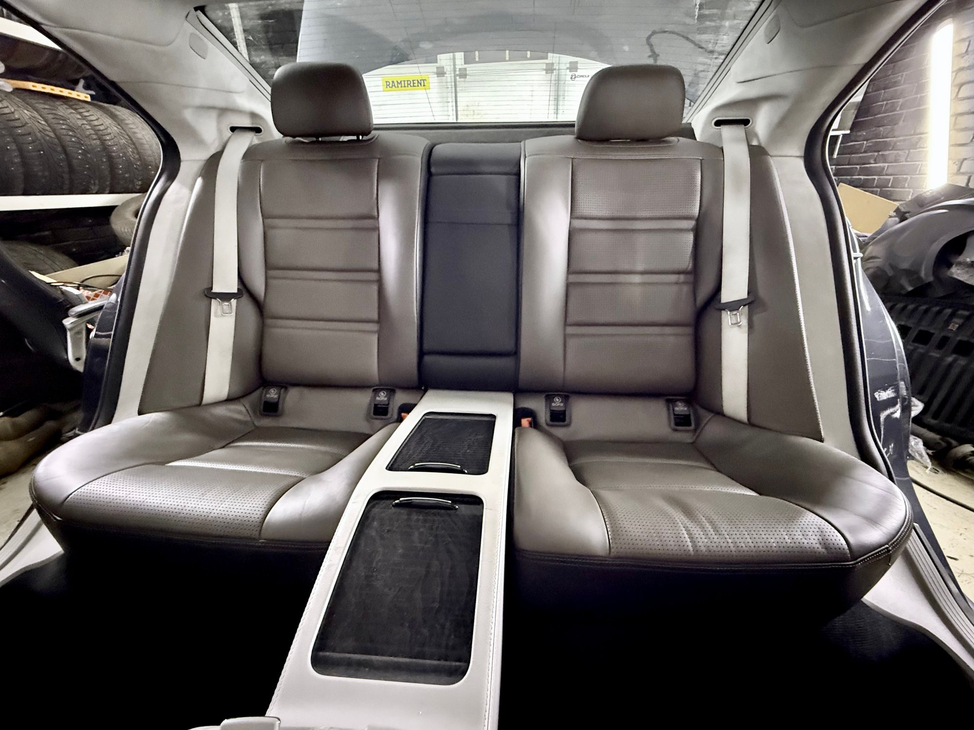

CLS550 Interior Refresh – Alcantara Headliner, Rear Shelf & Seat Rejuvenation
The interior is finally coming back together.
The upholstery shop has now finished the main work, and I’ve installed the most time-consuming part of it back into the car.
The seats and center armrest were rejuvenated, while the pillars, headliner components and rear shelf were all retrimmed in alcantara.
The seats still have some creases left, but a complete rebuild wasn’t really the goal here — I mainly wanted to refresh everything while keeping the original character of the interior intact.
One of the biggest visual improvements from the outside is the rear shelf area. The old yellowed white shelf always bothered me. The difference after retrimming it is much larger than I expected.
A lot of work for details that most people probably won’t notice immediately, but it completely changes the atmosphere inside the car.

Finished putting the center console back together and the interior is finally starting to look complete again instead of being permanently half-disassembled.
Really happy with how the color combination and materials came together in the end. Still a lot of small things left to finish, but it’s finally getting there.
Also finished retrofitting the digital HVAC control panel from the W212. The CLS was never available with this panel from factory, so it required a custom frame to make it work properly. It’s very close now, but I still need to make a few small adjustments before it fits and snaps into the dashboard perfectly.
Also very happy with how the trim section between the upper switch panel and the climate control panel turned out in black nappa leather instead of the original alpaca gray vinyl. It ties the center stack together much better visually.
