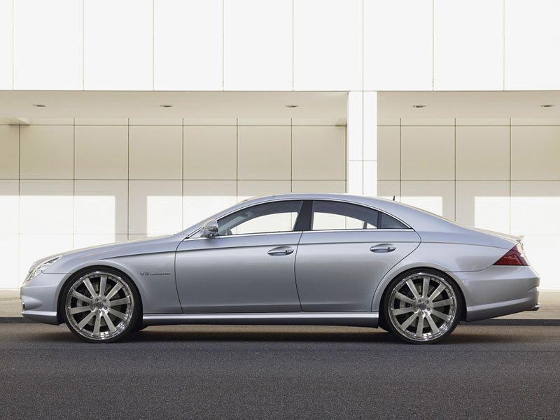

I am looking for new rims for my cls and so far there are not too many options since the car is a new model and I was told the rims had to be 3 piece rims to work correctly on the car without damaging the suspension.
Does anyone know if that is true? Also any suggestions on places to get rims from online or in Chicago. I am interested in the rims in the picture

That is absolutely NOT true. It sounds from a salesman... All CLS stock wheels so far are 1 piece.

Smell a bit of BS from the salesman. Chrome stock wheels here and they seem like 1 piece to me. No suspension, handling,balance or air pressure loss problems.
Check the CLS55 section "Chromed Factory Rims",there are some pics of the AMG chrome wheels.

how many pieces a wheel is has nothing to do with its fit. All that has to do with fit is size and offset.

1-piece, 2-piece, and 3-piece wheels will all be fine on a CLS. I think 19's would be ideal with 245/35R19 FA & 285/30R19 RA. 20's max with 245/30R20 & 285/25R20 but you'll sacrifice some ride quality and you'll really have to watch out for those potholes. I've weighed silver and chrome versions of the same wheel and the weight difference really isn't that drastic. A heavy chrome wheel would still be a heavy silver wheel prior to plating. AMG2GO is correct in that the key factor is size (diameter, width, & proper tire size) as well as offset.
In the Chicago area try Jerry or Gabriel at Lee's Foreign.
