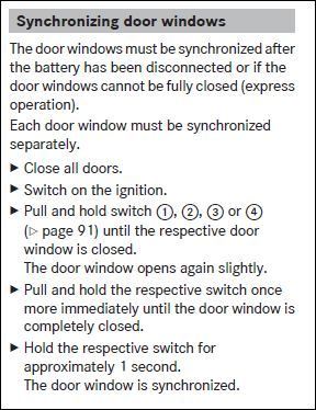

Synchronize affected window if this fails you will need someone with Xentry (MB diagnostics) to erase stored codes and initialize or re-buffer basic data.
