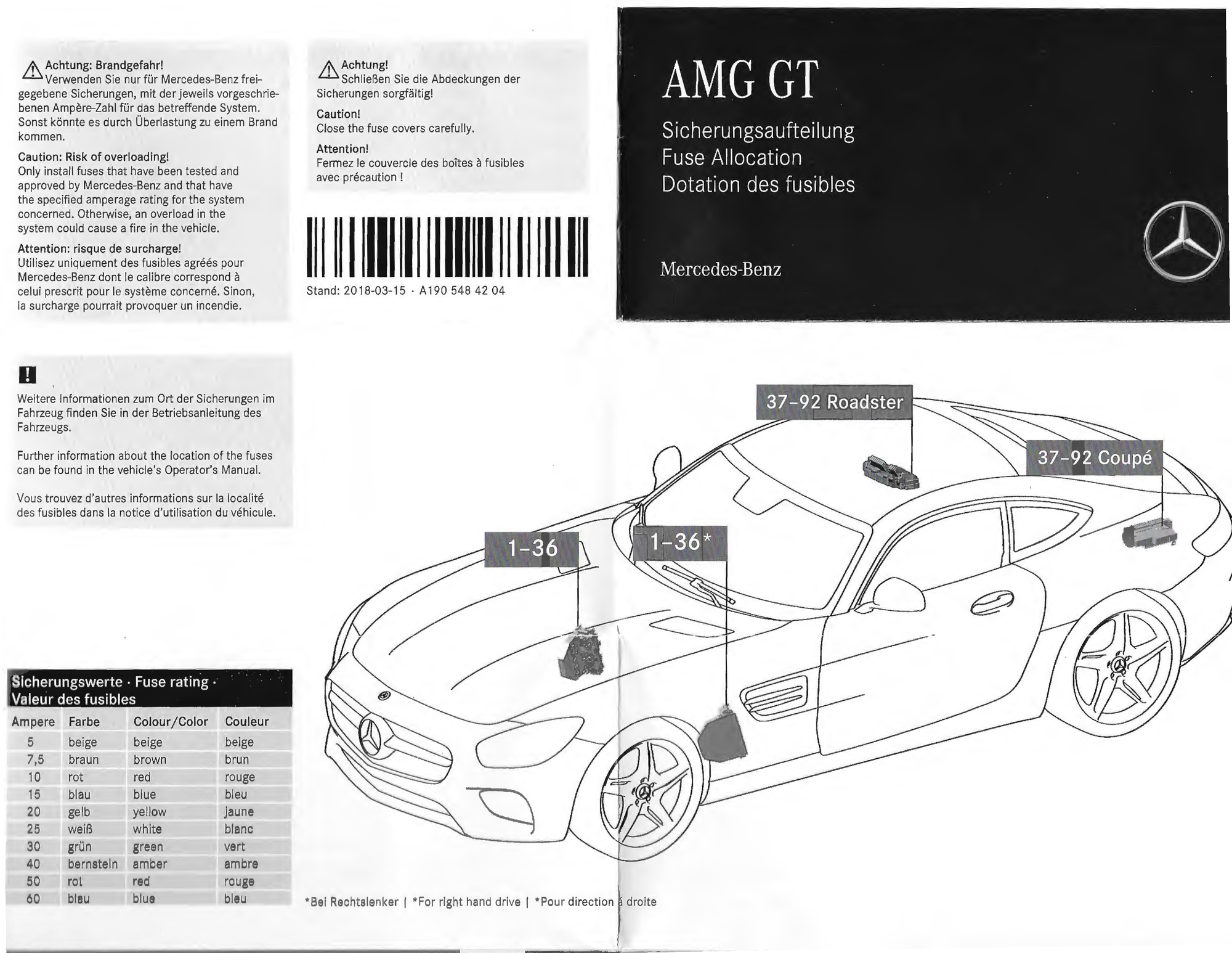

Here are one or two things you can look into if you are a DIY person:
There are no springs involved in the up/down movement of the front aero splitter. Instead, a motor is used to lift and lower the splitter via a short metal cable.
To diagnose the issue, start by checking the fuse panel in the trunk. Ensure that fuses 73, 75, 77, and 82 are intact, as one of these fuses supplies power to the front splitter.
AMG GT Class

If you checked that fuse 73,75,77, and 82 are all good, and did the controllers reset procedure, then I am afraid the rest is above my pay grade. Sorry, I could not help.
