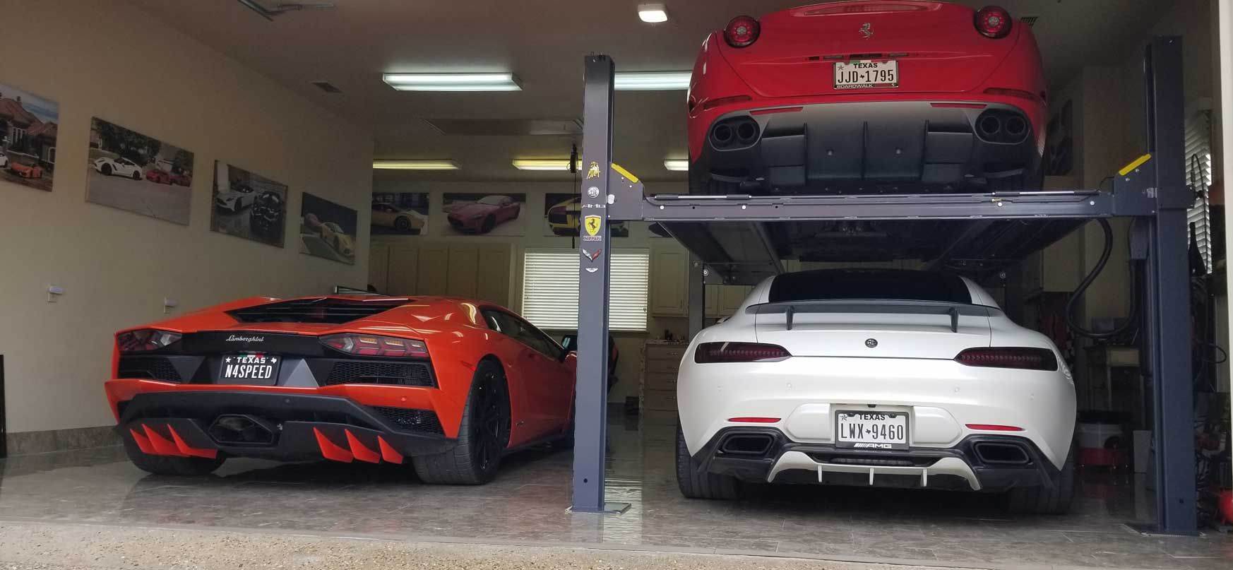

I am very happy! I can now park it in my man cave and admire my toys all in one place.

Quote: I am very happy! I can now park it in my man cave and admire my toys all in one place.
wow!!!! Thats quite the situation
if thats an 812 superfast youre the luckiest SOB on the planet in my book
Looks like a Cali T

Quote: Glad you finally have a resolution to your issue.
Looks like a Cali T
Thank you & you are correct the red car on top is a Cali T :-)
the GT looks so much taller than the Lambo .. width are similar.. only if the GT is lower, it do look really sick!
