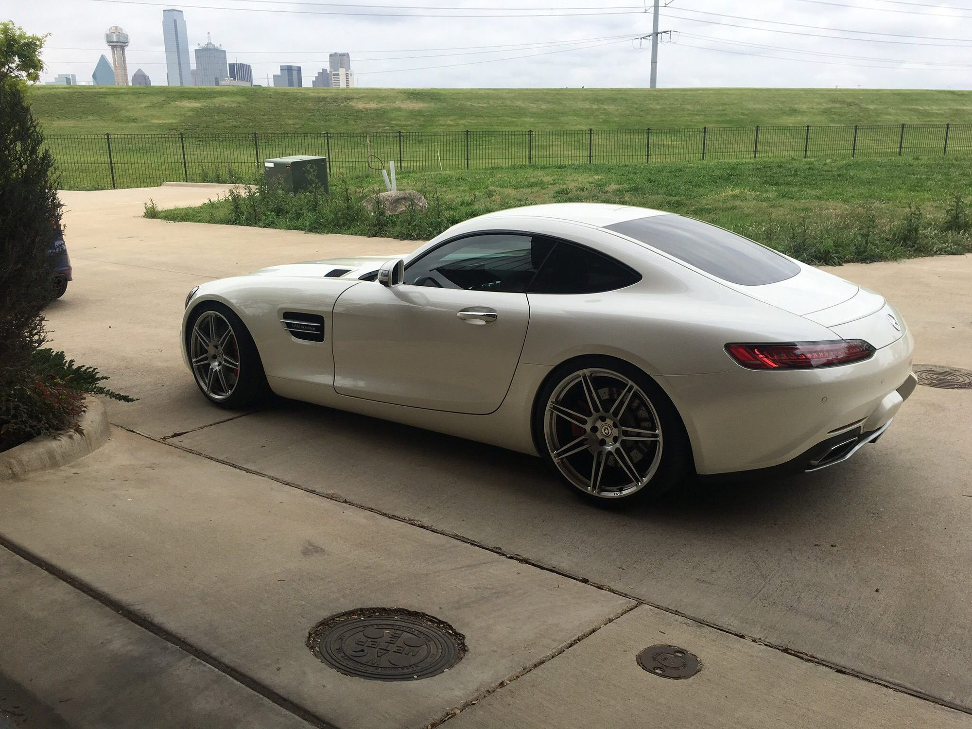

Designo White AMG GTS
I have the KW HAS and it is ever so slightly harsher than stock. The roads around me are absolute garbage and it doesn't bother me too much with the shocks on the softest setting. Still, the ride quality is my one small complaint with this car.
