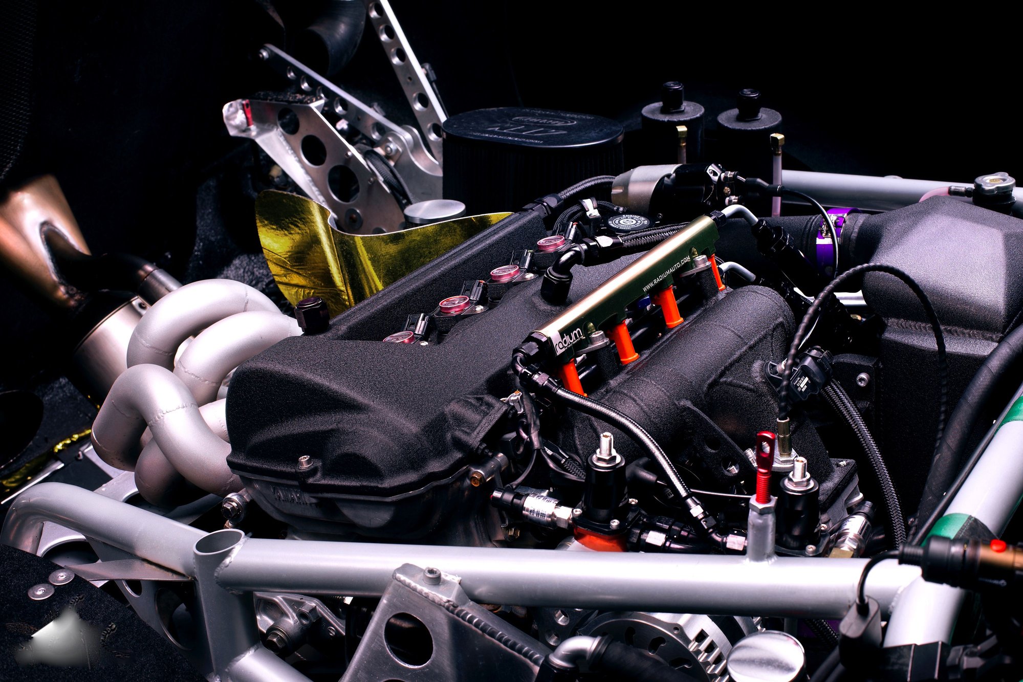

Here is my last little fun project and the proper application of a dual fuel system..Compound charged setup, supercharger and turbo..
91 octane primary fuel system [black fuel rail] and Isopropyl Alcohol [green fuel rail] secondary high boost system.
The alcohol system is tuned to replace the proper % of 91 octane as the boost level rose above 20 psi. to a daily 36 psi. peak.
Just 680 whp from a 1.8 ltr. Toyota 2ZZ engine. That's 680 whp all day long not some dyno queen poser.
Or I could talk about my old Group B rally cars and their engine modifications..
Here is the same dual fuel setup on a Turbo only setup same 1.8 ltr. Toyota 2ZZ engine 680 whp.
