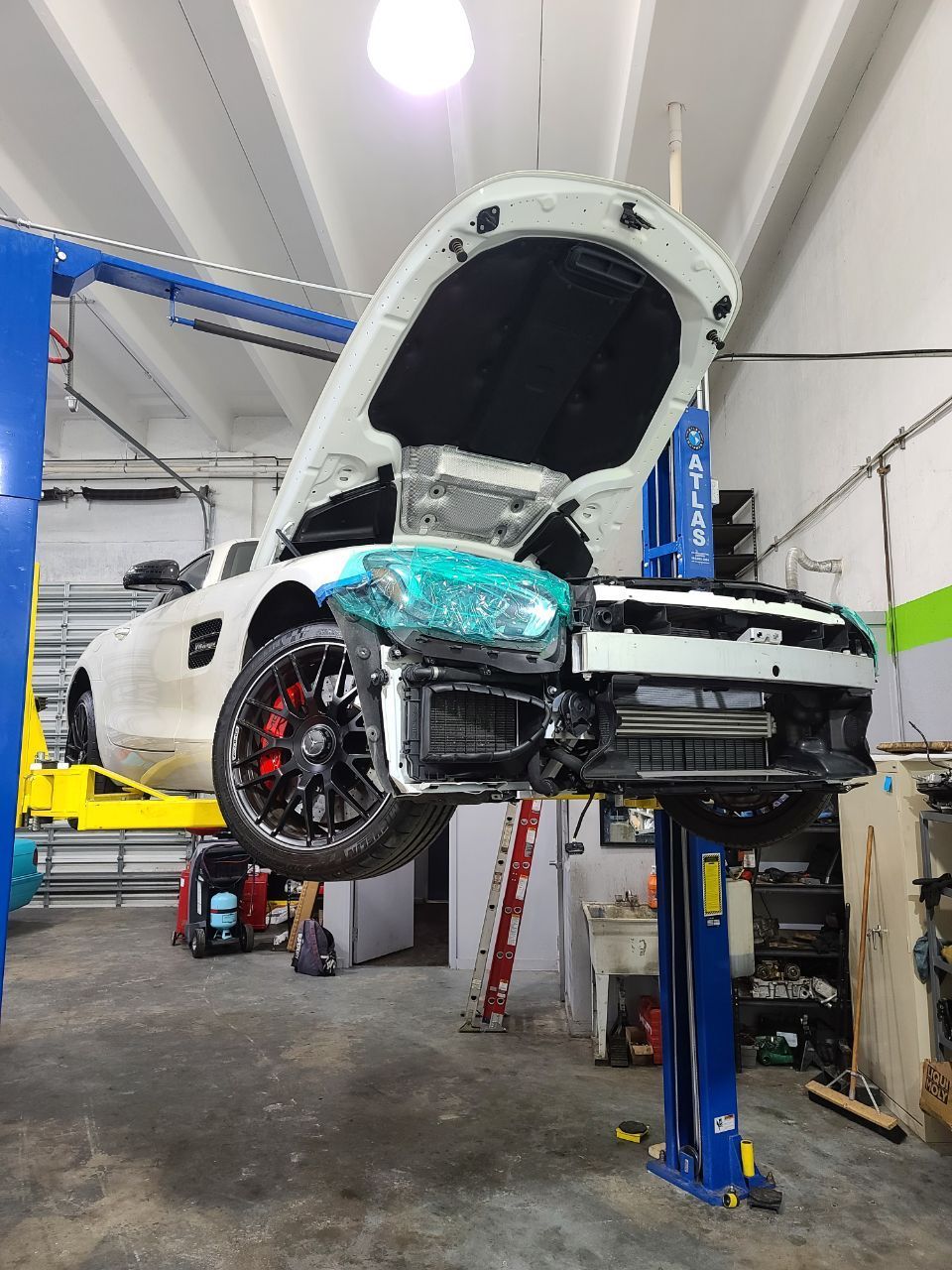

car is repaired. protection is installed and all radiators are cleaned out + new coolant. changing radiator is very hard for DIY because of the steering oil cooler in front of it, which ideally has to be removed. car runs fine now. no pumps had to be changed, although I did have error for them. after repair no trouble codes after 200 miles put.
that's the numbers for protection:
A0995030100 central radiator grille
A0995030200 x2 side intercooller protection for GTS 2016

Nice job !, I have same issue (twice now) the protection grilles are listed as for C series, did you need to mod or use as is ? Also did you need to remove the oil cooler to change out front radiator ?

No mod is needed, direct fit.
About the engine oil cooler, no, it will stay in place and it doesn't need to be removed. But the hydraulic steering oil cooler ideally needs to be removed. You can remove the radiator assembly without removing it but there are 2 bolts which are almost impossibly to reach.

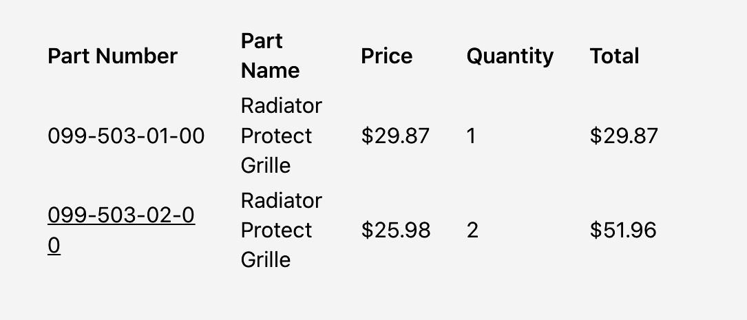

I just recently ordered, received and fitted these part numbers and can confirm they do work (2016 GTS) It seems every dealer offers a different price (completely ignoring the MB MSRP) so i ordered on line from an out of state dealer at significant discount.
copy of invoice would be great. I’m going to dealer today

Radiator Protection invoice

Ty. Exactly. <100$.
I went over to dealer this morning and he’s still claiming there’s six parts that are needed and now it’s $400 for the parts and 500 for the install. So I caved in and called Mercedes-Benz customer service and put a claim in. Supposed to hear back in 24.
On the dealer floor, There is a GTR convertible and a pro both with the covers obviously.

Short version of story is Grills installed and MB also gave me 450$ credit for future service and parts, so it was a virtual wash. Your mileage may vary.
The original 3 part numbers WERE CORRECT.
