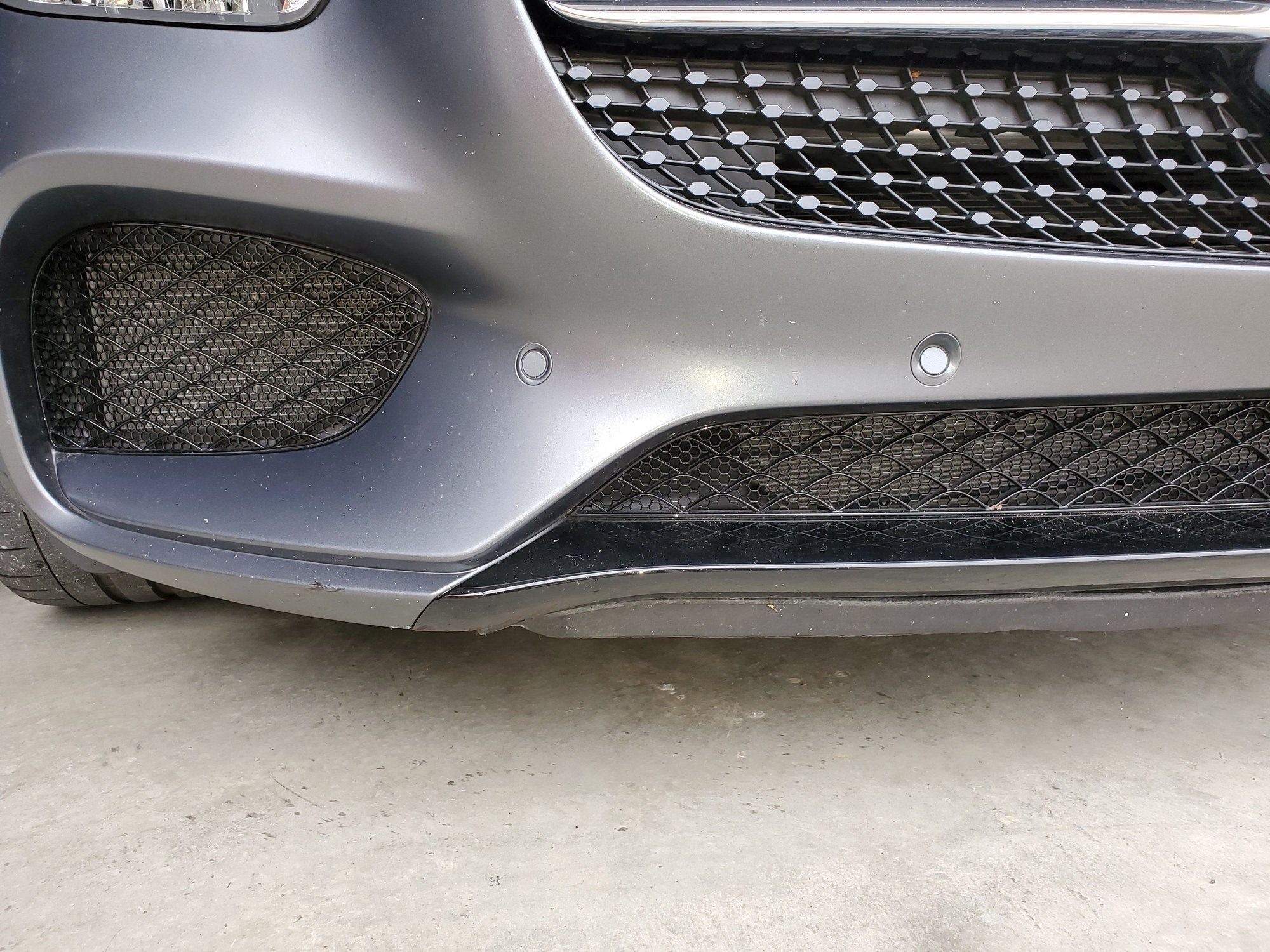

I made my own protection, for this exact reason.
https://mbworld.org/forums/coupe-roa...pic-heavy.html
wow this looks good. I did also order the mesh and will be installing it soon. Is it hard to remove the bumper?
No, it was pretty straight forward. Taking the front wheels off will make it a lot easier though.
I used Alex's thread for reference:
https://mbworld.org/forums/coupe-roa...nt-bumper.html

DIY-Ing this would be tough, at least not without the shop manual.
It's not, took me less than two hours.
